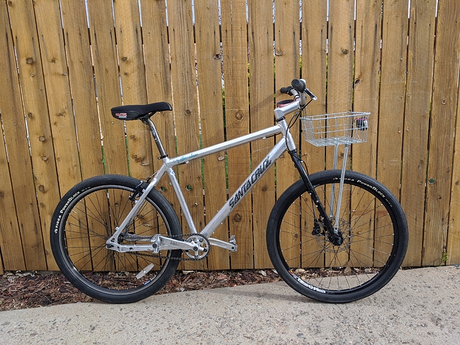

Took it off of there, put it on the sad chameleon and now I love it. Spent some time shortening the stays for the basket even. Dunno if cheap 26 disc Dyno wheels are a thing.
You can definitely build one on the cheap. There is a new Shimano jammer with a solid axle for cheap as heck. Works fine.

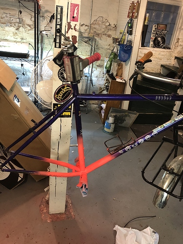

Scraped, brushed, sanded and painted the rusty ass on my former xtra soon to be clyde.
Clearly, I did a very slipshod job of it.
aw buddy what u doin
Putting some paint on an old bike that was all rusty so it doesn’t stay rusty. And also painting over that jacked up slap guard. Whatever. I ain’t an artiste.
