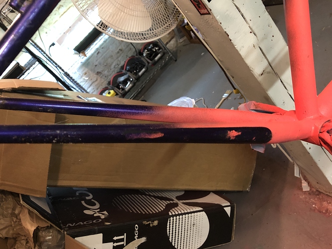

Camarata paint job for maintenance

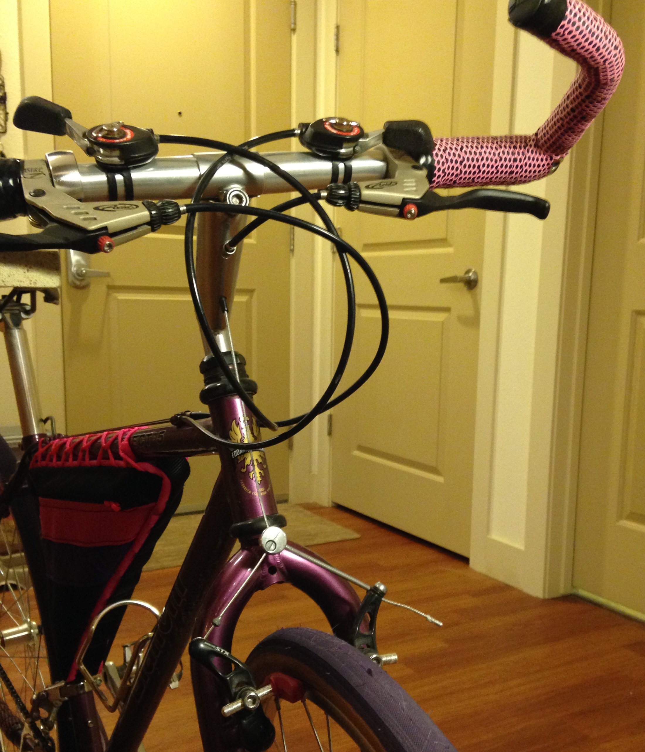

Also included a bonus pic of my crowning achievement: the shortest front brake housing ever
Nice, shoulda just used a v brake noodle dood

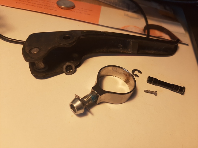

Just for practice I gutted my sram red 10spd left shifter to compare giblets with the hydro rival ones I have for my OPEN. All parts appear identical except the paddle. Rival is smaller but heavier. Obviously not made for pulling apart, but it all came back together well. Hopefully will install into the Hydro force tomoz and cure it of it’s pathetic 1x-ways.
Nice to know the 1x shifter can be modified to run a dropper in this case, without being misleading
Anyone know if the right hand 10sp shifters can run 11sp guts? The S700 shifters seems to be the weird official hybrid product
That would be interesting to know. I’m looking forward to seeing how installing into the hydro body goes, cos it’s all about skewering it all on the central pin, it hopefully will be easy to access because obviously there is nothing in there and I should be able to grab the pin with some pliers. I’m not sure how that would go if I was trying to replace existing internals, as they would be covering the pin, and access could only come from the front, which would be behind all the hydro shizzle, and be a major pain in the arse. Pushing the pin out from the front on the 10 sp version is doable but tricky as fuck.
