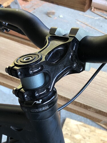

Threw the new stem in the fuck around bike and trimmed the steerer in the new old fork, assembled it, marked it and began to cut it conservatively with room for some spacers. Somehow missed the mark by a full cm. Stem and all fits with about 2.5mm of clearance for a top cap. Well, okay then.
Arbitrarily picked a Renthal stem because that’s what the kids seem to be into these days. It’s amazingly light for as burly as it is.

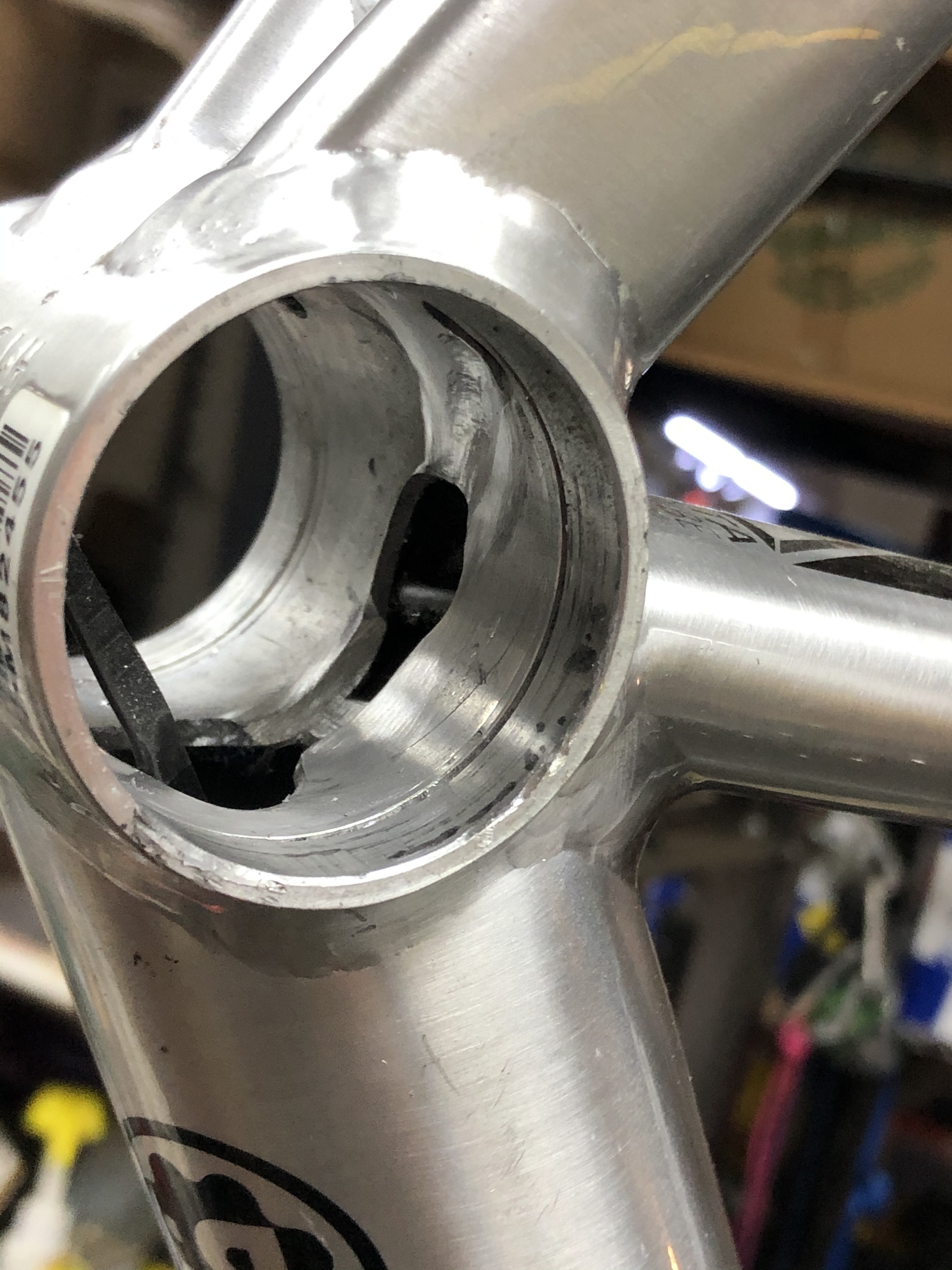

Feeling optimistic, I pulled the cranks and the creaking bottom bracket. Cleaned it all up and took a die grinder to the inside to make clearance for internally routed Di2 wires so I can install the one-piece Hambini jawn.
Probably gonna explode and kill me at some point.

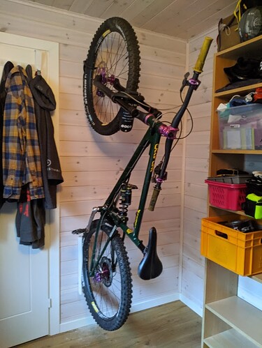

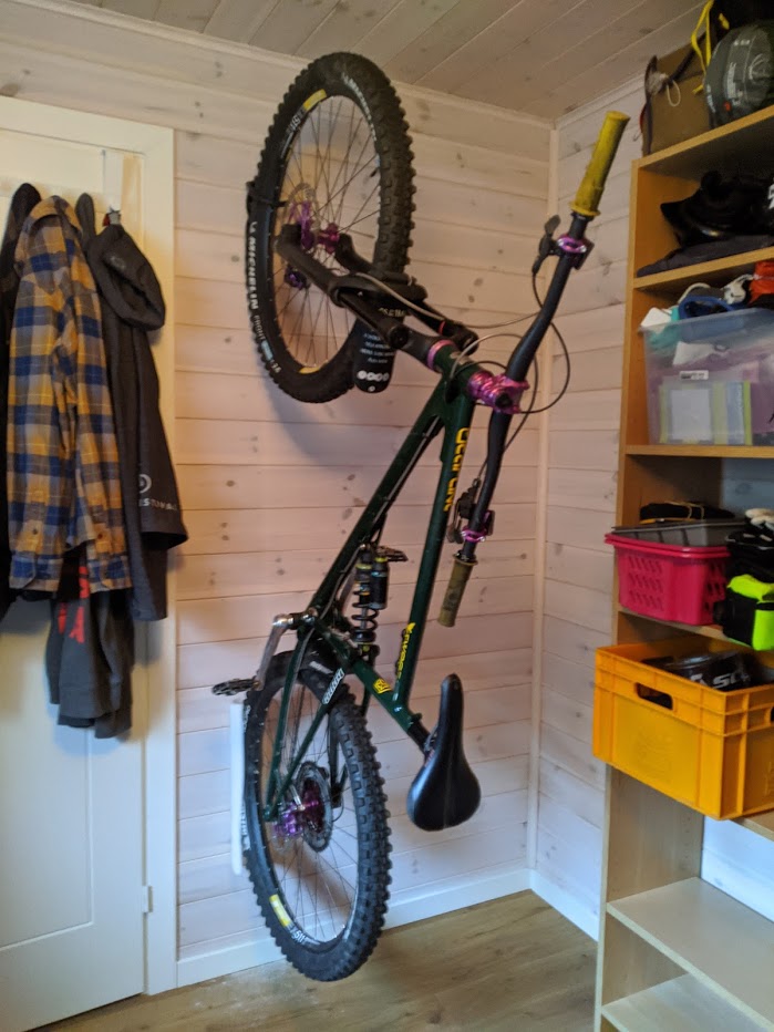

I hung it on a wall.

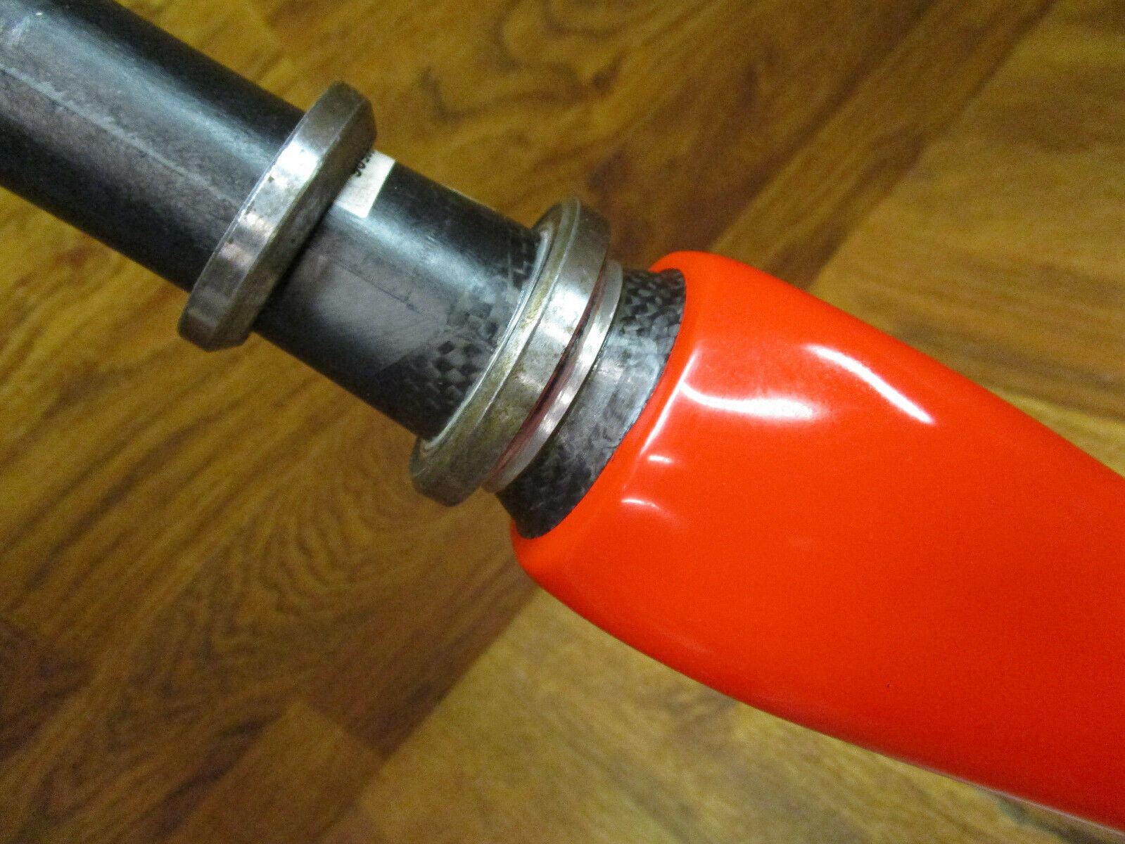

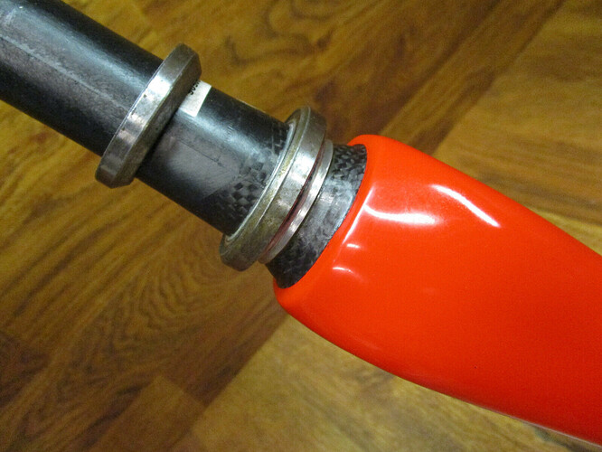

Gah I went to put 12x100 new fork on old qr Specialized Crux and discovered that it had this situation:
Some Specialized nonsense where the crown race sits a cm-ish above where it should, making it so new fork rubs on frame. I guess I gotta get a new frame now. :man_shrugging:
The fucked up part is I vaguely remember pulling the fork and seeing this like 5+ years ago. But then I forgot and thought I could just throw a normal fork on there.

i’m confused by this pic. that fork looks like it has an integrated crown race but it also looks a little tall. are you trying to set a separate crown race on the fork?
Specialized has a real knack for making frames and forks that don’t go together with any other frames or forks. I don’t own any Big S but it makes me mad. Worked on a buddy’s jiggle fork setup, and just wow.
That’s a pic from eBay of a similar Specialized fork. I’m not sure exactly which part you’re saying is the integrated crown race.
You see how there’s like a cm of carbon between the shoulder of the fork and where the crown race is sitting? That’s making it so the crown race rides higher than on a normal fork. And the frame is built to accommodate this.
The carbon above the paint line and below the metal crown race looks like your typical integrated crown race.
In this bikes instance perhaps, it is not.
Hat off special eyes’d!
The carbon is not acting as an integrated crown race in this instance. It’s supporting a regular thin aluminum crown race that the bearing sits on.
not sure what it looks like under the metal crown race in that pic, but a lot of carbon forks have an integrated crown race- that is, the crown race is made of carbon and integral to the fork
edit: you posted like a second before me. unless the actual bearing seat in the intended bike’s head tube is super recessed, my guess would be that tapered carbon section is supposed to mate directly with the headset lower bearing. otherwise it would stick out really far etc.
what size is the current headset?
Here’s a weightweenies thread that maybe explains it:
The guy was able to get an adapter from SpecialiEd years ago. Probably no longer supported. I might check at my old shop this week and see if i can look at the Spec small parts page
Edit: bought this, guess I can stop planning how I need to spend a couple bongs to solve this problem:
https://www.amaincycling.com/specialized-1.5-lower-bearing-adapter-for-nonspecialized-forks-s092500004/p747440

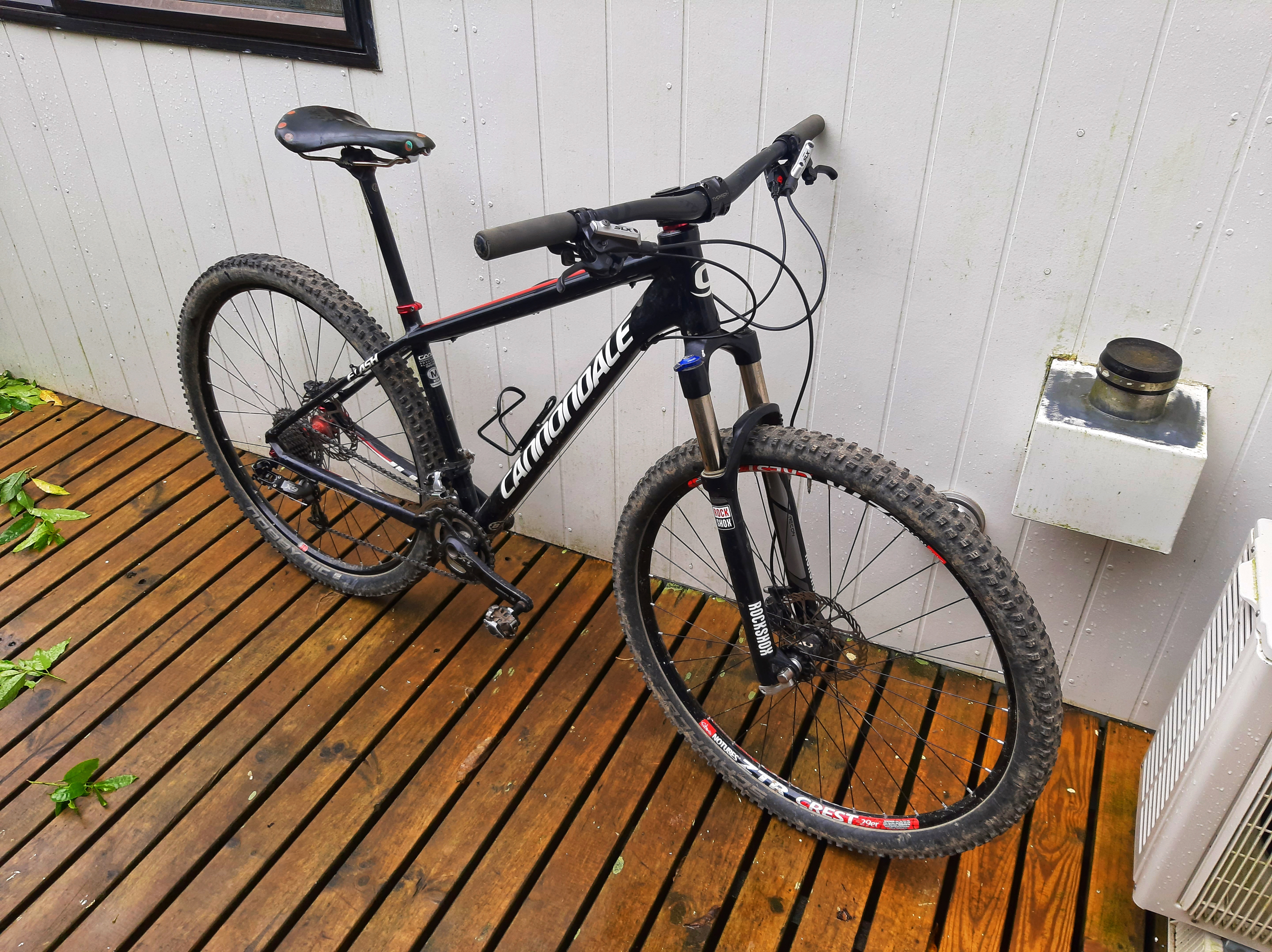

Spent the afternoon swapping out the front end from my Tallboy onto the Flash. Then found the Fox steerer was too short. Found an old Rockshox Recon to put on. Panicked thinking I had no QR wheel so converted a 15mm TA wheel to QR with two sleeves before realizing I did have a QR wheel. Dork. Swapped over the disc brakes and rear X9 10 speed derailleur too. Took it for a 5 hour ride in a gale today. Worst wind I’ve ridden in. Rear derailleur kept locking forward so riding in the big ring was the only thing that stopped it. A bit tall in places. Position is very upright so will probably put on a longer stem so I can use bar ends and aeros to give me more hand positions. Probably will put on a less wide more flatter bar. Annoyed at the lack of frame triangle for my frame bag, but at the same time happy that it will still fit the same one I had on my Karate Monkey and XTC. I might look for something that I can mount in front of the seat post. Been trialling the Spez power saddle, and while it’s pretty good, I can’t see it replacing the B-17 for me, it feels so damn good.
that is some grade A dithering all in a day
I keep looking at the drop bars with the bb7s hanging off them and I really want to put them on the Tallboy…
