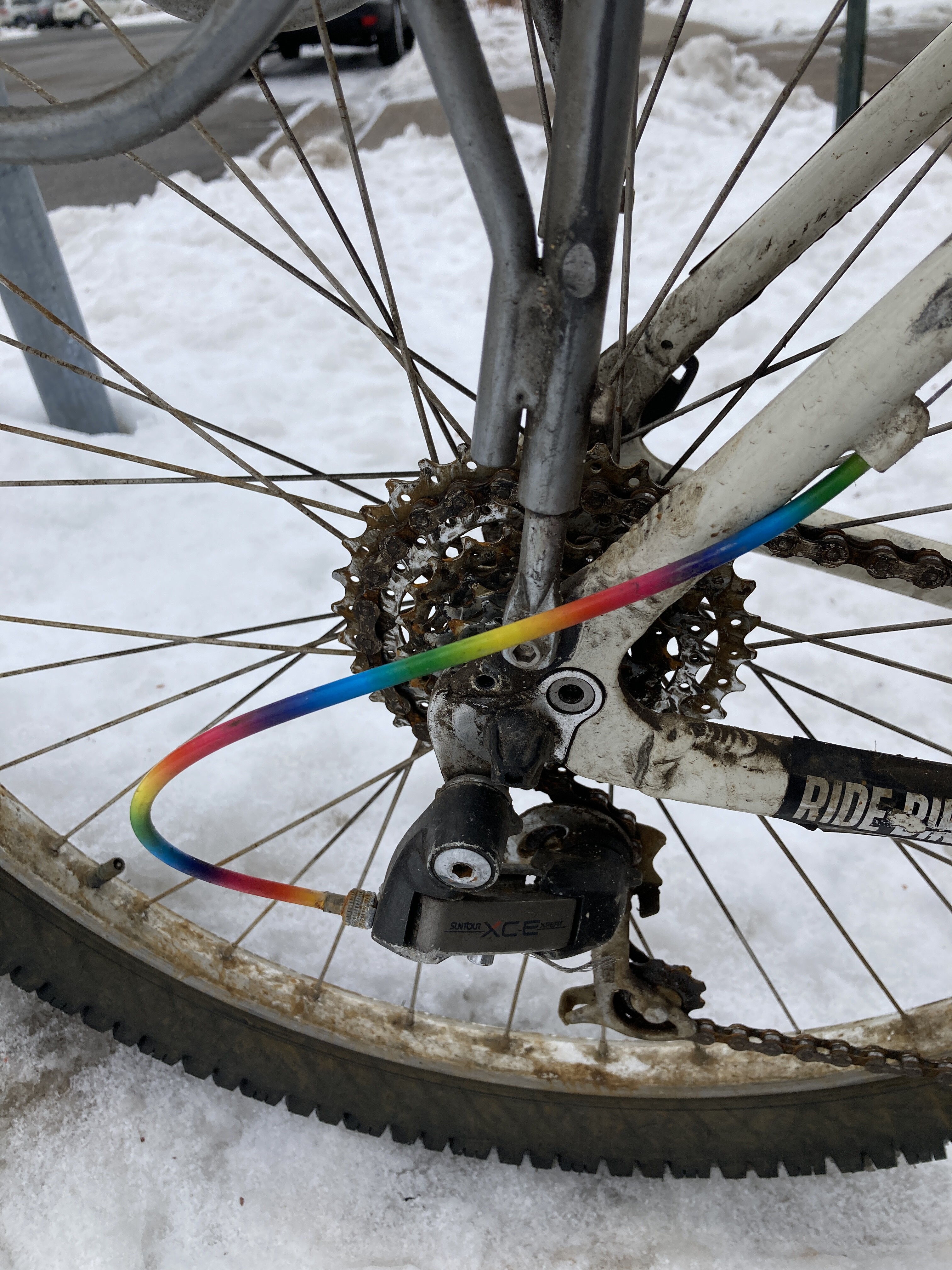

Riding home, the ancient dangler wouldn’t downshift, too corroded gunked. Also the rear v-brakes are salt-fucked and seized so I’m riding them unhooked like a serious fuckup.
So on top of trying to stay upright while navigating gnarly rippled chunky ice, I’m trying to feather the front wheel down hills so I don’t wipe by braking too hard AND I’m kicking the dangler to get it to downshift.
This bike is a physical manifestation of my mental health and general well being.
I just replaced my chain and cassette after 9 months of fuckery. I think my chainrings aren’t too sharktoothed, and my dangler isn’t too fucked, and I just replaced the shifter, but who knows.
The sea spray does a number on everything.
