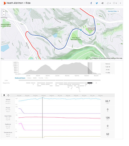

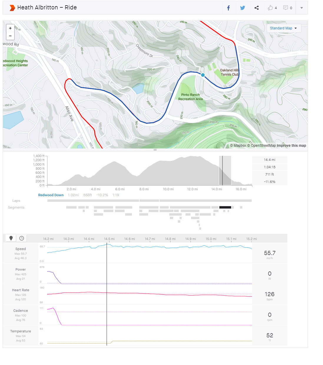

Jesus, if I tried to ride down that road at 50mph I’d be dead.
Back when I rode my single speed all over Seattle, there was a hill (naturally) that led to the bike route out of west seattle. One day while going home from west seattle I was bombing the hill when I heard a moto behind me so I shaded right so they could pass. Instead of passing they placed me and at the red light at the bottom pulled up, gave me a big thumbs up and said “45 miles an hour!” then took their free right.
Point being for a person of substance it doesn’t take much hill to hit 50.
