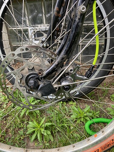

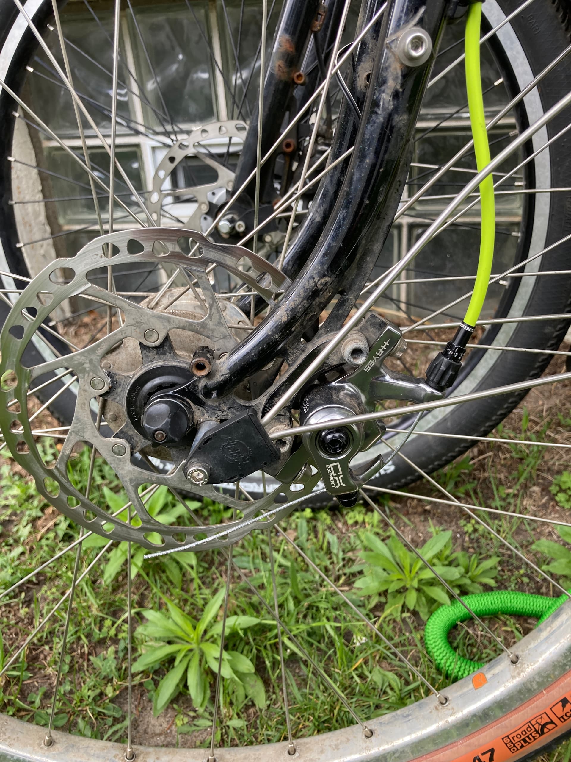

Trued the rotor and moved the inner pad in a couple of clicks on this guy
Front brake feels better. But why does this exist

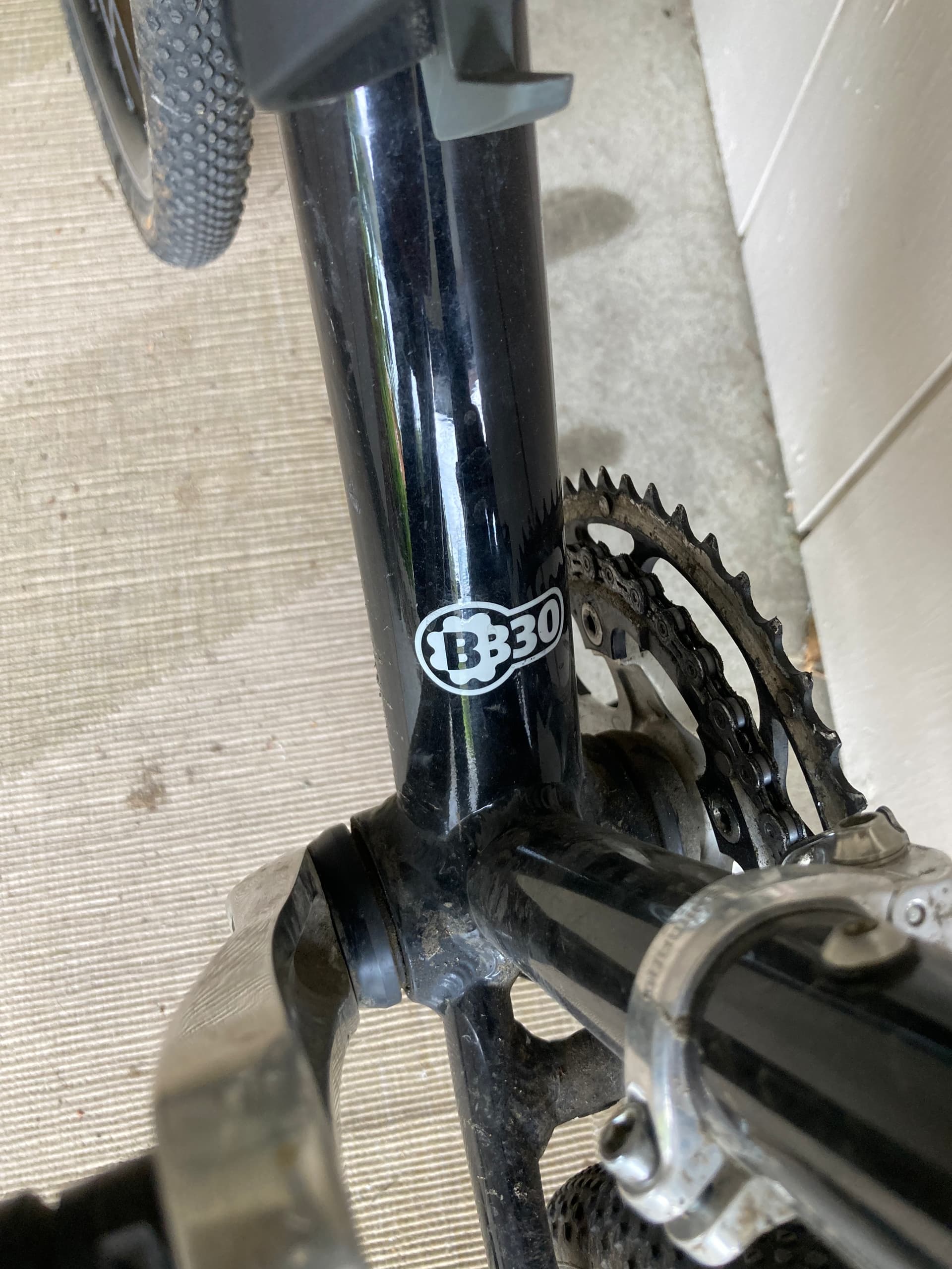

Rechecked the crank on the Lorry after getting a similar but different feeling on the ride home. Pulled the arms to check the cups, which werenât tight but not real loose either. Tightened the cups, reinstalled the arms, and the play at the spindle is still there. Back to shopping replacement BBs. Gonna yolo in the meanwhile as long as one of the arms doesnât fall off.
Pretty
about that BB lasting only 194 miles.

Dropped off the Jones to have the rear brake mounts faced. Itâs been an issue since day one, but I didnât feel like sending the frame back to Jones building up the bike.
Update: sub-24-hour turnaround; IS tabs and IS-to-Post adapter both faced (and rotor trued).
