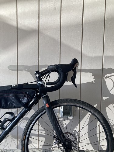

I finally decided to try a wider set of drop bars having only used 42cm Salsa Cowbell 3s for a looong time. I found these 44cm Bontrager jawns at Recycled Cycles for $25 and thought the shape looked interesting
Going to take them for a spin tomorrow
