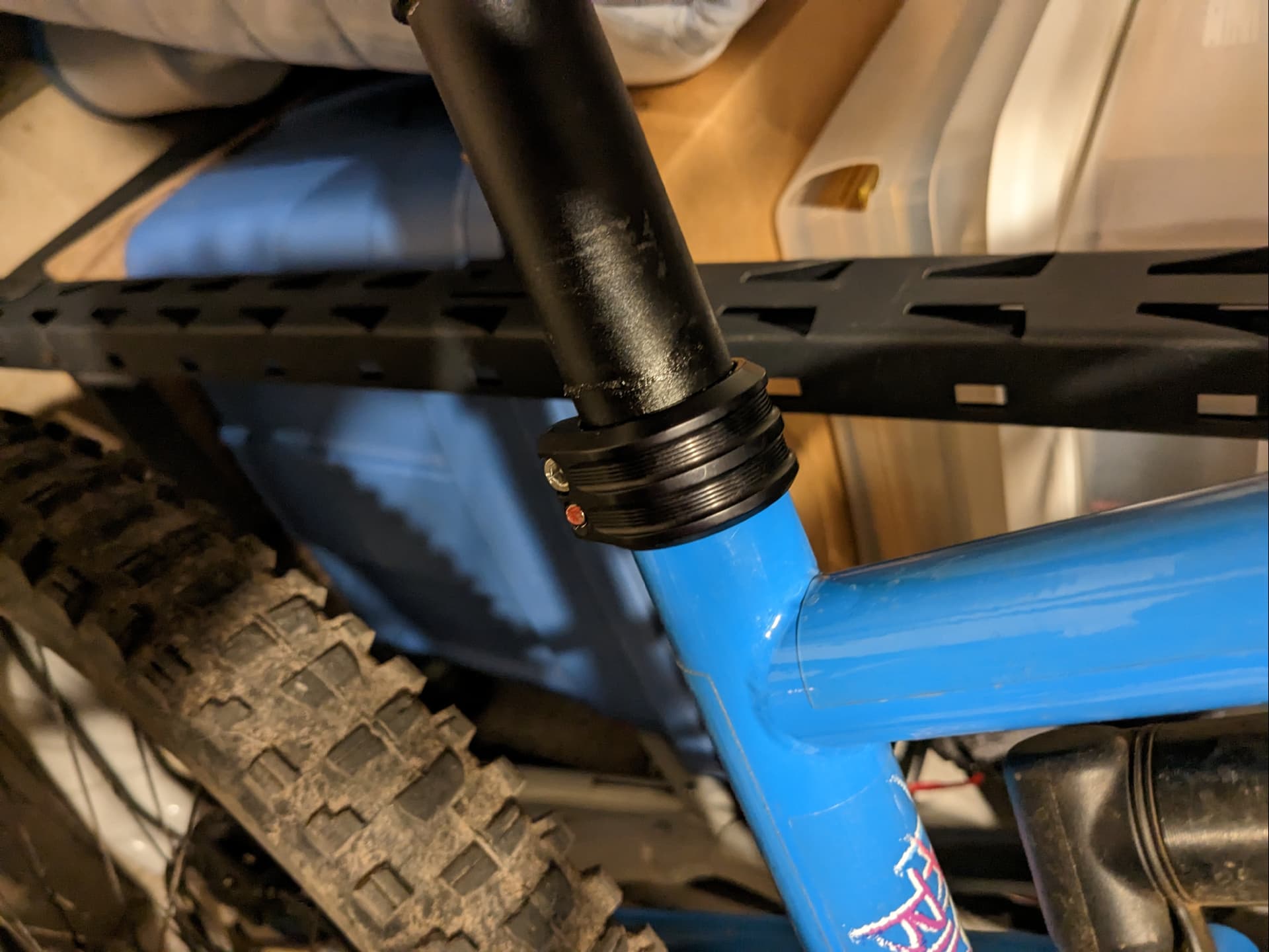

I installed an Engin two-bolt seat clamp to hopefully alleviate the slipping chairpole/sticky dropper return. I could find some cheaper ones on rainforest, but they were for 31.8 chairpoles not the 30.8 I have.
Clamping it at 5 Nm meant the dropper stuck in two spots. I dialed it back to 3 Nm before the return was normal. I need to spend some time in the saddle to see if it’ll slip now.
If this doesn’t do it, I’ll have to get a different dropper.

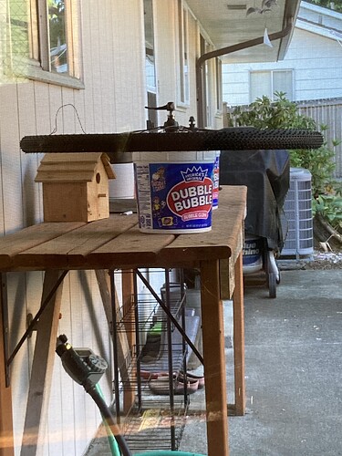

Installed the new 700x40 Conti Terraspeeds, the rear fits in my Raleigh RX which I was stoked about and the bead set up nicely with a floor pump. The front required a trip to work for the compressor, now both wheels are chilling on giant Dubble Bubble containers.
Did you try the carbon paste? That stuff solved my slipping/sticking chairpole issue.
Yeah, I use the Finish Line stuff on all my posts. I got in the habit with my Soma. The clamp on that frame was awful.
This is the second frame I’ve had this same dropper be sticky with. The two-bolt clamp was the less expensive fix
What brand dropper is it?
It’s a Fox Transfer rebranded as Race Face.
I’ve found other people with the same issue. Reducing the clamp torque is really the only fix. I wonder if it’s the smaller diameter of the 30.8 that causes the issue.
my wife’s fox transfer does the same shit, it’s really fucking annoying.
we actually spun the seat clamp around and installed the post backwards which helped a lot, as well as using a surly constricteur clamp
i have the exact same one and it’s fine, i really don’t get it.

The two-bolt method seems to be a winner. I did a fairly chill fundraiser shuttle day yesterday. The post didn’t slip at all. Compared to the previous weekend, that is a win.

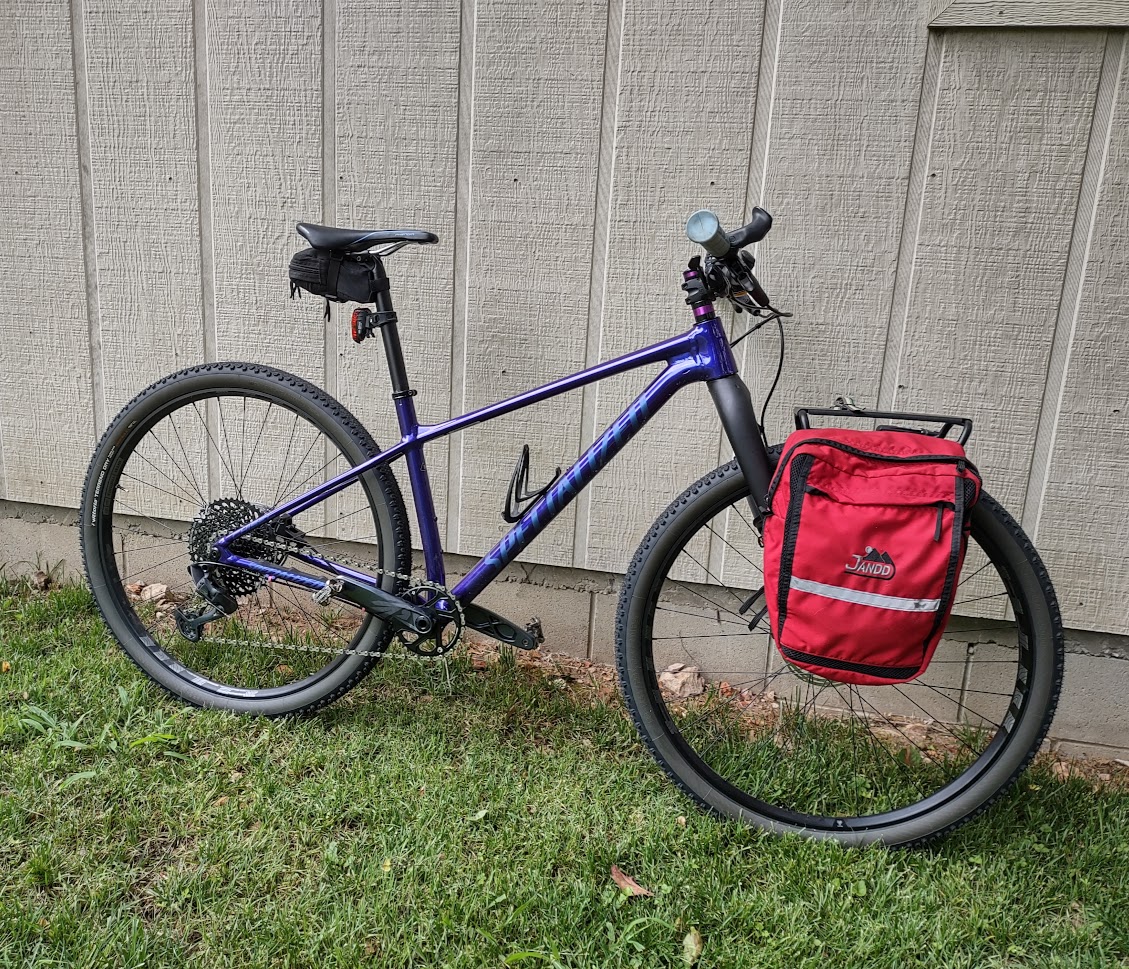

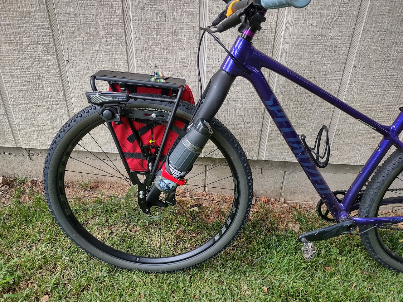

Dithered with the commutepacker. Futzed around with the OMM rack, this thing is sturdy as hell. Swapped out the chainring from a 32 to a 36 beacuse most of this things miles are going to be on greenway trail TBH.

Is that a chisel frame
nm…answered my own question. looks like a limited edition
