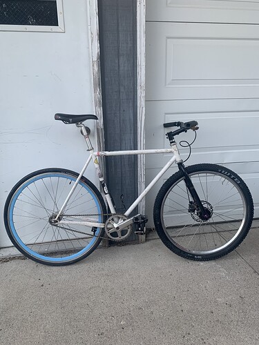

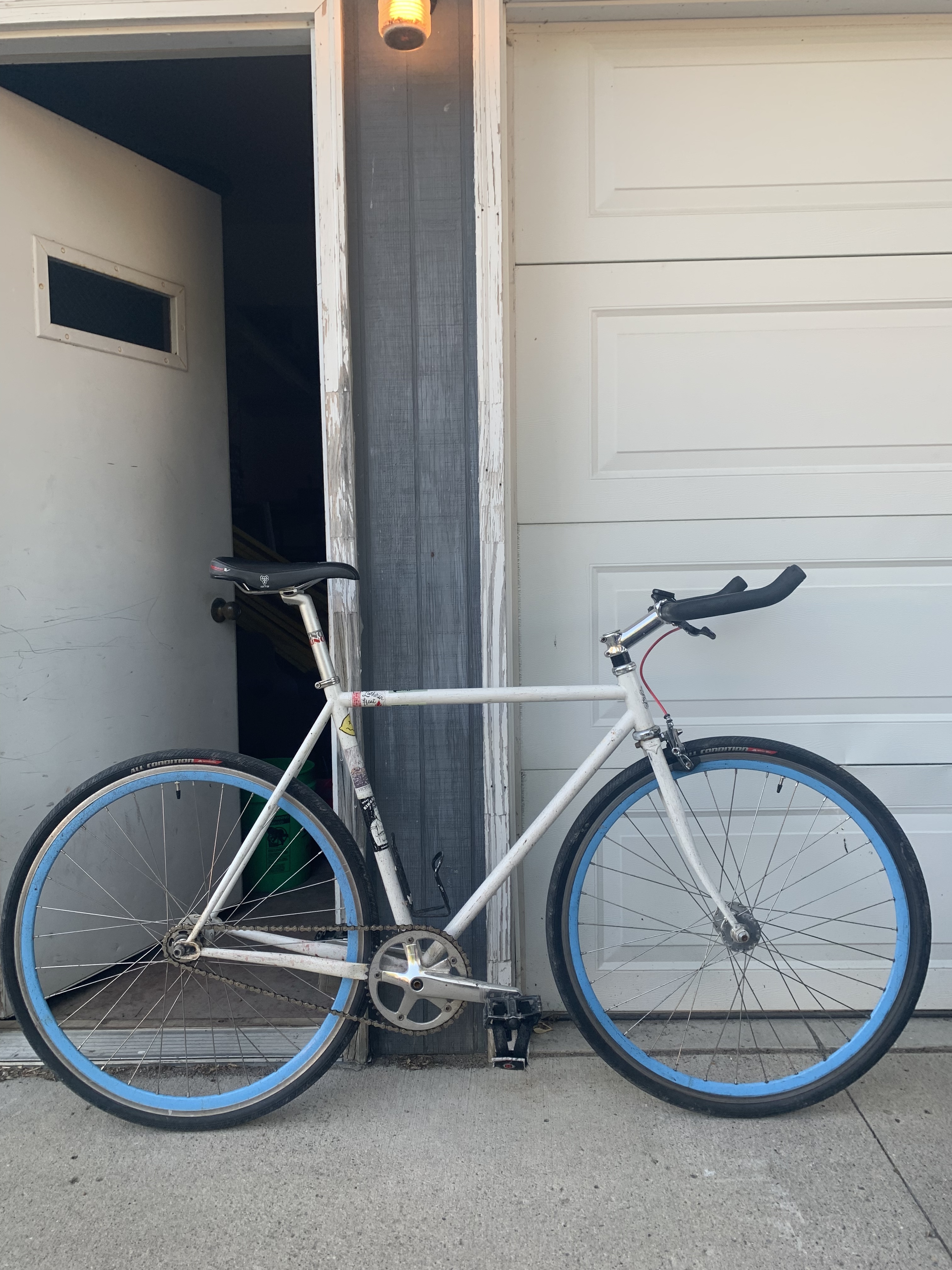

Tried to make my roommates bike hesh AF. Here’s the before and after.
HY: this fork works great on that frame
WTF: Headset is exploded and rear wheel won’t budge. Letting the shop deal with it currently.

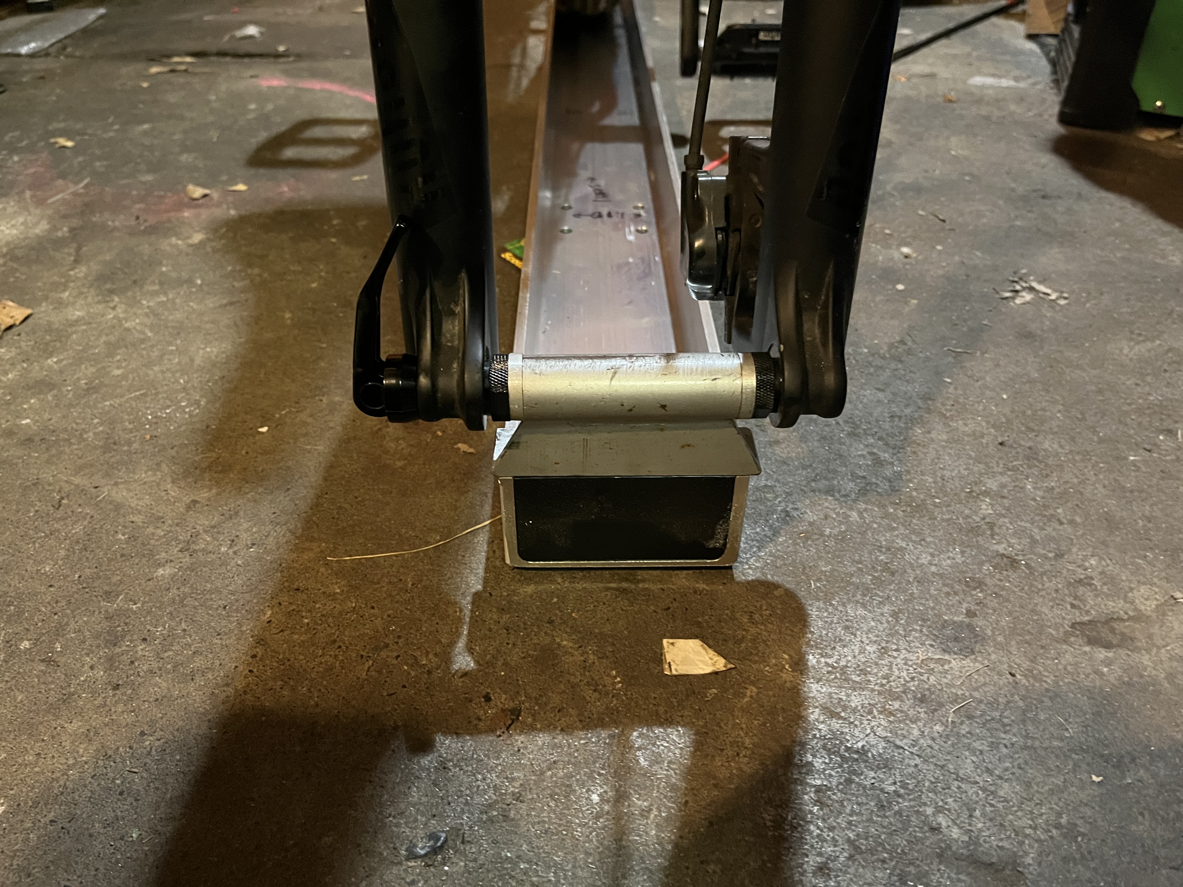

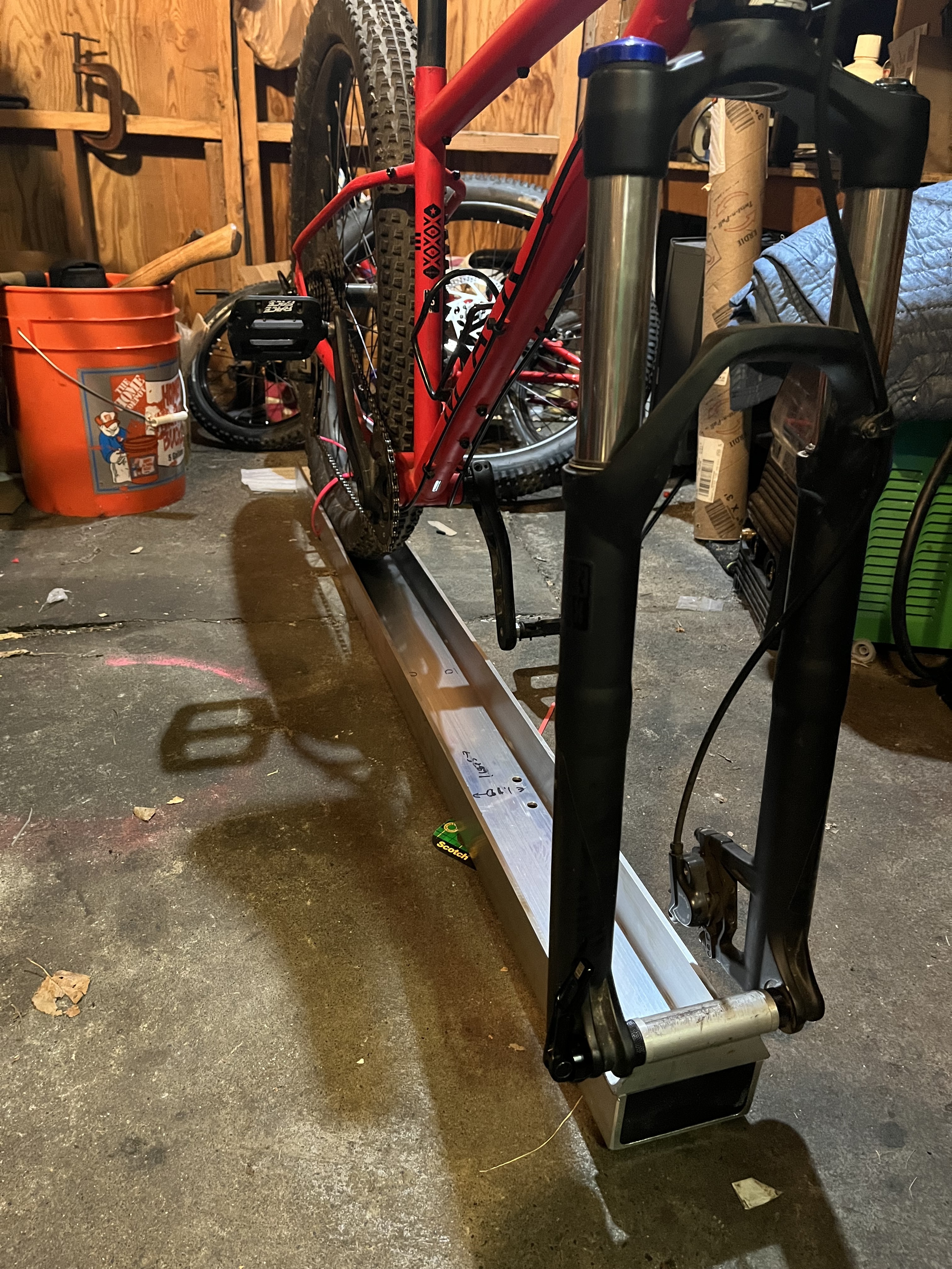

Crosscheck related but I built a roof tray for the wife’s mtb with 3.5” tires. I fork mounted it with a truck bed mount I had but wasn’t using. I used some aluminum channel from McMaster that had just over 3.5” inner width. Spaced the bed mount above the top since it was too wide and I didn’t want to chop it since I might use it again on something else later. Drilled mounting holes to attach to the rails using square u bolts. Had the foresight to slot one set of holes in case I was a little bit off or we move the cross bars. I’m gonna mount some D-rings for strapping down the rear wheel. I had to turn a couple spacers because while the bed mount has qr/12mm/15mm adapters the 12mm adapters weren’t wide enough. Anyway it’s late and I’m sure I could make this a little nicer later but we need it for our trip up to whistler this weekend. Crappy late night bike test for photos.

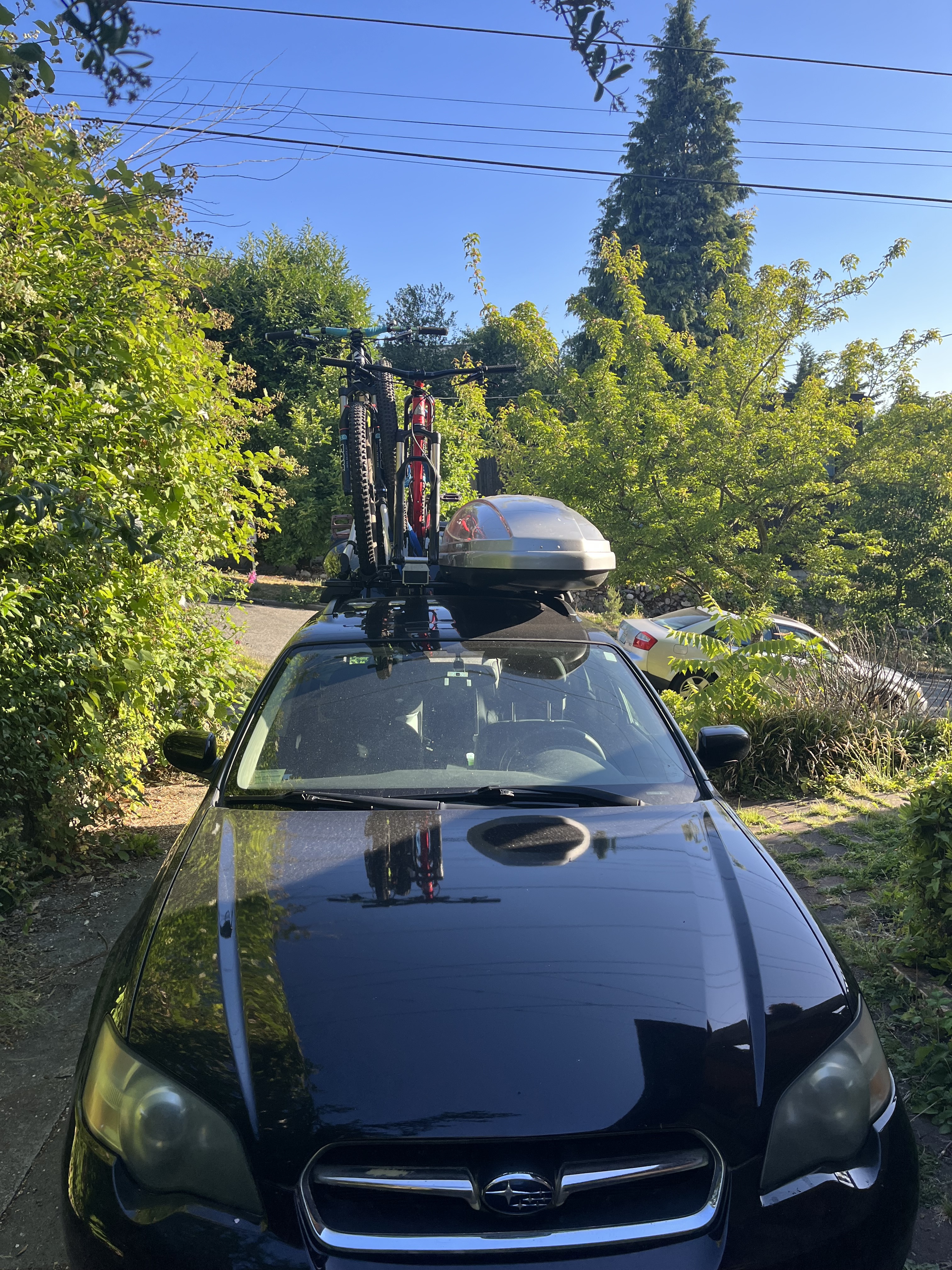

They got put on the roof rack for our trip. Two kids bikes,helmets and shoes in the roof box. Bike trailer in the trunk. Hi nice to meet you my name is Mr. Griswald.

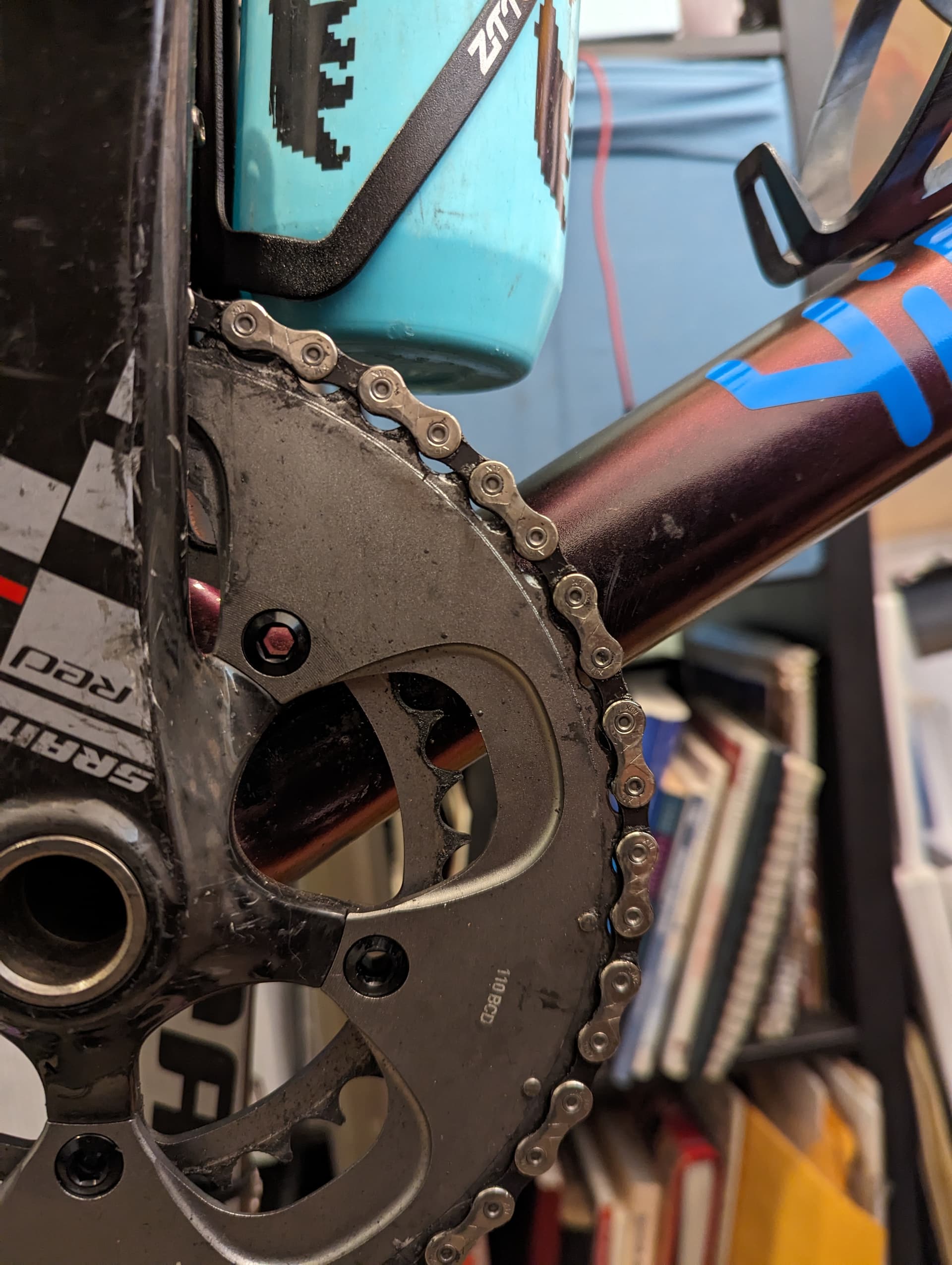

Fiddling around today. Does this look like the chainring is worn out? Chain doesn’t fully seat until it’s around the bottom of the chainring
the pitch of your chain and chainring no longer match. did you recently replace your chain?
nope, I did recently fall off the bike and something has felt off with my shifting since then
I’m running KMC chain. I can’t say I noticed this before or maybe I was never looking this hard at it
Chain stretch?
One of the two is smoked. Post a pic of the ring and mesure the chain.

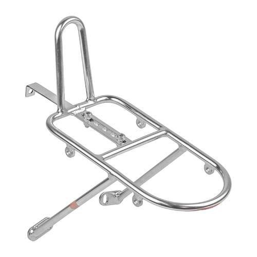

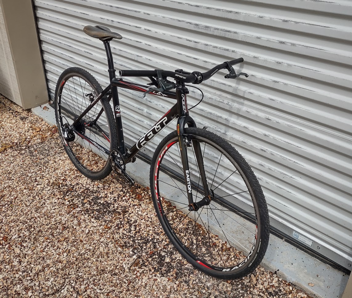

What did I do to my SO’s crosscheck today? Started converting her old race bike into a beater/casual/bar biek. Was strangely satisfying swapping out campy 10 for Altus 8 speed stuffs. What Wald basket does this need for purse schlepping and maybe an occasional sixer?
137 but your fork is gonna limit your rack options
chop up disc adaptor to turn into 90 degree bolt hole re-orienter, chop up wald struts, bobs your second uncle twice removed
Guess one of these + a basket + a buncha zip ties would do the trick, but that’s a little pricy for this endeavor. FWIW the fork has a hole at the crown and fender eyelets.
Oh, for some reason I just assumed there was no hole in the crown.
In that case pretty much any canti mount rack is gonna work. Grab a black Sunlite and never think about it again.
