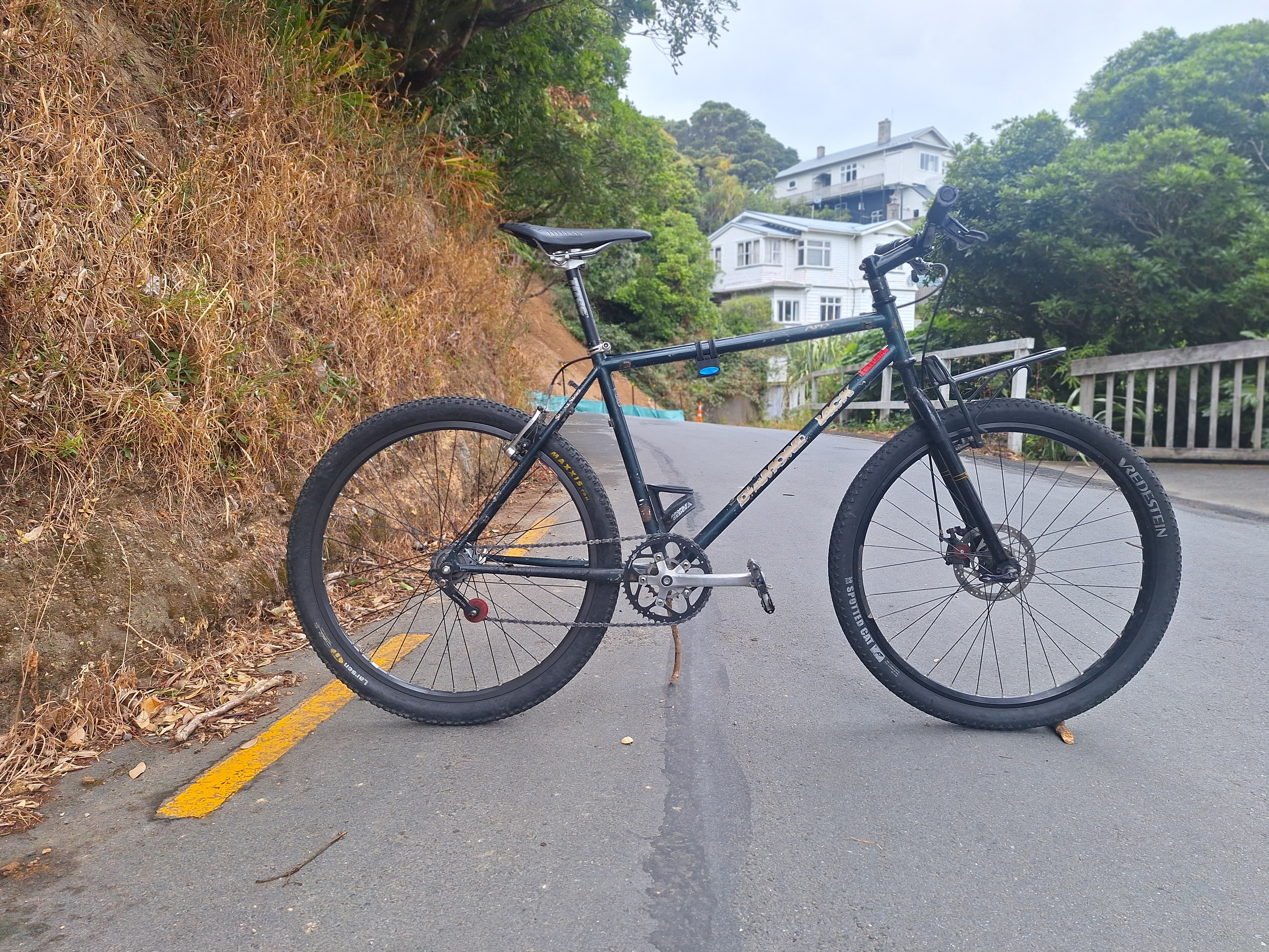

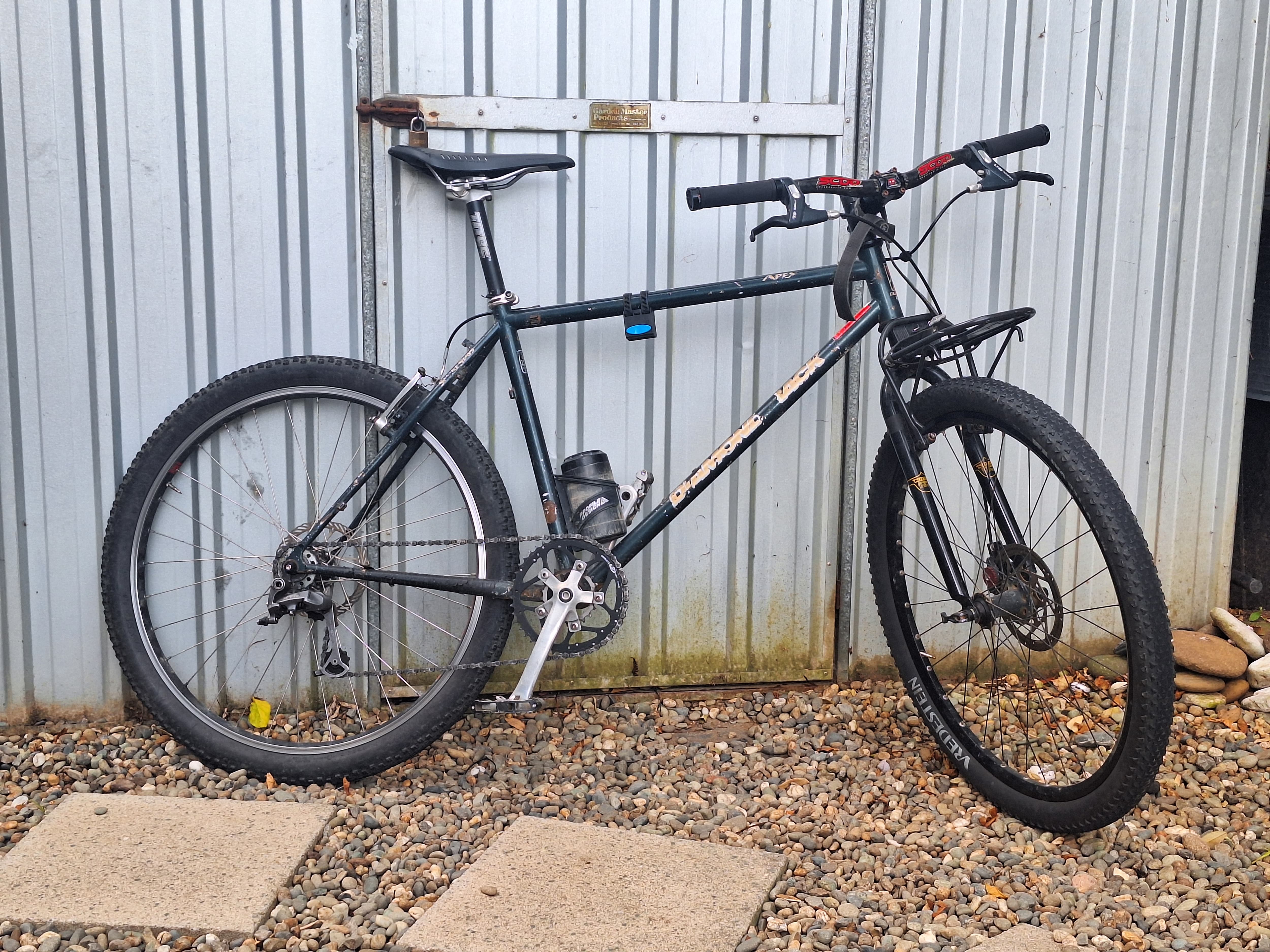

Last night i took off the front screeching V brake and stuck on a disc. Commuted well on it today. Should get the drops on it tonight. Not sure which ones I’ll use. Maybe the Beacons. Ive 5 sets to chose from.
What a dick. My levers were the canti pull, not the V. Had a bb7 road pull brake that it worked well with but that means I need to put xtr cantis on the back. Not sure i can be arsed. Probably just change it back to v-brake spec with mtb levers. Sucko. Position with the Beacon bar felt good too.

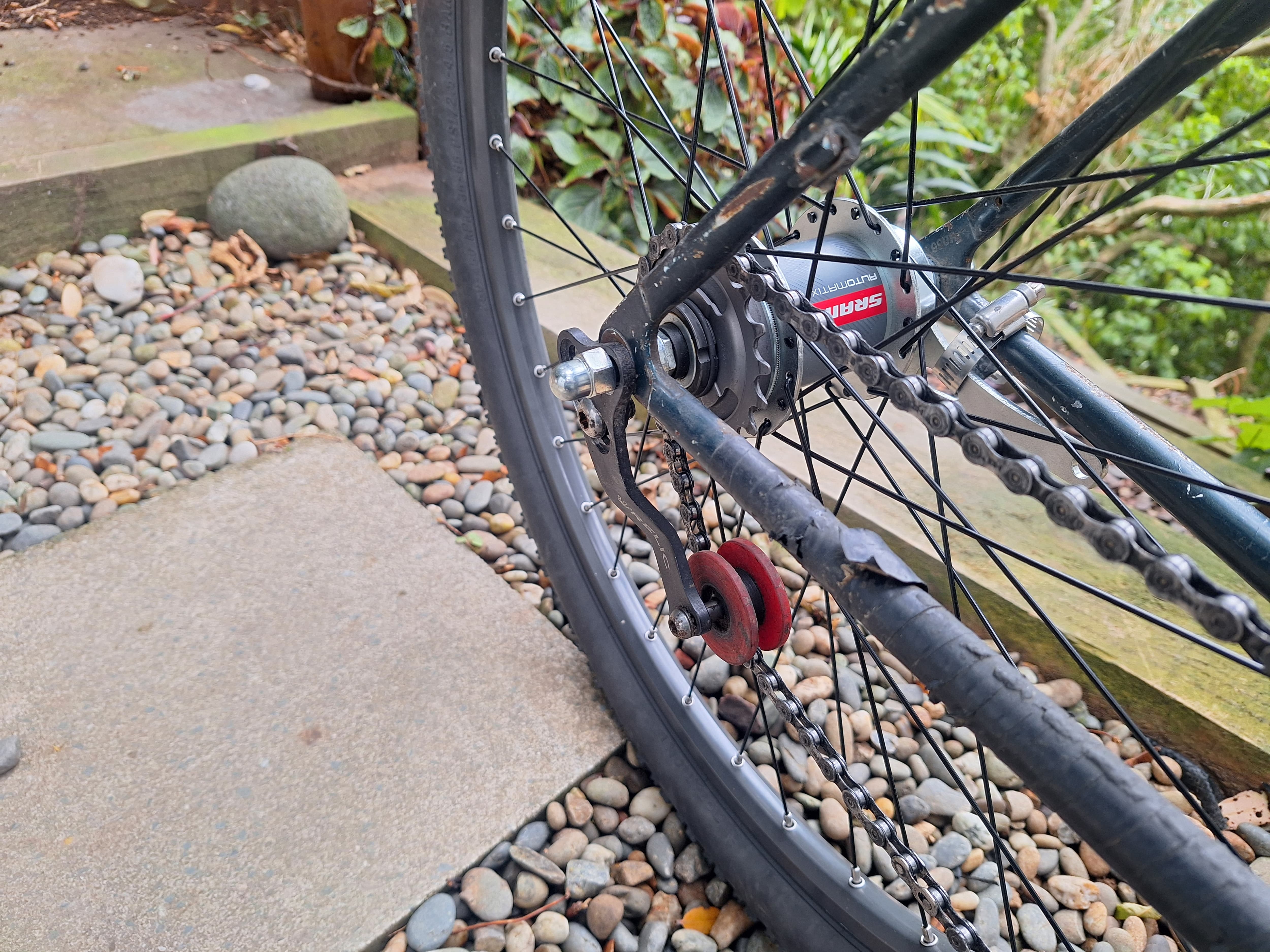

Built up my sram coaster auto hub into a 26 inch wheel last night. This morning I converted a friends SSer into 1x11 with sram GX I had refurbed and was just sitting in my parts bin. This arvo I bled the rear brake on my Tallboy and anothet rear brake I brought from a guy called John John a month or so ago. John John died while out riding with his son last week. Heart attack. I didn’t know him well but have always known of him. One of many converts from motorbikes back in the early mtb days. Another guy I know also died in January, or feb, riding by himself. Havent heard the cause. Another ex petrol head. Imagine riding with your dad who you assume is bullet proof because hes so fit, and wham. Poor kid.

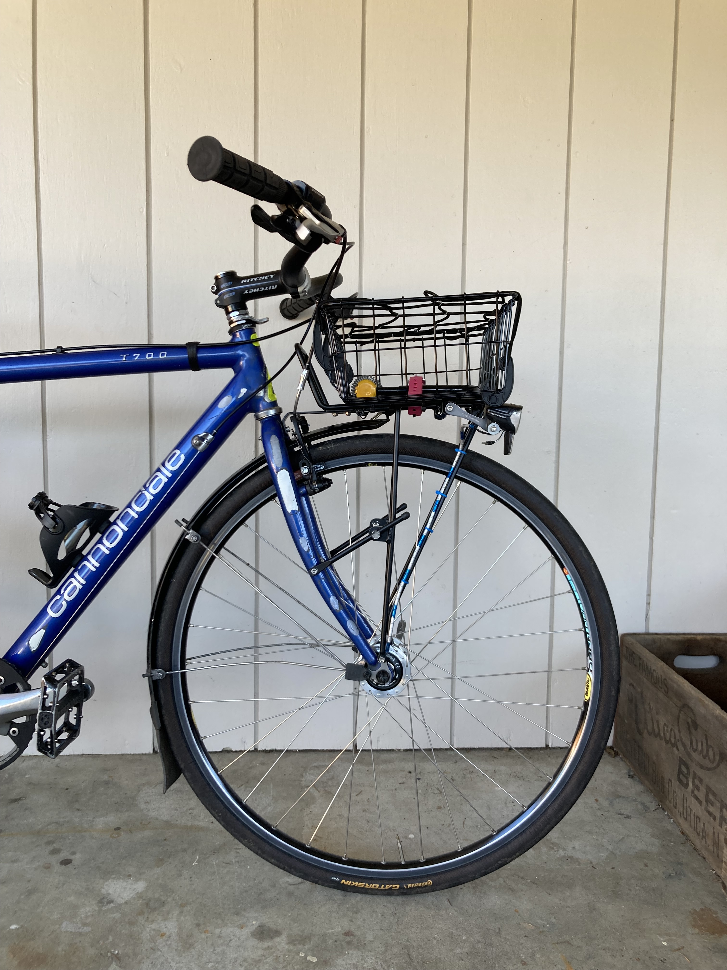

Got these things that Jake sent me set up
And the Soma rack installed

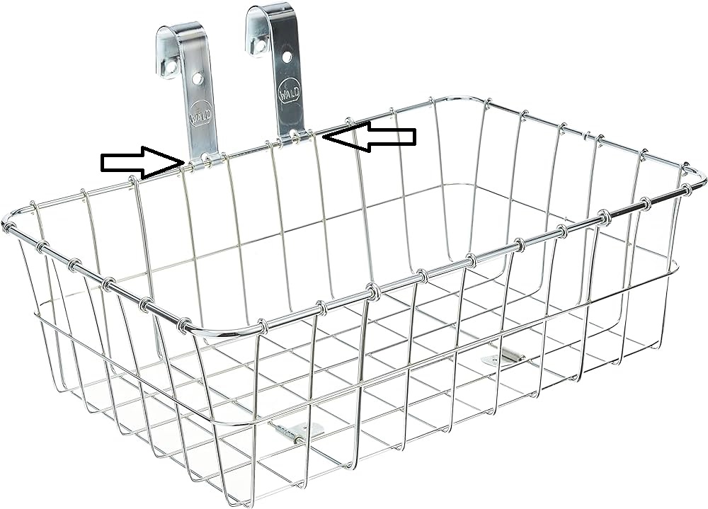

I haven’t chopped the basket handle bar attachment bits off yet but I should. What’s the easiest way to do that?

It’s a Wald basket right? You should be able to pry them off with a flathead, at the point the arm wraps around the basket. Same with the legs. That’s what I’ve always done.

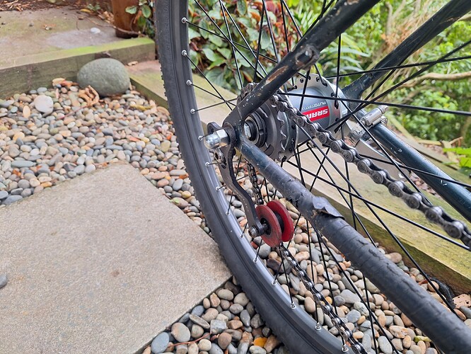

Finally put the sram automatix coaster wheel on. I can’t belive it built up so true. Not sure ive ever had a coaster brake. Maybe in the late 60’s. Feels damn weird. Realised if I have a puncture there are gonna be a few tools involved. As they say, seems to change up real quick. Will see what its like on the commute and see if its worth dicking with the tiny spring.

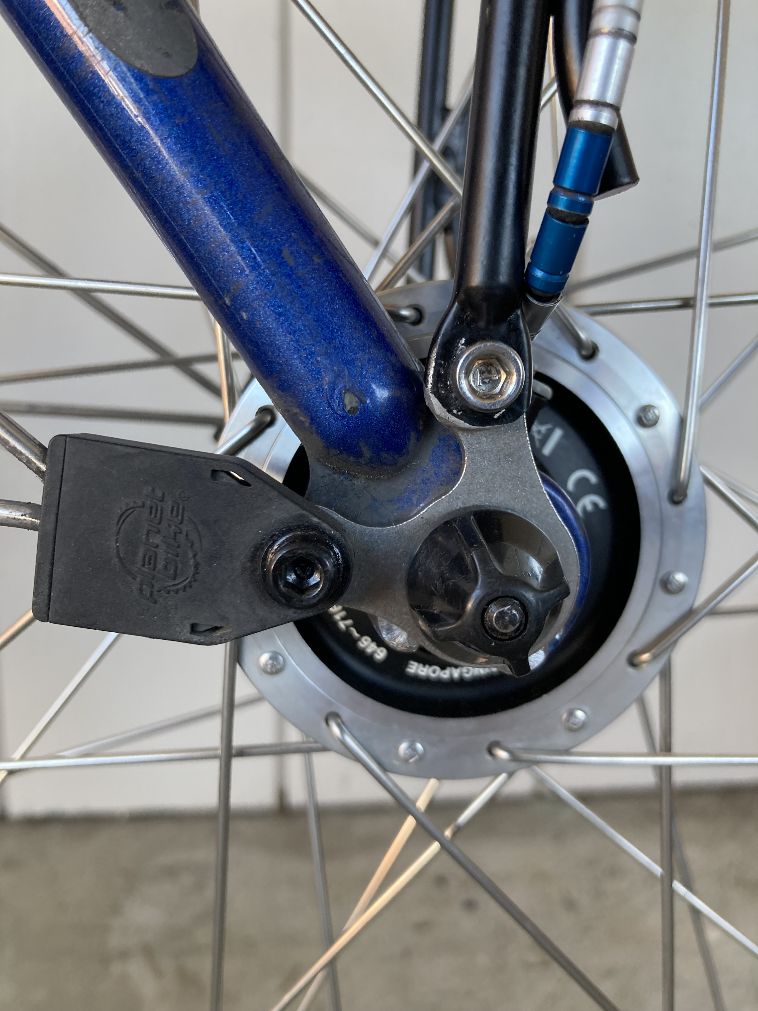

do you have your dyno wires through nikon housing?
