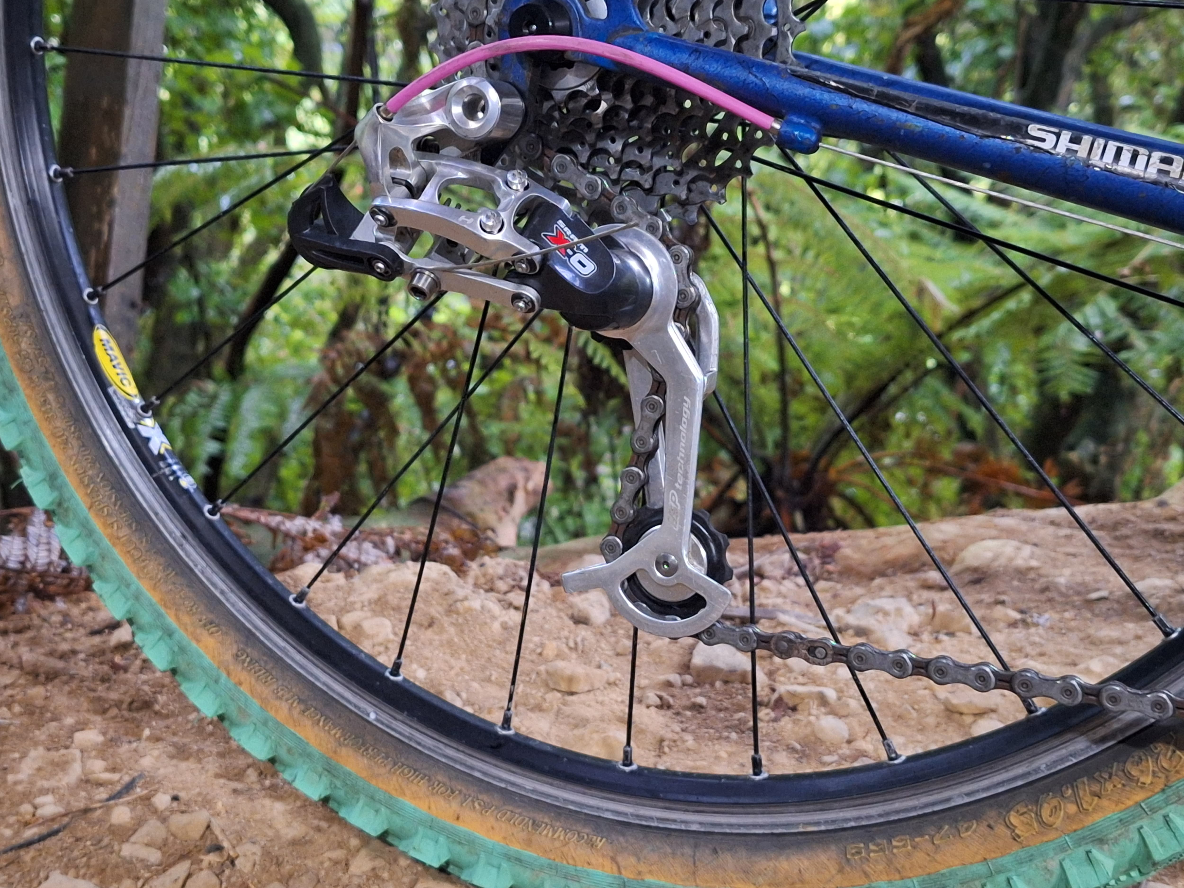

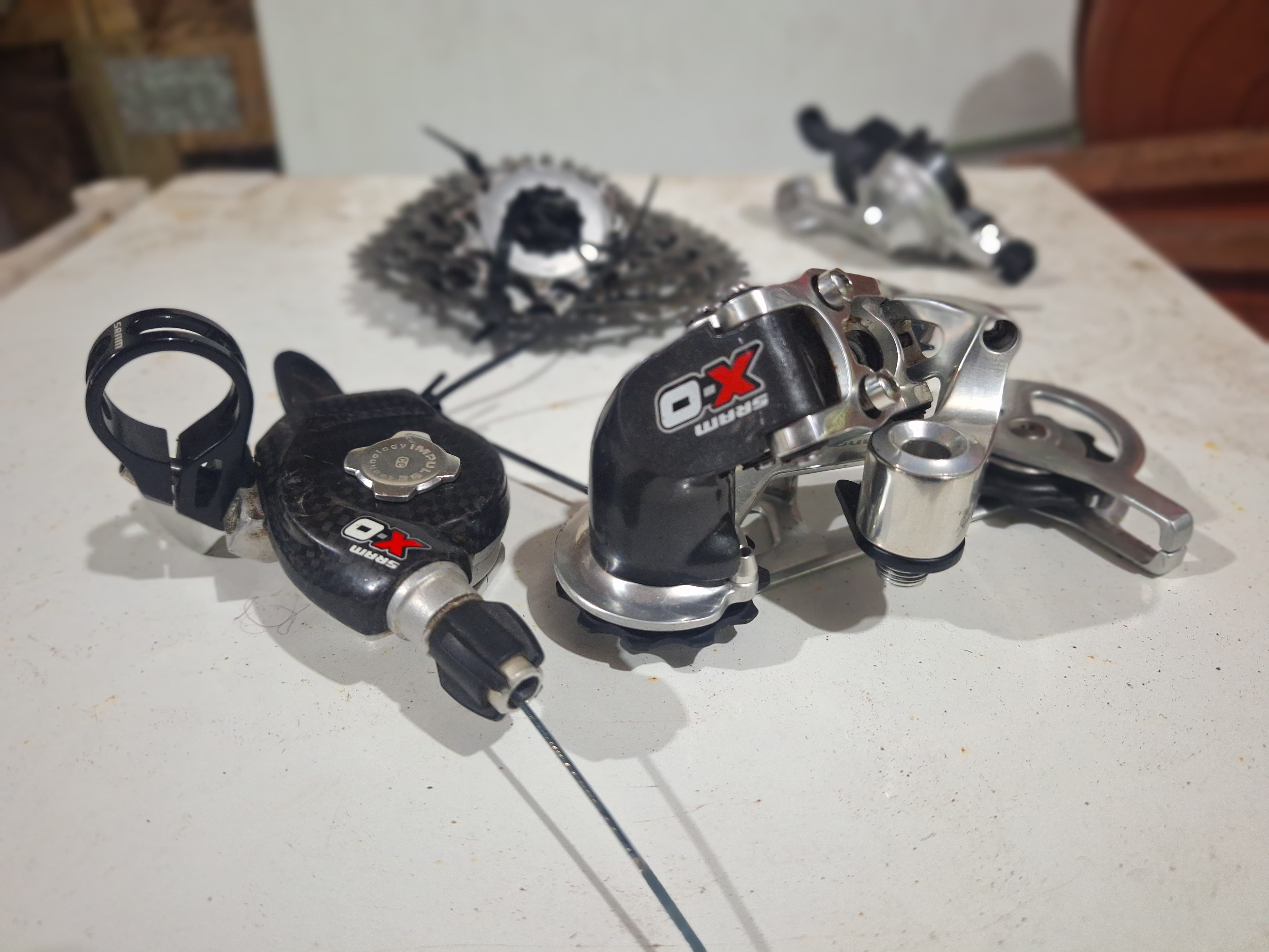

Took the 10x gripshift right and 3x thumby left off the goose and set it up with new grips and 3x9 speed sram, mostly X0. Sram was so good back then. Didnt even need a quarter turn on any cable.

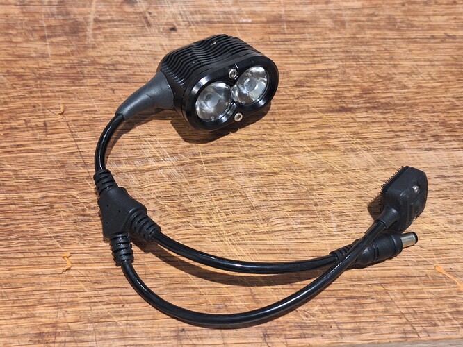

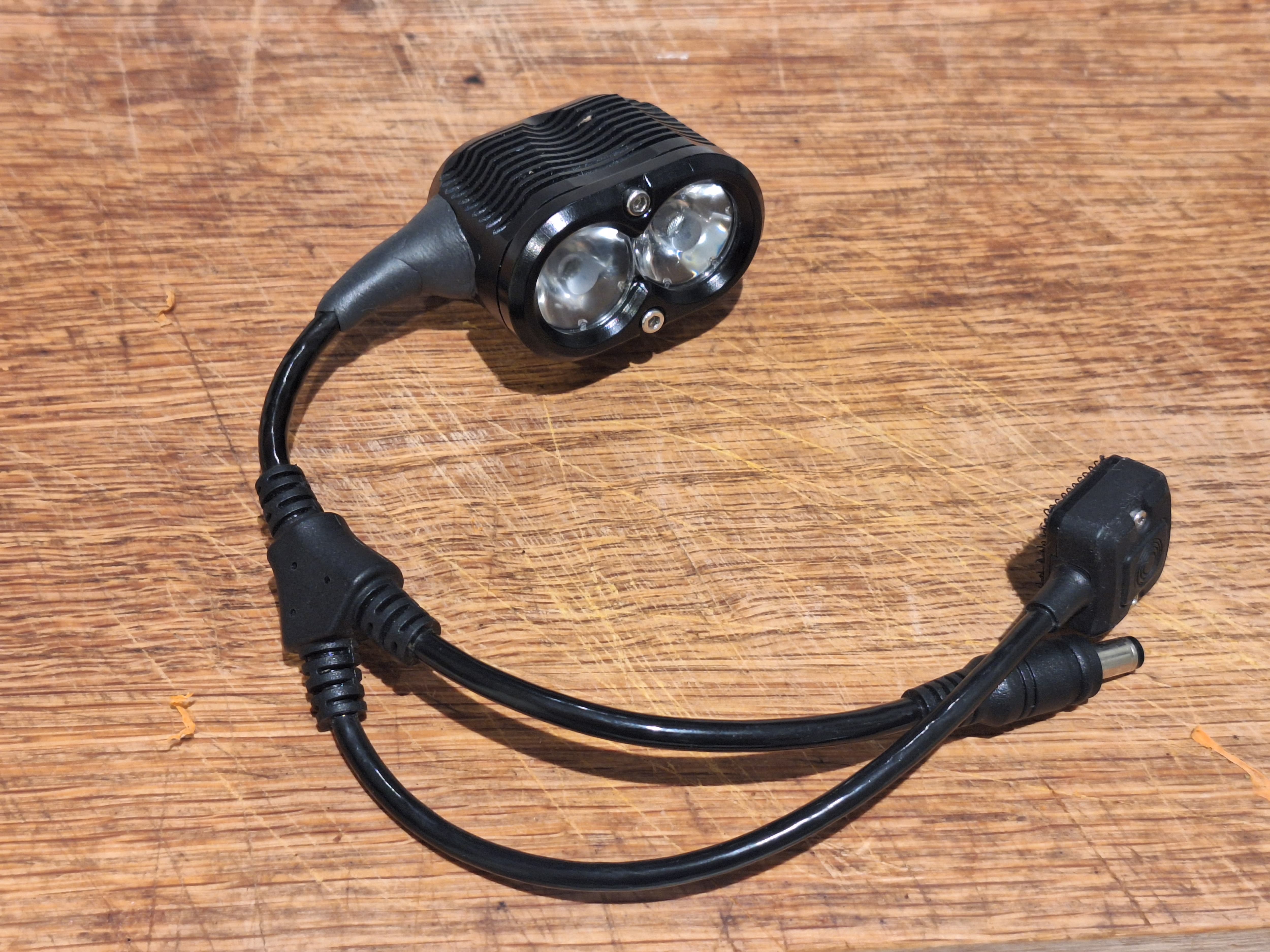

Also built a new lower dynamo cable with some xt30 joiners, an SP spade, cable and heat-shrink. Also fixed my shitty gloworm lights with Suguru and more heat shrink on the shitty cables.

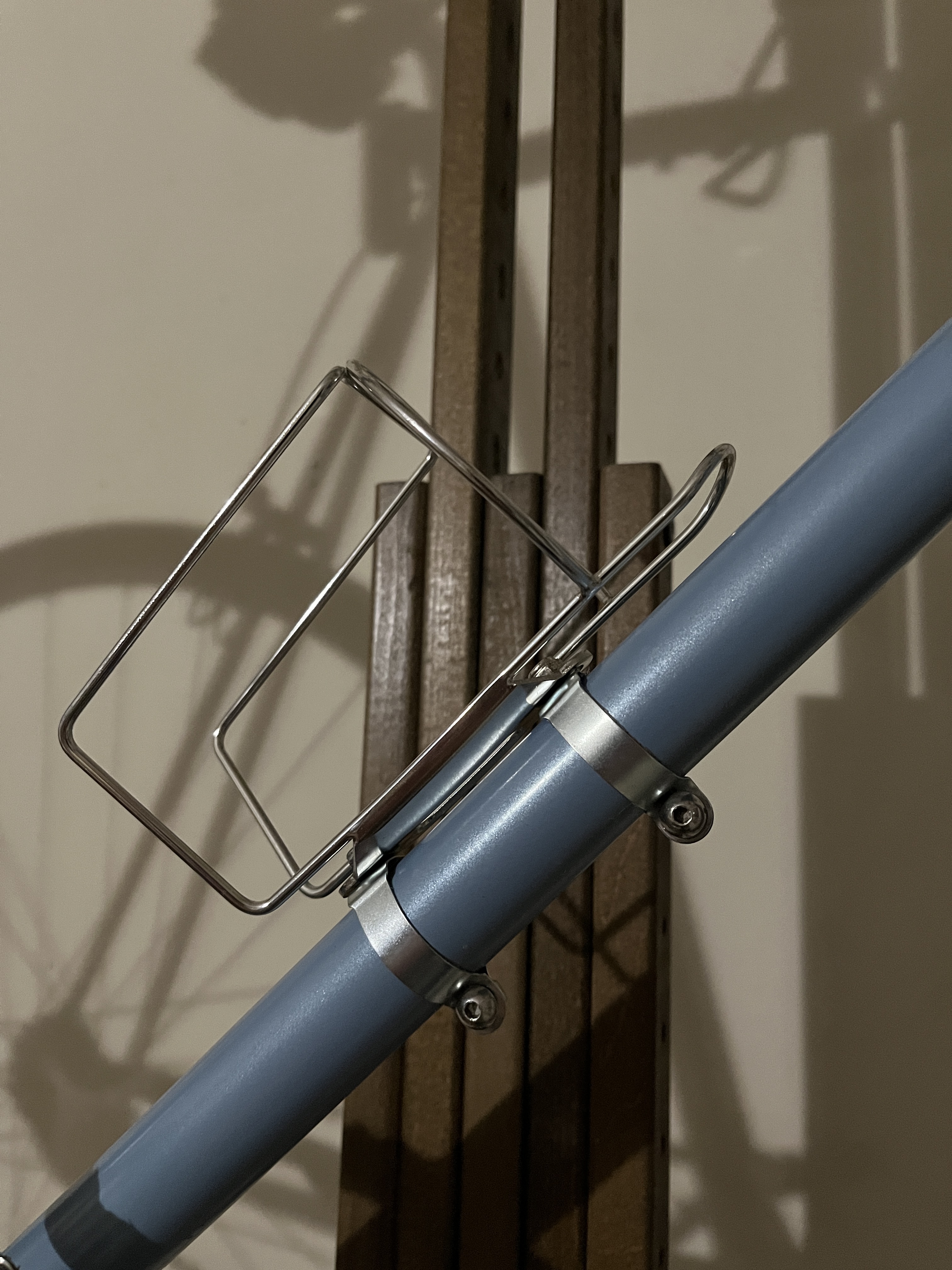

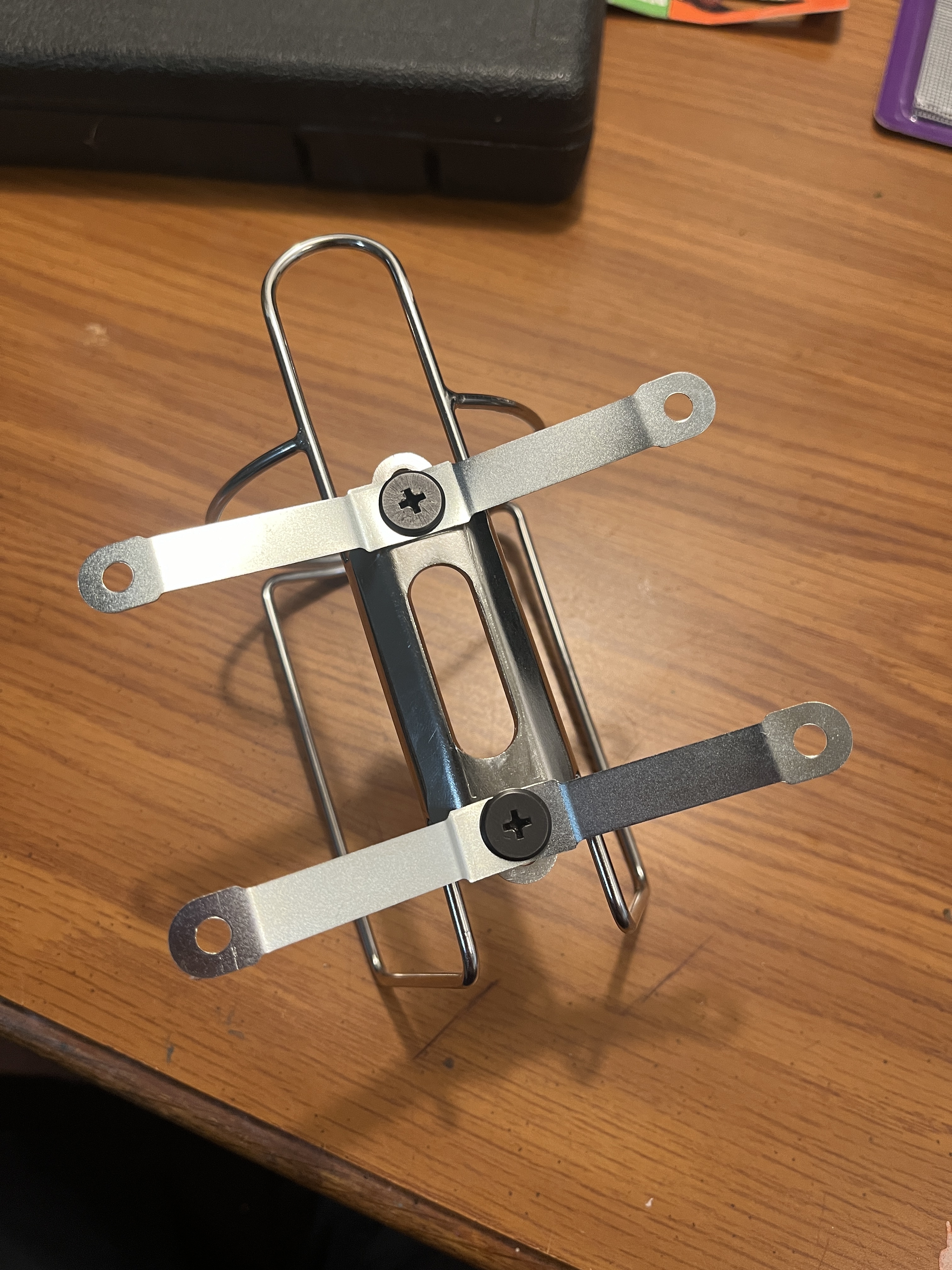

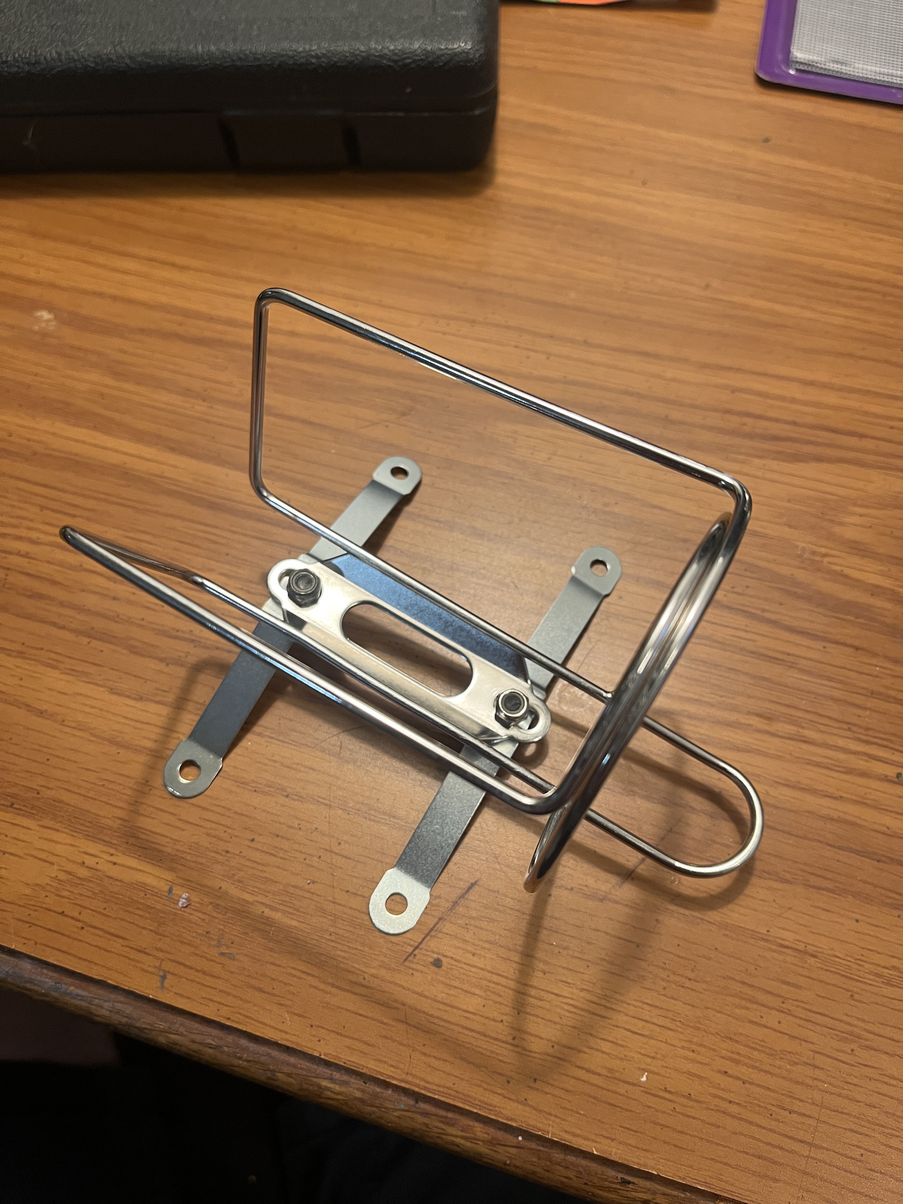

Had this idea a while ago for mounting a bottle cage that doesn’t have long mounting tabs to a bike without braze-ons.
VO bottle cage straps + VO Retro Cage + Speedplay cleat mounting screws.
Works great!

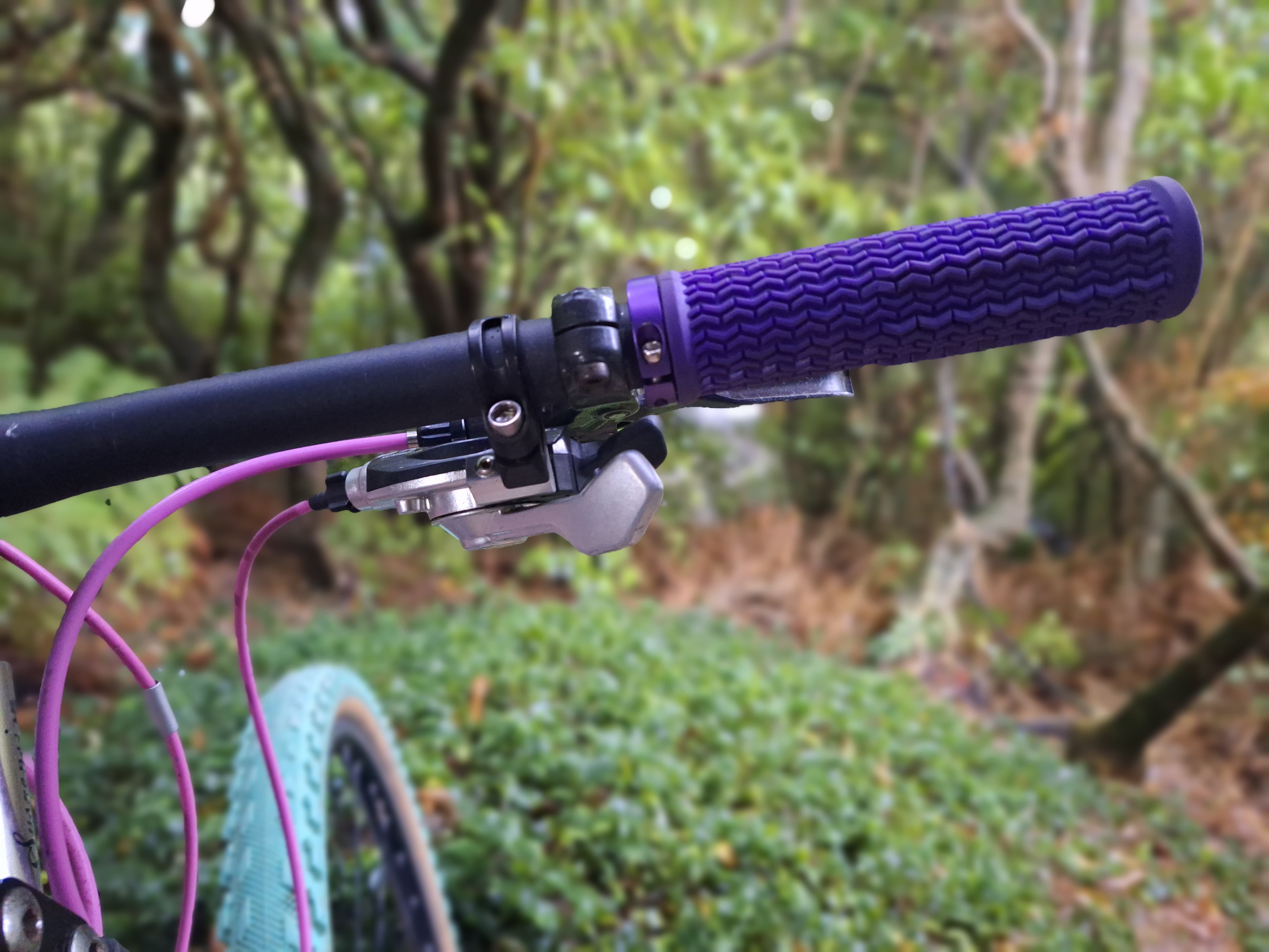

Took Sensah dangler off Sundeal and put it on the hardtail. Going to put more sensible deore stuff on the sundeal soon. I’m pretty sure I’ve never ridden a mountain bike that wasn’t single speed. Starting a new chapter.

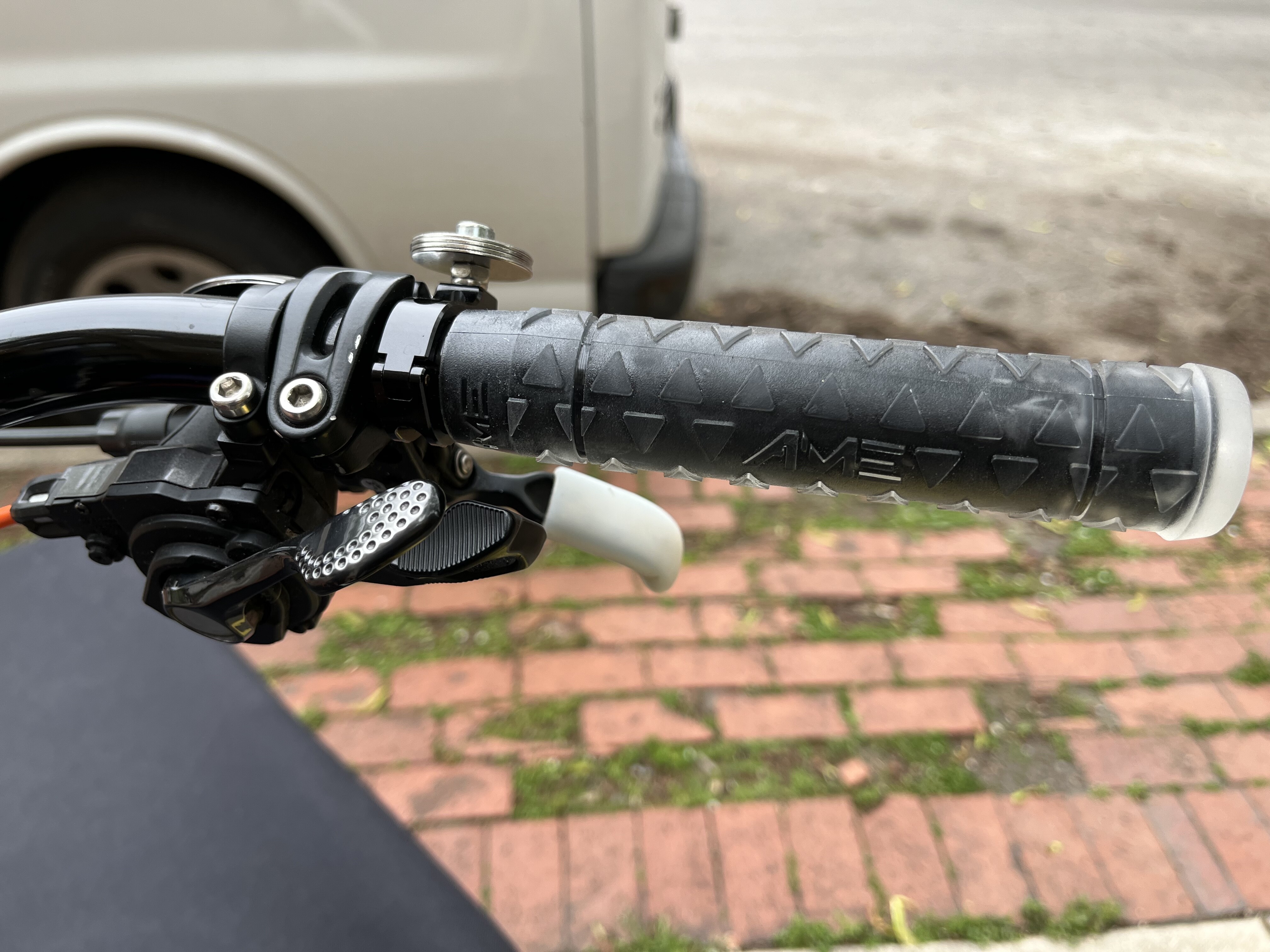

I installed these super thin rubber bmx grips. Jury’s out.
you can probably feel more sensation and the texture is there for added pleasure
Never ride without protection.
