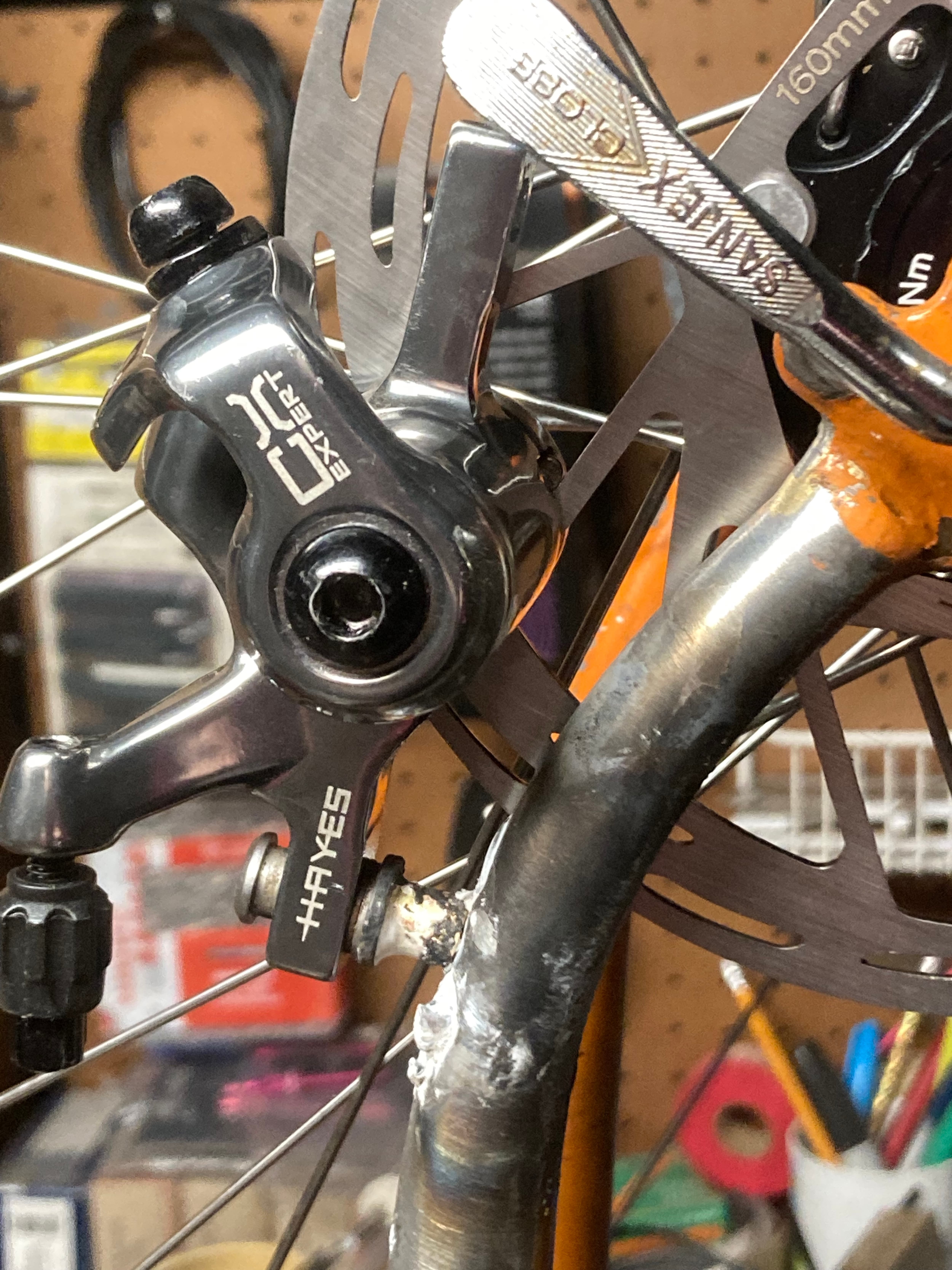

After several days of waffling about whether to do flat mount, iso mount, or post mount on the emergency randonneuse I finally bit the bullet and started tacking post mounts onto the fork.
One post mount, which I can use to help locate the second one, and when that’s done make up a proper post mount jig so I can put post mounts on the rear triangle. sigh It doesn’t really help that it’s pretty cold outside and I have approximately 7 million excuses to stay in where it’s warmer.
(I bought a handful of these pretty silver Hayes calipers on ebay a few years back, so it’s time to use them up.)

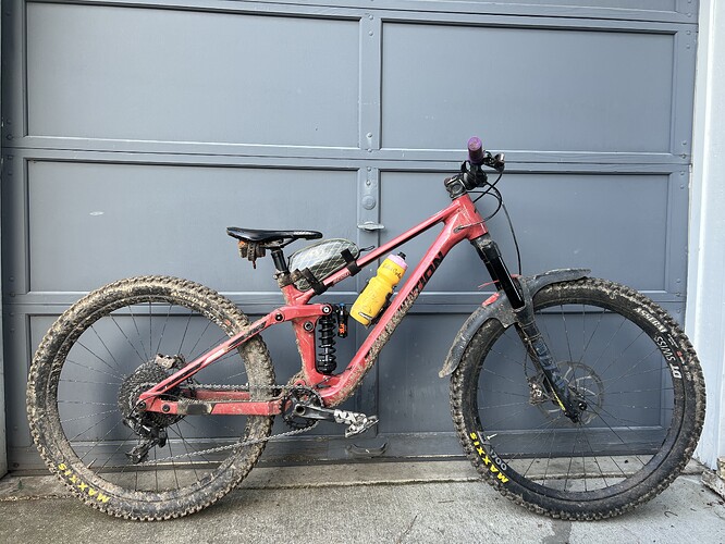

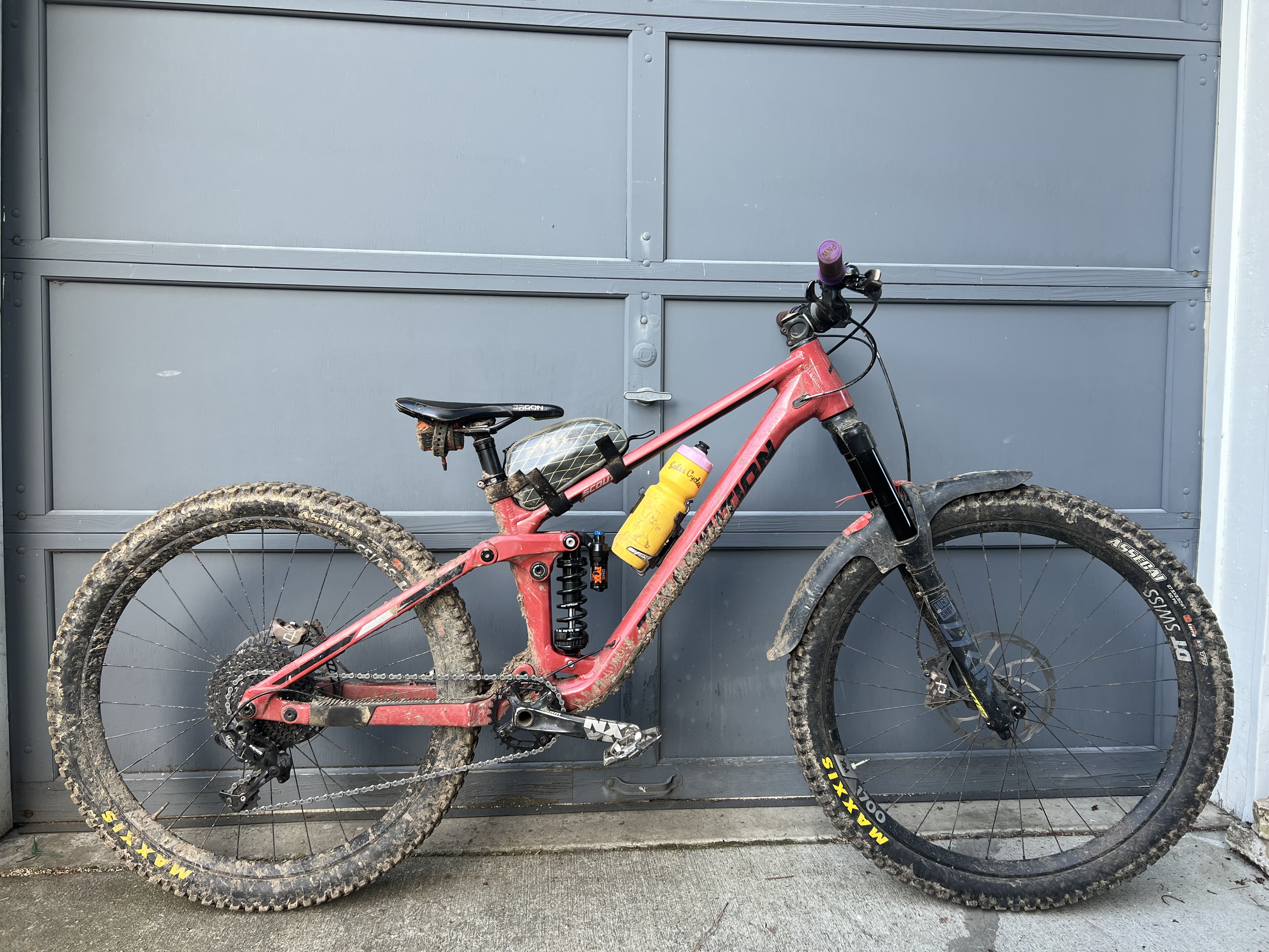

Coil boi now.
Edit: got a stand… nitrile gloves… and didn’t have to swear at all mounting the shock. I might as well be a real mechanic. Also put in a new chainring.

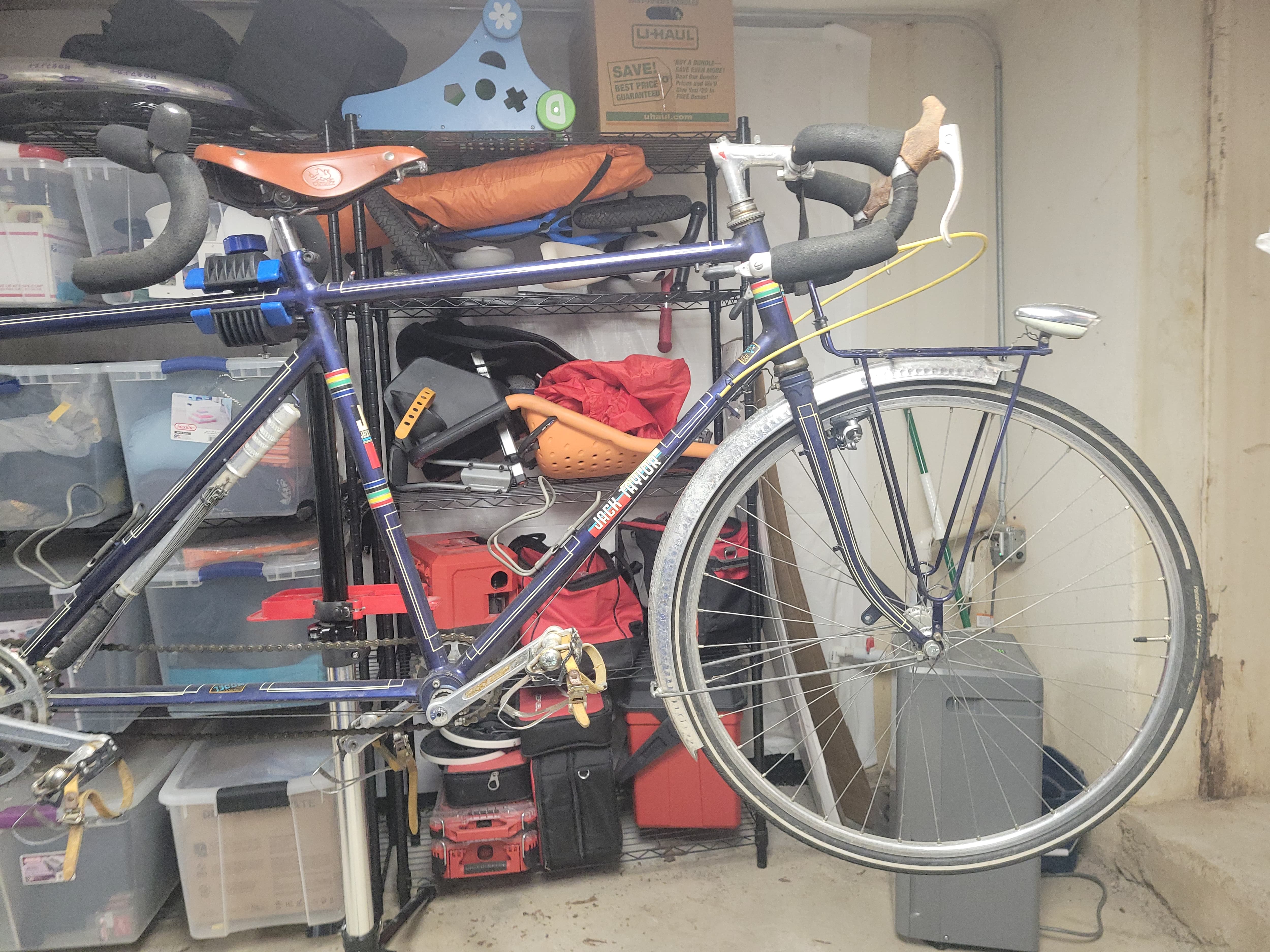

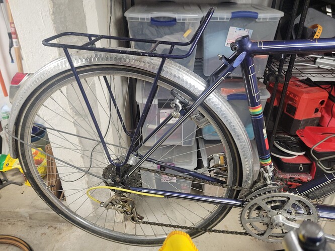

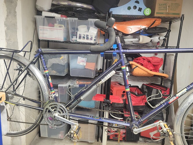

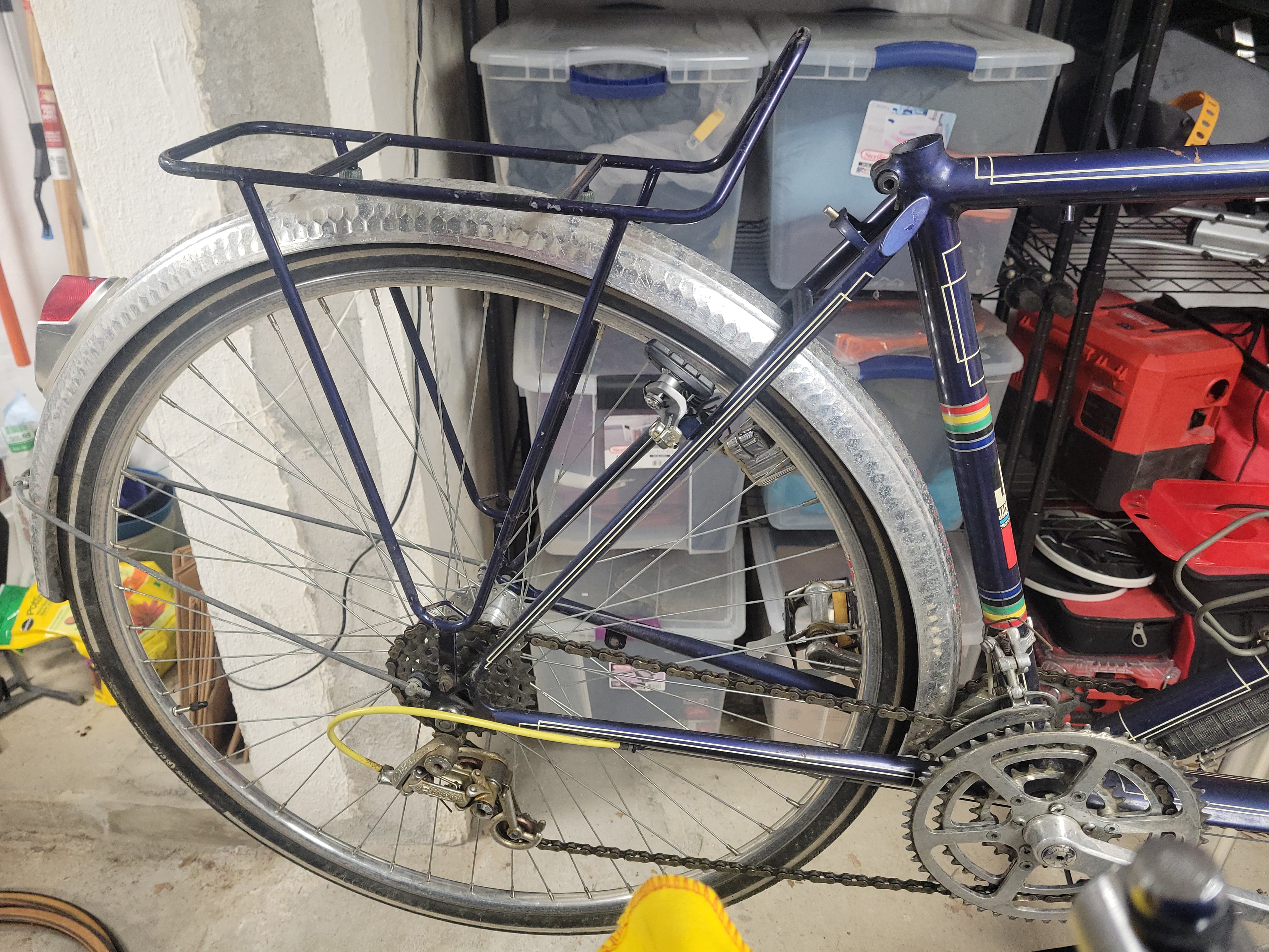

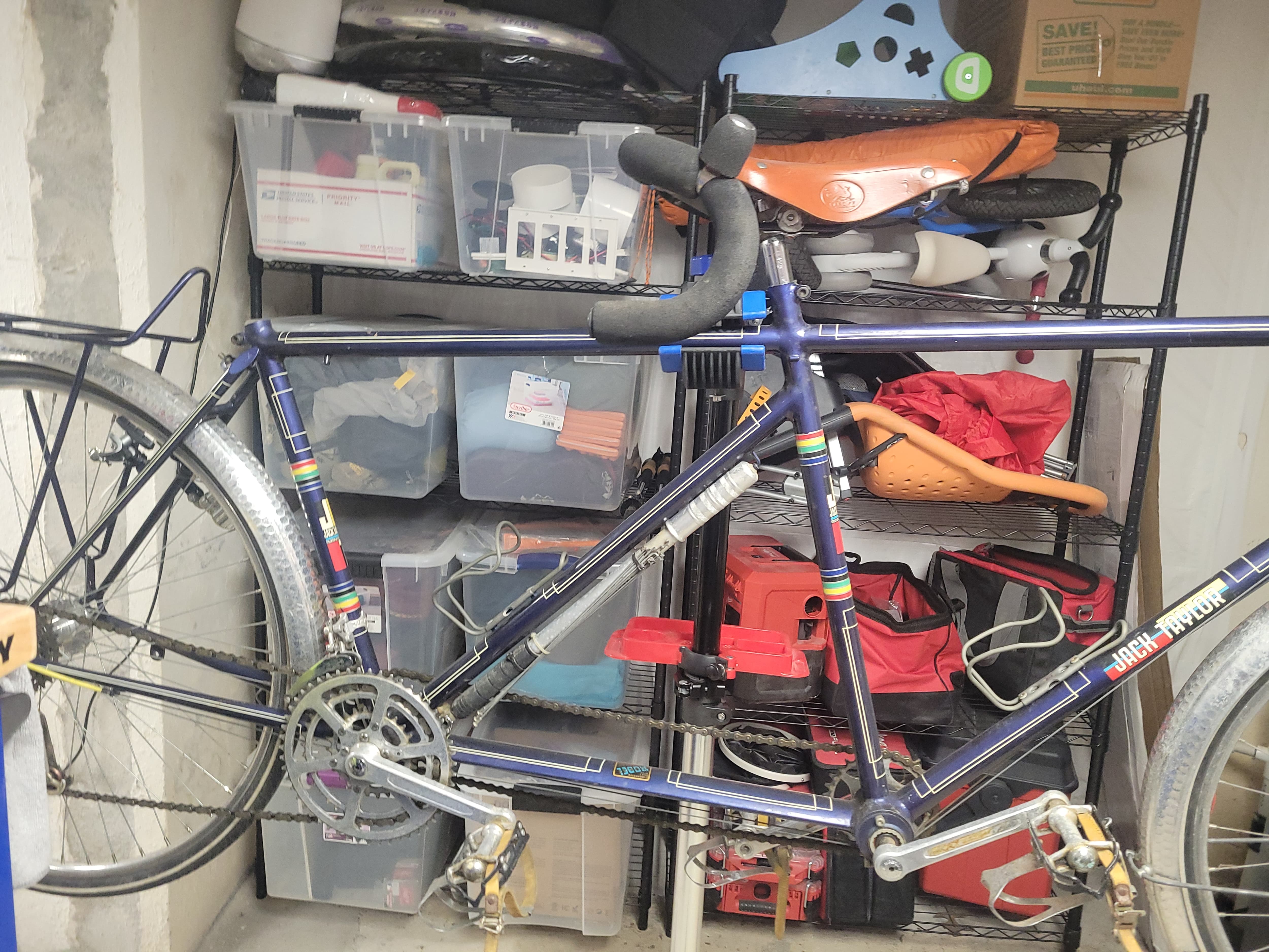

Fixing up the double Crosstrek (tandem) some more. Pulled off the analog odometer and replaced the decaying tubes and skinny tires with some lovely 32mm Panaracer TServ I had laying around. I bet I could fit 38mm under threse fenders. This British bike from 1975 is such a weird mix of metric and imperial hardware.

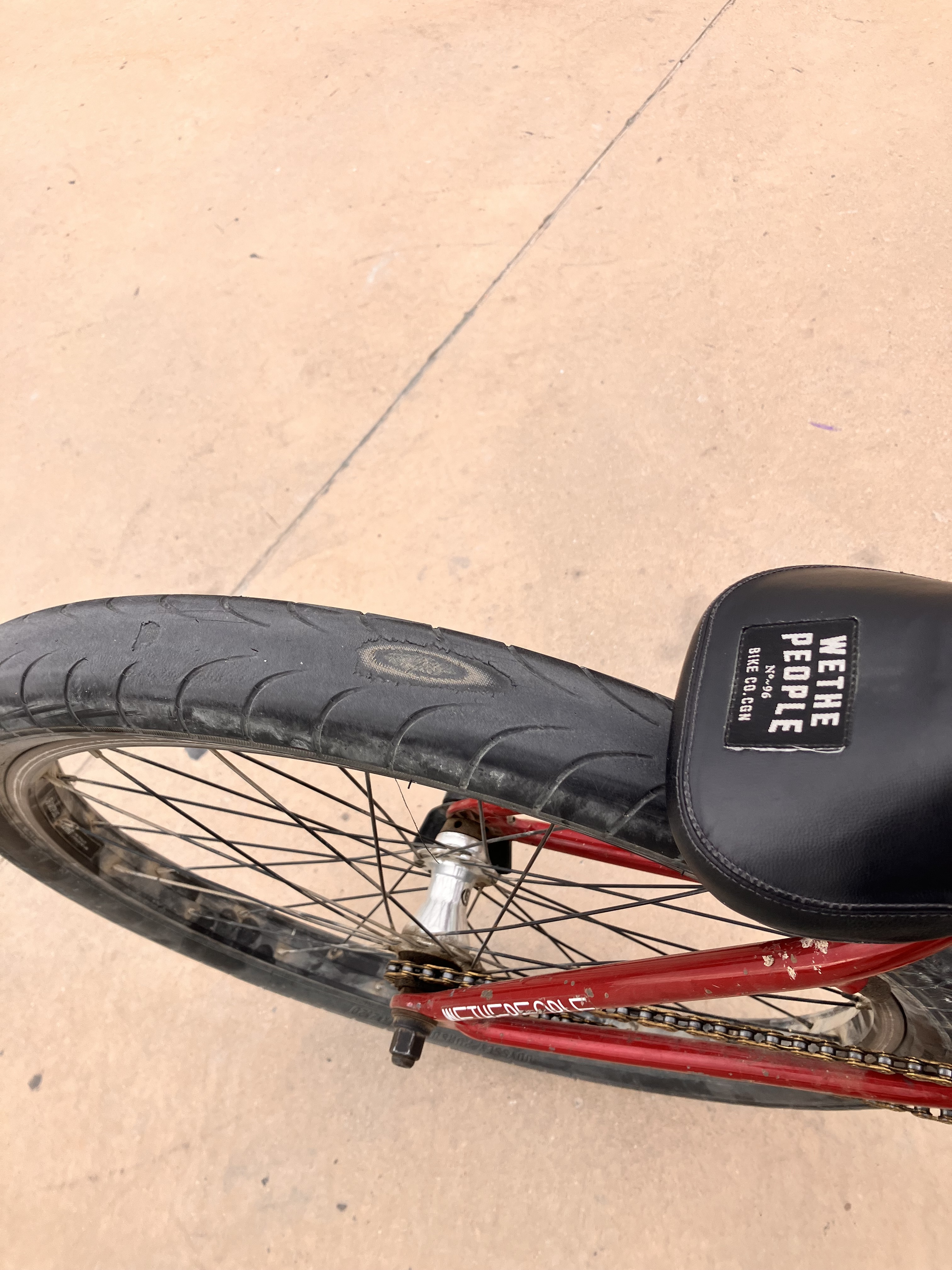

Noticed this today.
Wheels need some attention, can hear loose spokes when I ride.
Ordered a stupid left hand thread pedal tap and chased a stupid left hand thread crank arm. Didn’t realize these were imperial until I ordered it. Why do bikes have such terrible mix of units?

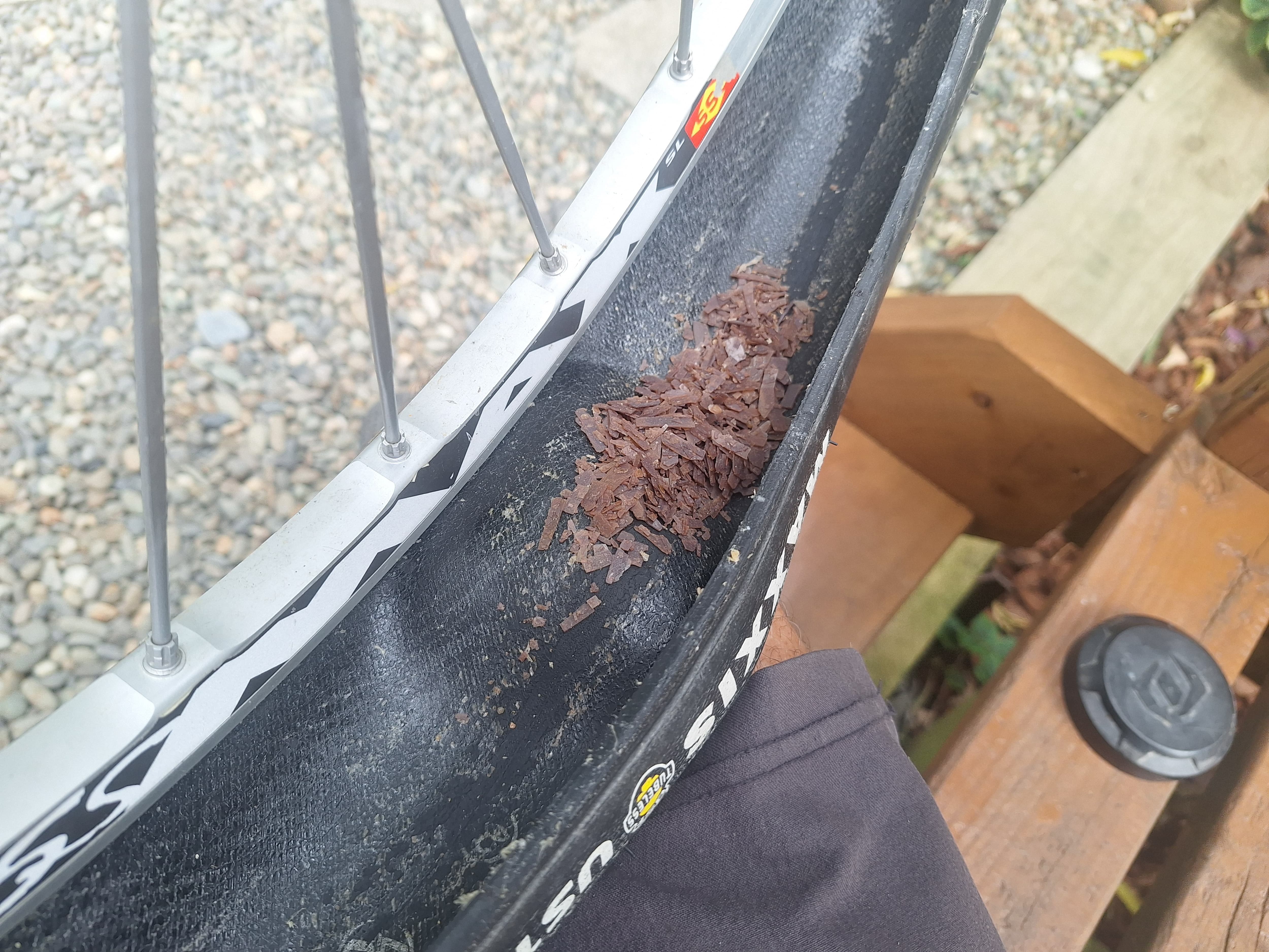

Put a tube in the Cannondales f700’s UST wheel/tire which was still holding air. Great system. Put a new derailleur on the f700 to try to solve the shifting issue. Tweaked the bearings in my 2x auto hub on the DBR to stop chain sag when back pedalling. Made progress but still had more play than I’d like. Eventually took the whole wheel off to replace it with a single speed wheel with the 3x on the front. Feels good but missing top-end and 800 grams lighter. Pulled stem up on plastic road bike. Pumped up tires on plastic and steel road bikes.

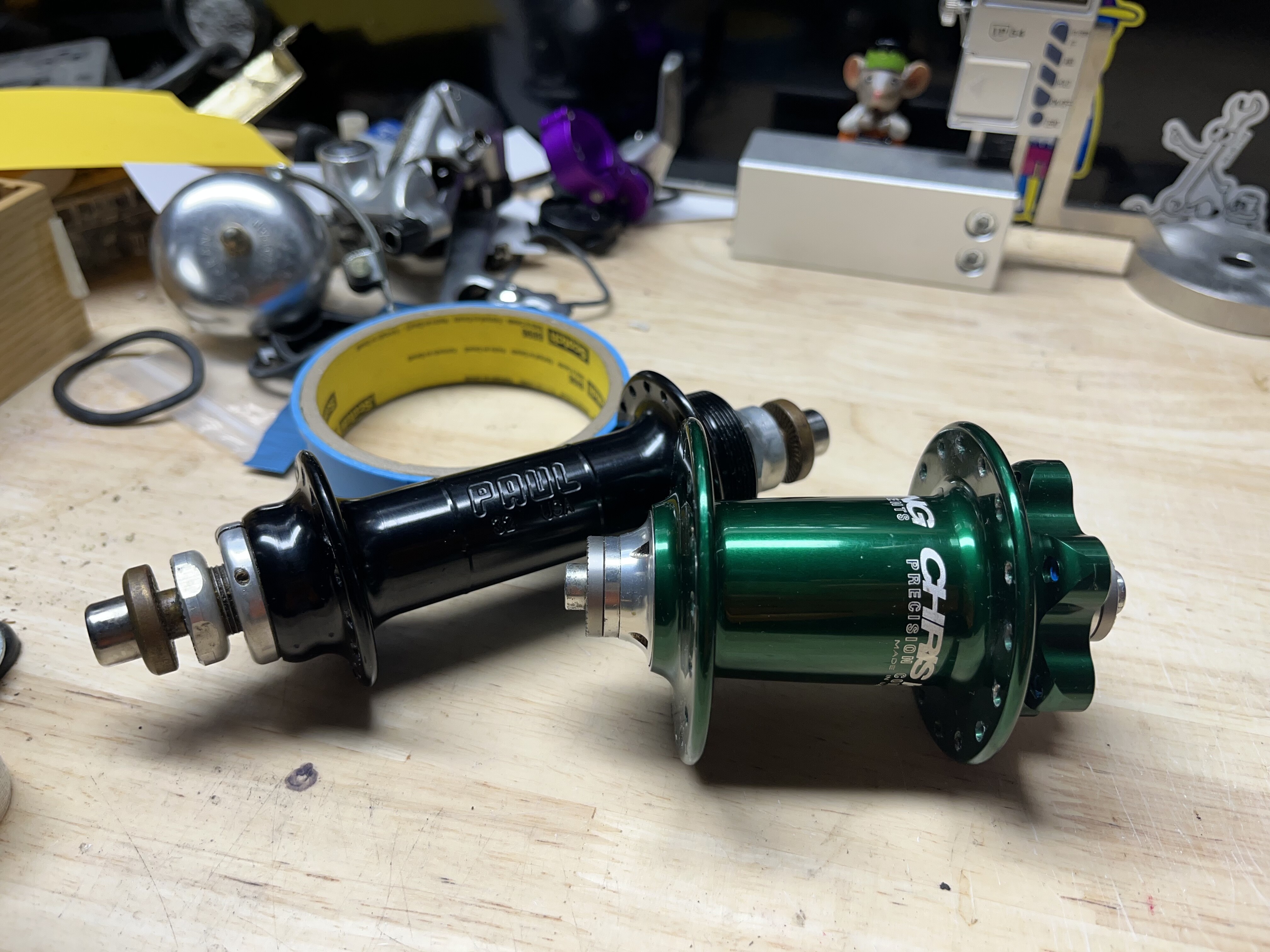

I de-built two old wheels that were deep in a closet. I totally forgot that I had these fancy hubs gathering dust! The hoard provides! Maybe the 1x1 should be a mullet.

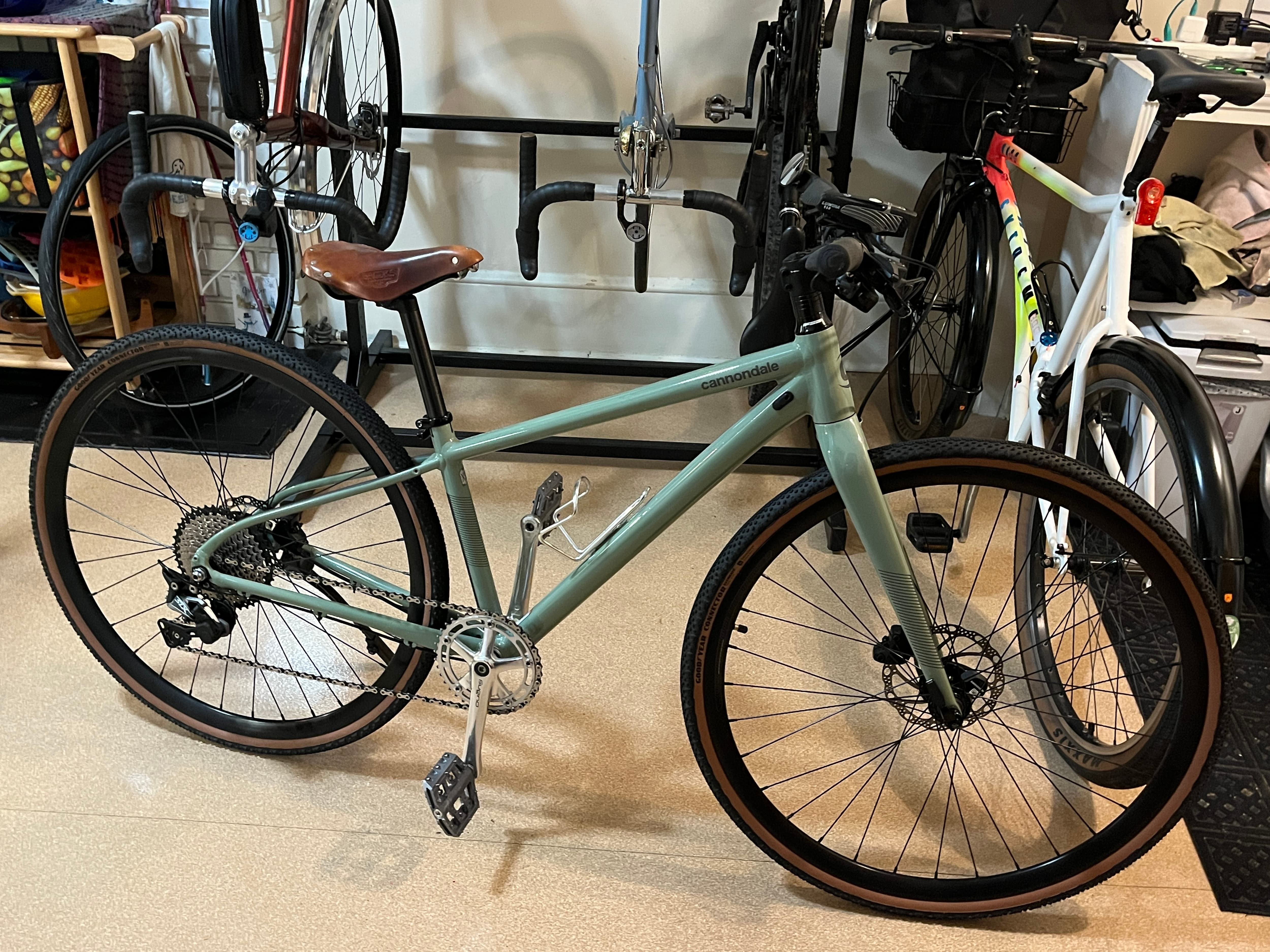

Did some work on SUPs bike yesterday. They wanted to learn about how things worked, so we swapped a seatpost, tires, and drivetrain.
Swapped an alloy seatpost, RD-M610 RD & 10 speed 11/34 cassette and 32mm Schwalbe Spicer tires with a Salsa Guide carbon post, RD-M7000 & 11-46 cassette, and 35mm Goodyear Connectors that I got from a friend.

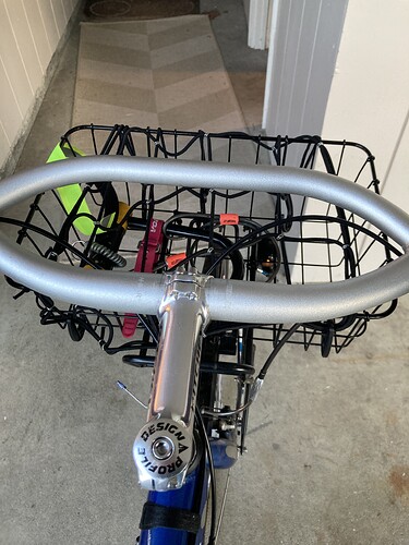

I couldn’t stand looking at the black stem/silver bat combo so I replaced the stem, not sure if it’s actually an improvement.
It’s tough to find a perfect match. Same issue with anodizing, some colors are impossible to match even with the same brand.
I know the blasted matte finishes are theoretically more durable but prefer the smooth ones currently, comparing a nicely finished Easton Haven to a Zipp service course was a bit sad
