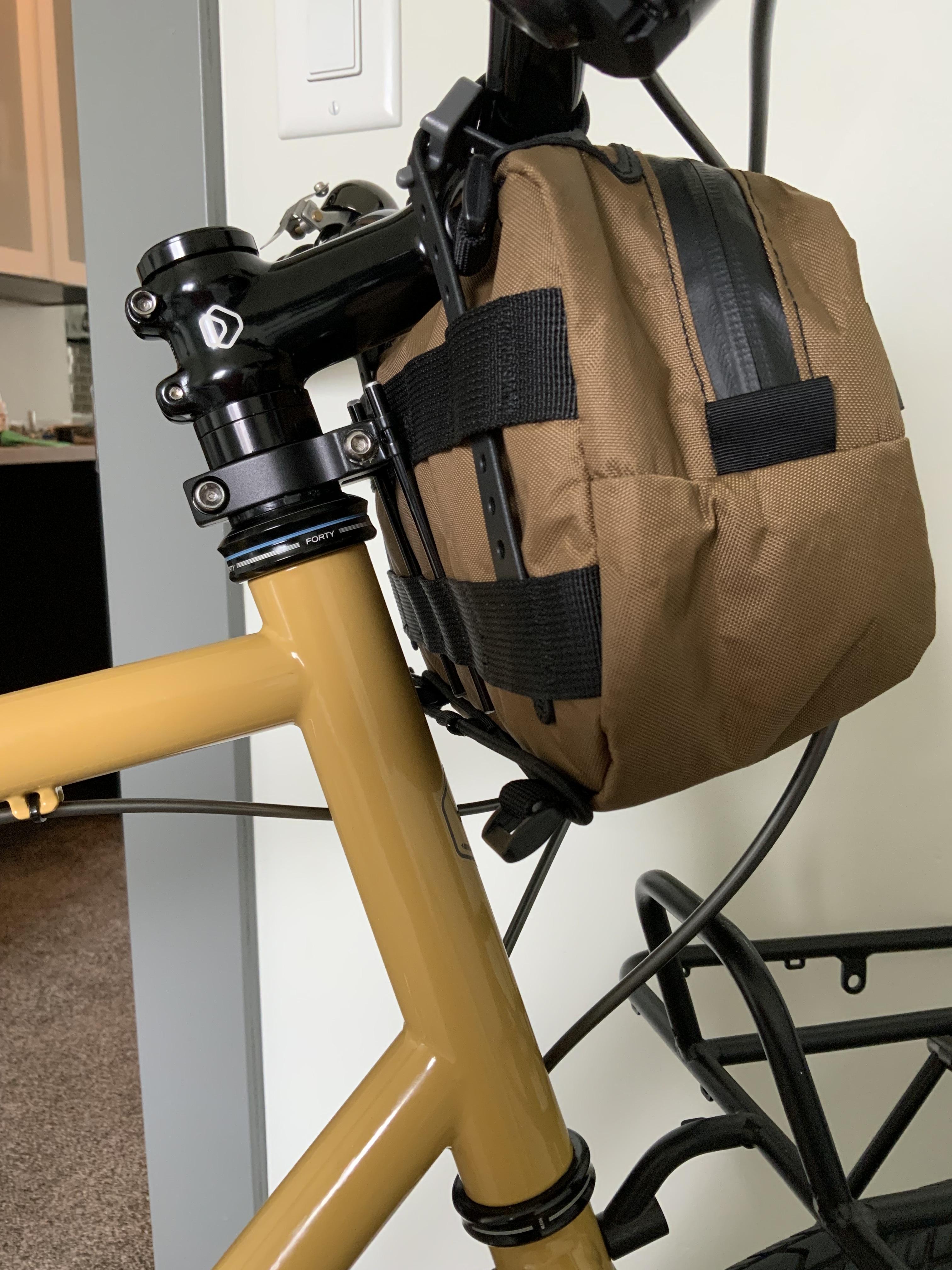

Put a shortie 32mm stem on the Boost before going down the new stem and bars path and that just might have done the trick.

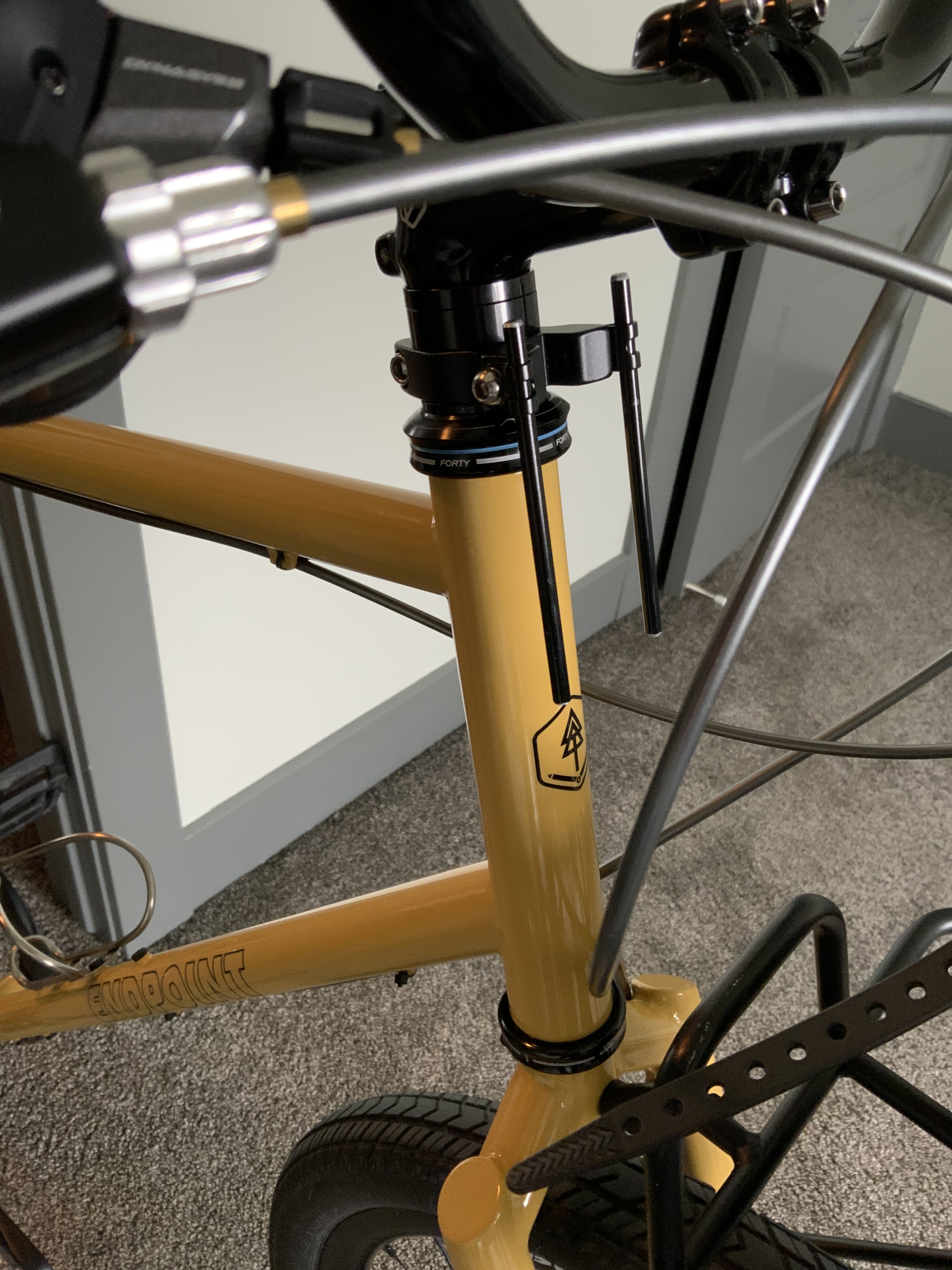

Used the steerer clamp from my unused DIY decaleur and some fender stay scraps and made a bar bag support thing so the bag doesn’t rub against the frame.
You gonna double bag it on that thing?
It’s getting a small basket, so that’ll definitely be an option.

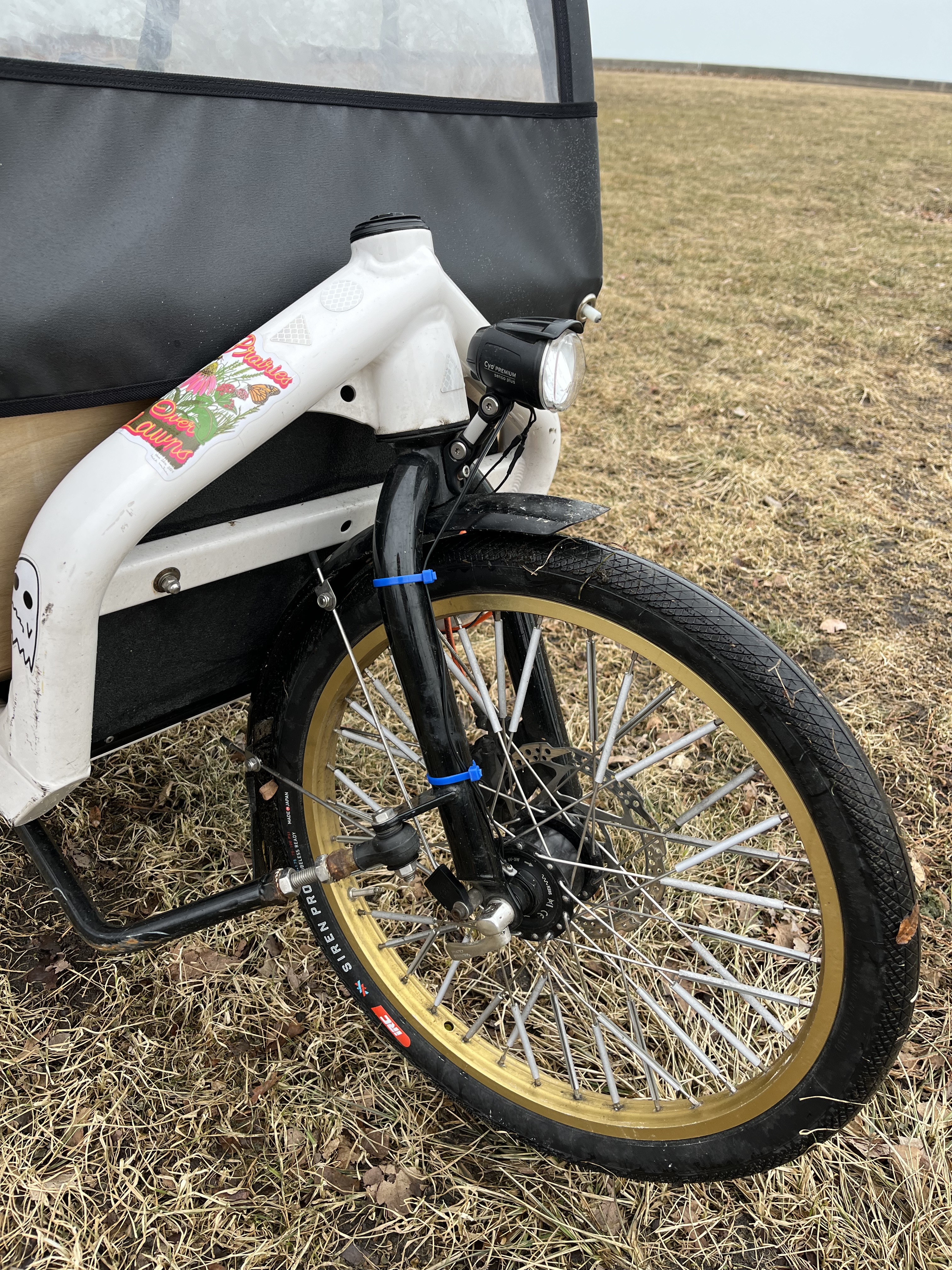

I don’t understand the brake cable?
It’s a cable that operates the brake
That’s just where it curves to go to the left on the backside of fork. But weird looking for sure.
Ohh, I was also confused thinking it was going into the headtube. But you barely can see the curve zoomed in.

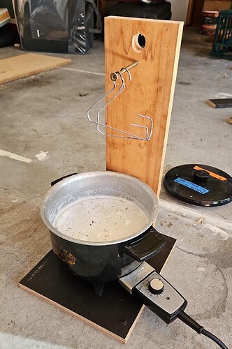

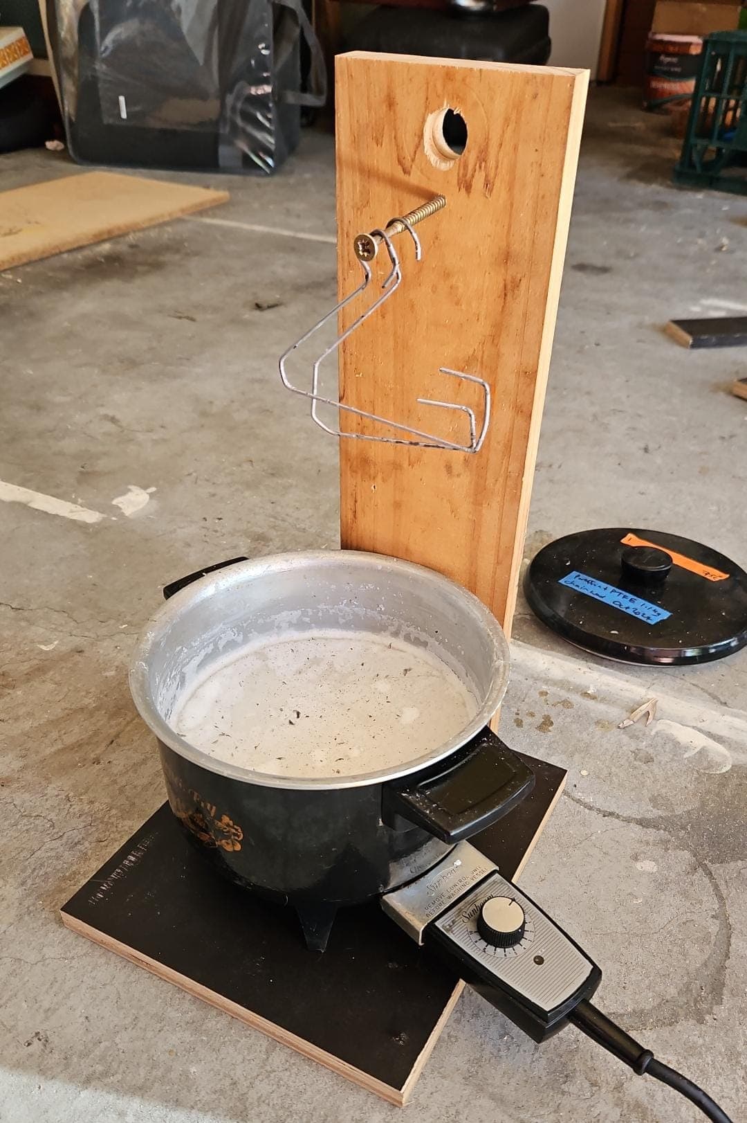

Time to see if DIY chain waxing is worth the $58 dollarbuck dither.

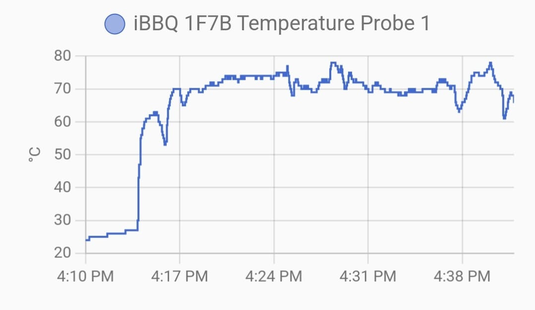

Paraffin & PTFE in an op shop deep fryer (and home assistant temp monitoring).
Spent most of yeterday degreasing and ultrasonic cleaning chains and cassettes on all the crosschecks. Hoping that rewaxing will be less of a chore with that step complete.
The Silca StripChips are supposed to be the jam for waxing.
I need to get some Silca chain stripper so I can stop fucking with mineral spirits.
As I understand it, this is formulated to remove factory grease, not chain lubes, so it may / may not effectively remove existing lube and junk.
I ran mine through a degreaser bath in an ultrasonic, and used degreaser and a brush/rag on jockeys / chainrings. Total pain first time around for sure. The idea of rewaxing only being ‘dump chain on wax, turn on, swish and drain once at temp’ is much less involved.
I have $8 in the deep fryer, $25 in the wax in the pot currently, and another 1.1kg of wax/ptfe in the cupboard, so I’m well ahead on the $270 for wax/stripchip/wax system kit cost, even if DIYwax is down a few watts

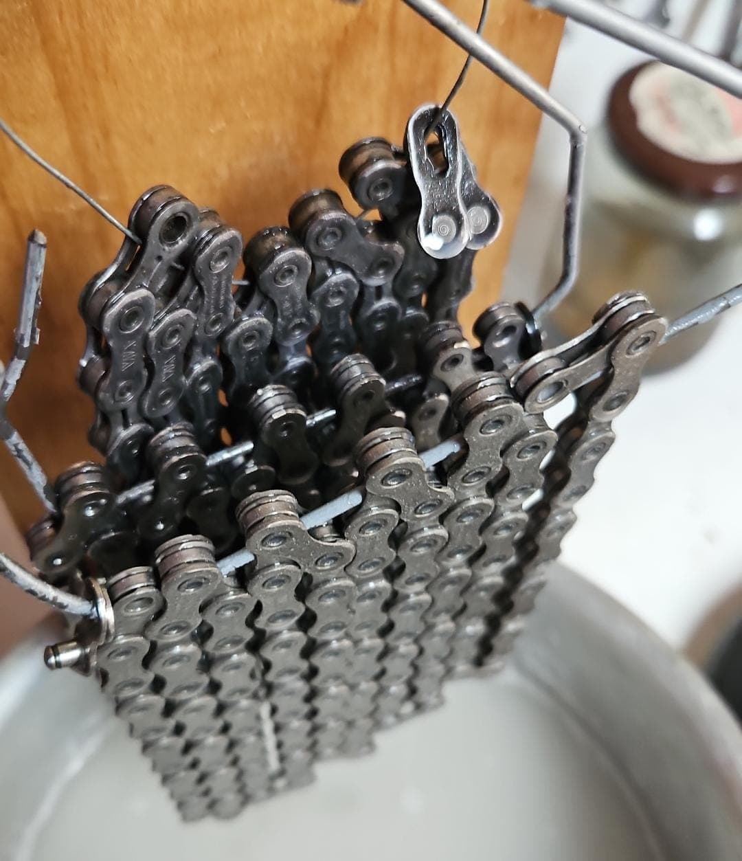

Inspired to make my own lil hanger stand to hang chains over the pot

I also replaced the failing iq-x with this cyo variant I found deeep in a drawer. The wire juuuuust barely reaches the hub on a 20” wheel. Guess that’s why it was in the drawer.
