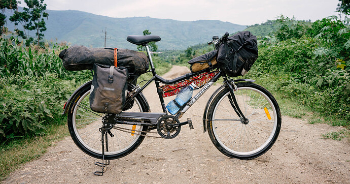

This is worth a read re: buffalo bike and WBR
I nearly included that link too. Doesn’t paint wbr in a great light
The previous article in the series is more favourable, but still… not a good look for WBR

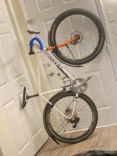

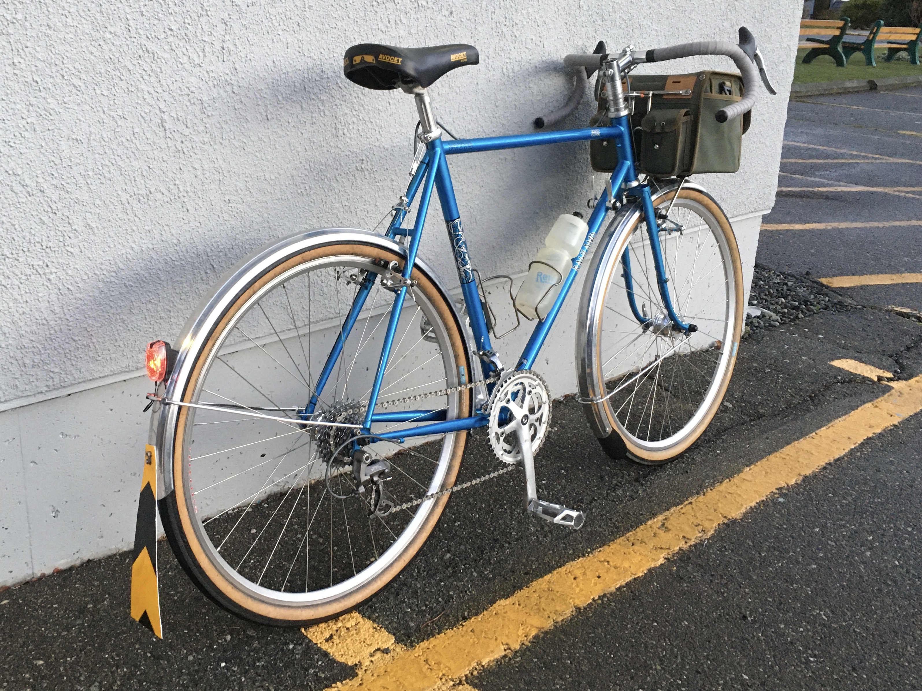

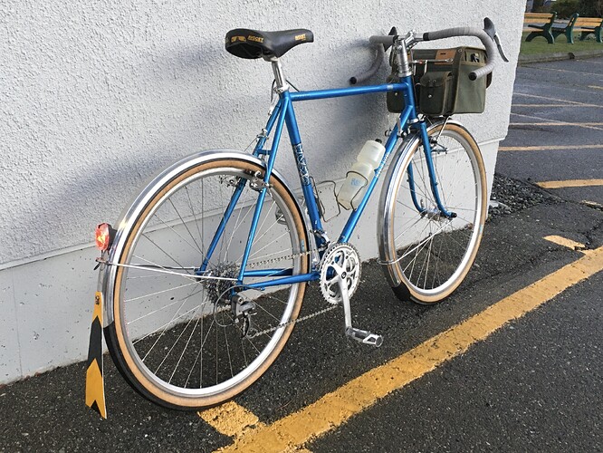

put fenders on and made mudflaps. Need to tweak em a bit or just wait for those new VO stays cuz the nuts on the inside intrude so much its hard to get a good fenderline without the tire hitting them. Also put in a disconnect for the rear light wire so i can move it if i take the fenders off. Put a steerer extender on a while back and i’m actually sort of enjoying riding this bike sometimes.
love how stuffed those fenders are
That’s a handsome bike!

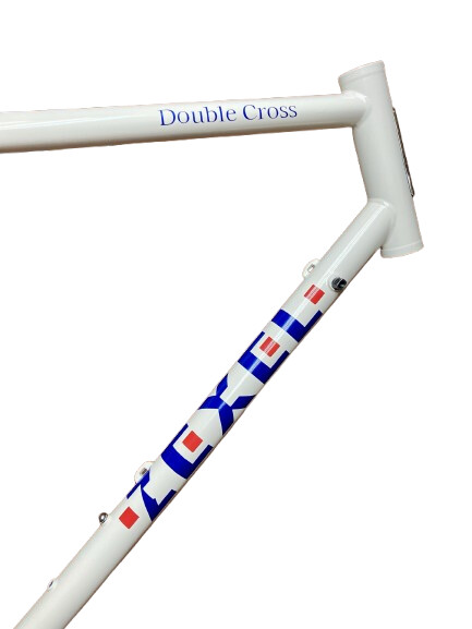

I spent a hour applying vinyl decals to my spray painted double cross. Then I messed around with two different steel forks deciding on which color I liked better. Moving things around just checking them out and how they matched everything else.
When I was done I had to move some old bike stuff that had been buried in my Mom’s basement. I picked up a carbon road fork, something I haven’t held in my hands in almost a decade, and it was like I was jolted back to reality from a waking dream. I had to stand there looking at it in surprise, waving it around and feeling the nonexistent weight. As if my hands held nothing at all, a whisper.
Shock realization I’ve pushed too far into the past and need to return to modernity. It’s time…

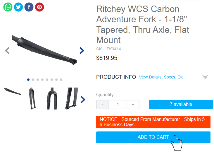

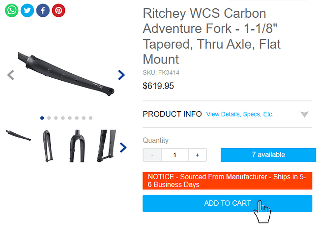

didn’t realize the Soma DCs ever took a tapered fork, I thought they were all straight 1 1/8. Might be a no-go

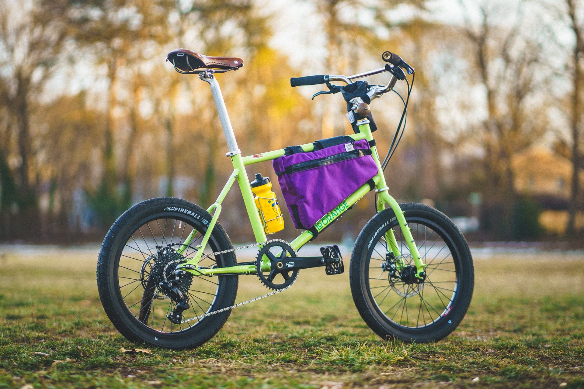

Packed up my neutrino for a 2.5 week trip in Asia. TW, JP, KR. I’ll be packing and unpacking this thing 6 times.

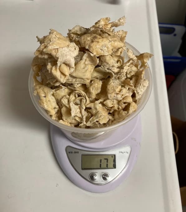

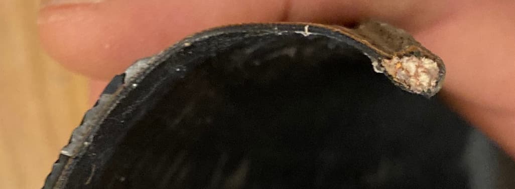

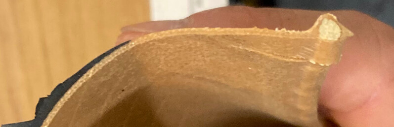

Pulled most of the old sealant out of an old MTB tire, I think this is about a quart of Stans and a quart of Truckerco, maybe +60ml Stan’s Race.
Tire also absorbed ~100g+ of glycol (?) from the sealant that did not weep out or evaporate over the several months it sat outside on a covered balcony.

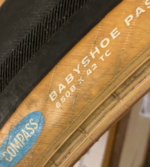

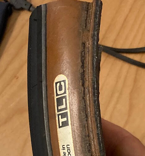

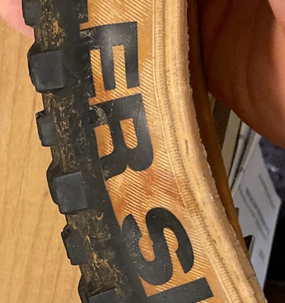

is sidewall weep more common in gumwalls?

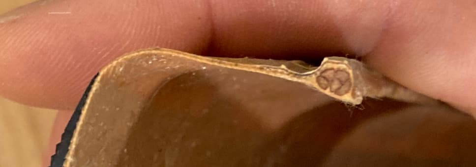

An actual gumwall type, like this old GravelKing, no. You can see the outer sealing layer over the casing rubber. Seeping can happen but it’s most likely due to non-structural damage to the casing that stains the outer rubber and eventually seeps through.
A skinwall, like these two tires, a very old WTB Prowler and Compass BSP, yes. The sealant only has to go through 2-3 layers instead of 4-6.
Old dudes on IBOB have been turning their skinwalls into gumwalls with carpet adhesive and other methods to extend their life for many years. I tried it with sealant myself and it worked for a bit but it really takes a lot of make a new layer on the sidewall.
