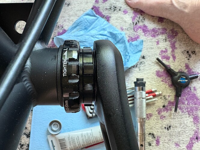

Something seems amiss there. My Jones with the stock crank/BB/0mm offset ring from the complete bike measures around 53-54mm for chainline.
Not to be a downer, but also check the spoke tension on the front wheel. Mine was uneven enough that it made noise until I retensioned it.
Will do—thanks. Makes me wonder if the cranks weren’t torqued down. Guess it’s time to check everything.
What cranks. Could be some spacer fuckery. Nevermind. Some Jones OEM jawns. I bet it’s either spacers in the wrong spot or just not tight.
Damn why even buy a jones if Mystery Jeff isn’t gonna do a once-over on your bike himself and make sure your rotors are gigantic. And then call you at 11pm.
I’ve talked to Jeff when I was considering a Jones. Why not call?
Both arms are torqued down according to spec.
Each side has one spacer (assuming 2.5mm since shell is 68mm).
I’ll give Jones a call tomorrow.
Can you flip the chainring?
It’s zero offset.
Re-measured chainline and got 55mm.
is that spacer behind the DS BB cup necessary? removing that would get you into acceptable 1x boost chainline territory. Or, buy a 3mm offset ring.
Yeah, I’m thinking of moving the spacer to the NDS side (or getting a -3mm chainring).
Pretty sure you don’t need spacers on both sides of the BB right?
Did your bike come one spacer on each side of the BB shell?
Yep, that BB looks like mine.
I’ll take the chain off and double double check that measurement tonight. Mine won’t be exact exact since it has the EBB shell so there will be a slight difference if that is slightly off to one side or the other (but it didn’t look obviously misaligned last night).
Really appreciate it—thanks.
That’s a chainline for a 157 mm hub. Looking at the specs on Jones’ site, you might have a 148 mm hub? That would need a 53 mm chainline, typically.
Yeah, mine is 148. I’m going to either move the spacers around or pick up an offset chainring.
Mine measures 54.0mm to the tip of a narrow tooth (31.95 ST diameter, ~38.08 ST to tooth).
