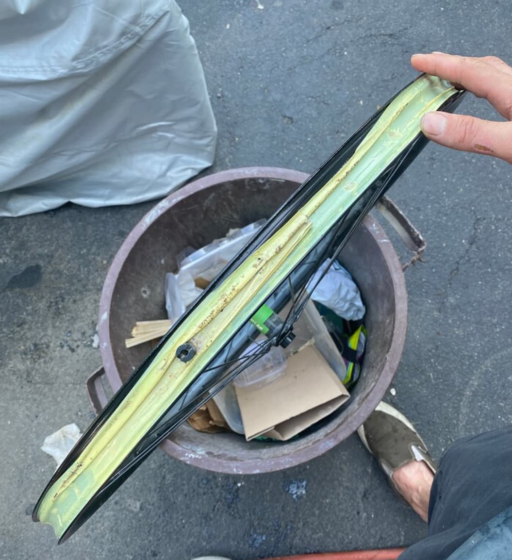

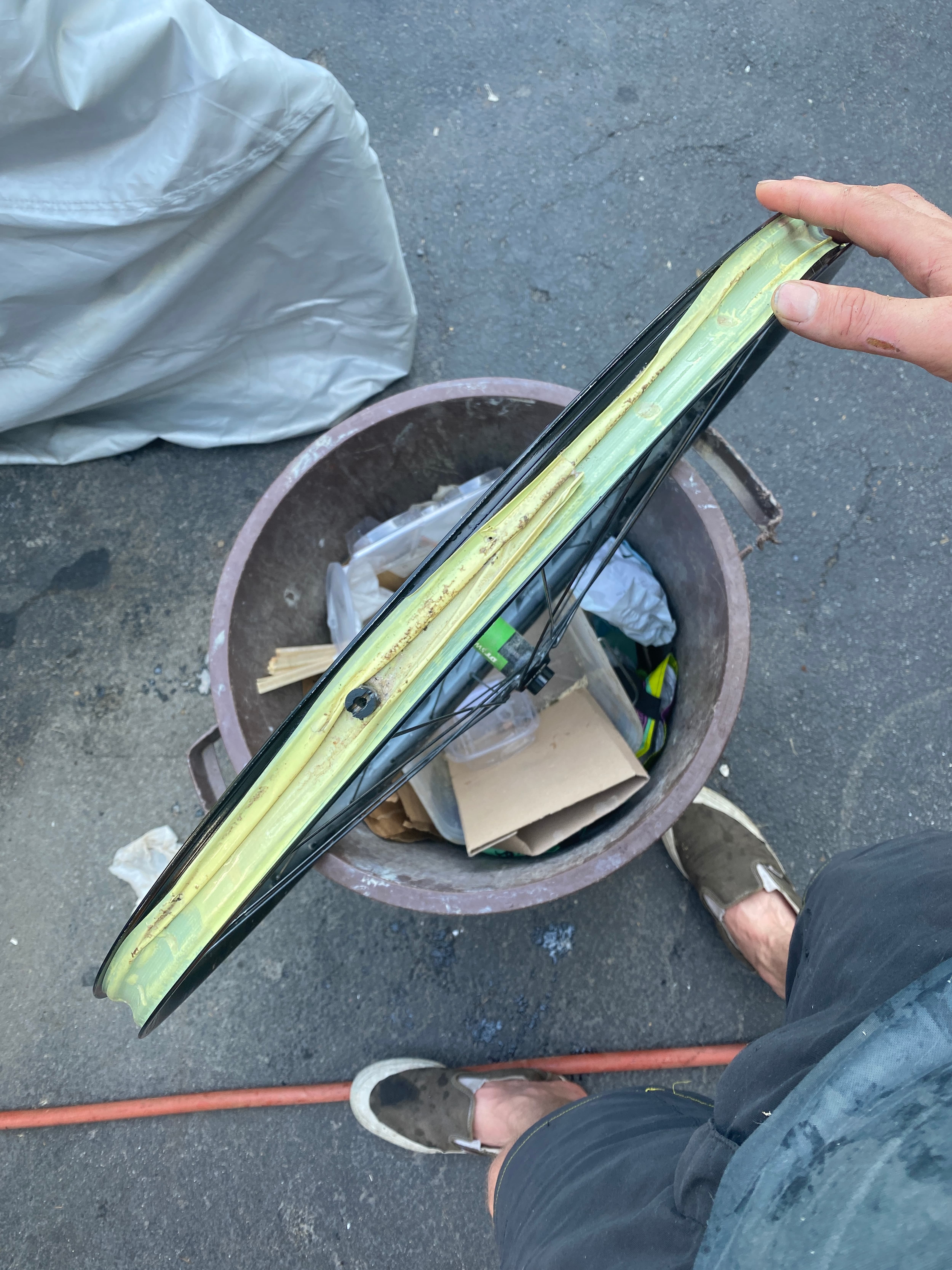

Is that an eggplant

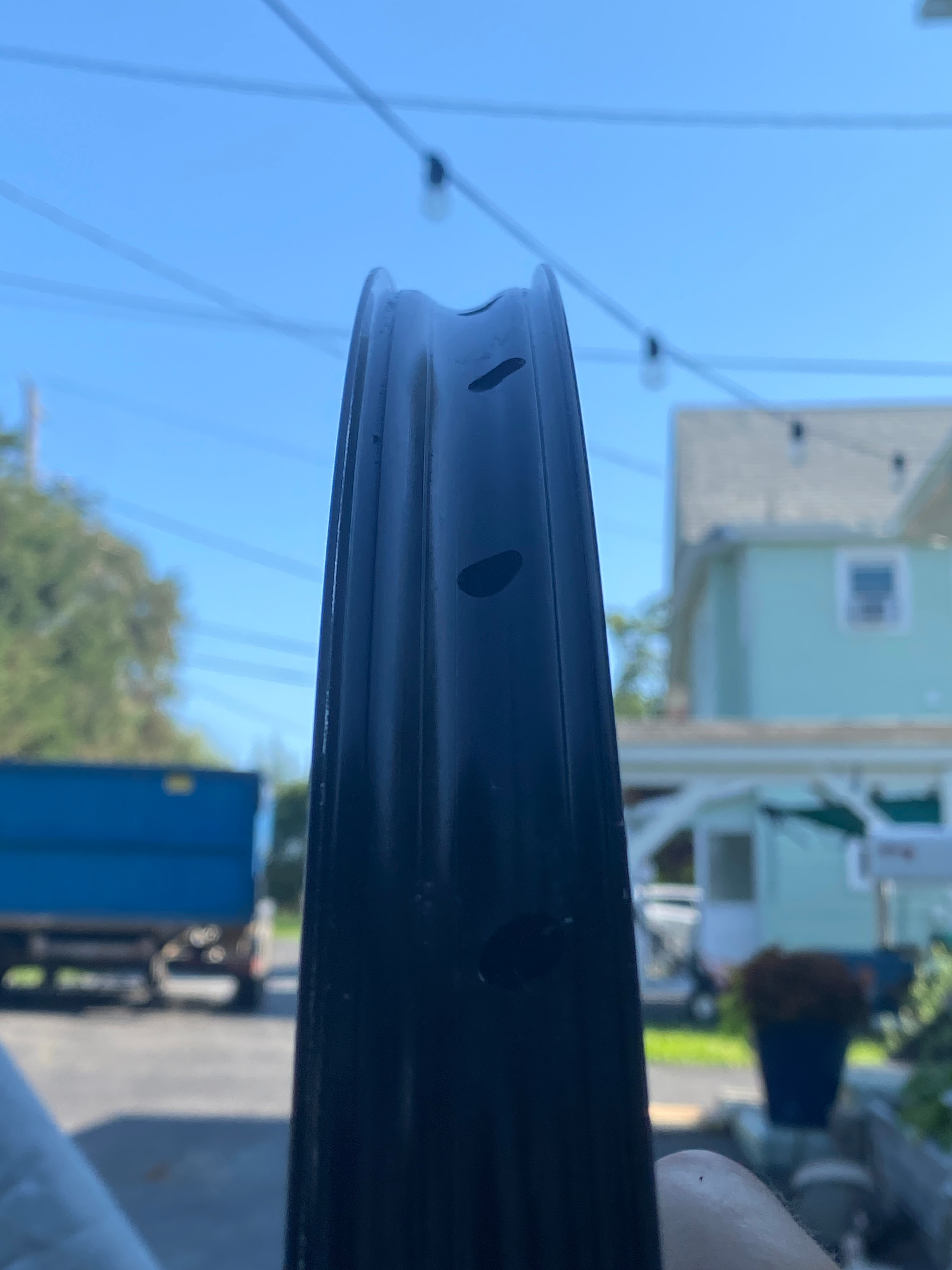

Shop seems to like the Terevail tape. Really shows how good of a stock tot he rim you have (and sticks way better than stans or that strapping tape).
are you guys talking about my dong?
Iâve been enjoying the DT Swiss style tape over the past year. Teravail looks like a better value?
Also: brake cleaner for getting thick oem tape glue chunks off. So good.
Just spray it on a rag and wipe it off?
Is it safe for carbon rims?
Does this mean I have to go to an auto supply store?
I assume that you can order it off amazon. Google says not good for carbon fiber.
Apparently acetone is OK: https://ffwdusa.com/wp-content/uploads/2015/10/FFWD-Wheels-Carbon-Wheel-Maintenance.pdf
I bet it does as good of a job. I was looking for acetone on my death chemicals shelf when I thought to yolo with brake cleaner.
I like the DT rim tape more, but I am still working through my roll of Tessa. Changing the tape every two or three seasons isnât bad.
