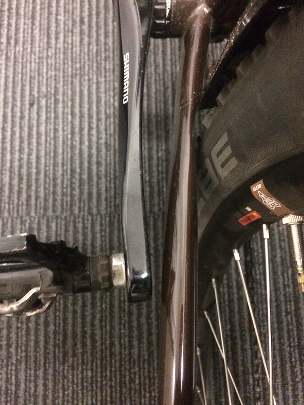

If the CX50 have a Q-Factor of 150mm and this is the amount of clearance between the crank arms and the stays of the H/G:
How do the OX901D’s compare with a Q-Factor of 145mm?
You should be able to measure with a ruler or digital caliper the distance between the inside of the crank arm and the stays.
150-145= 5mm so the cranks will be 2.5mm closer on each side.
Also note the location of the chain in the smallest cog & largest chainring relative to the inside of the driveside crank arm.
Shouldn’t be a problem on most cranks but I once had a problem with the crank arm hitting the chain but clearing the chainstay.

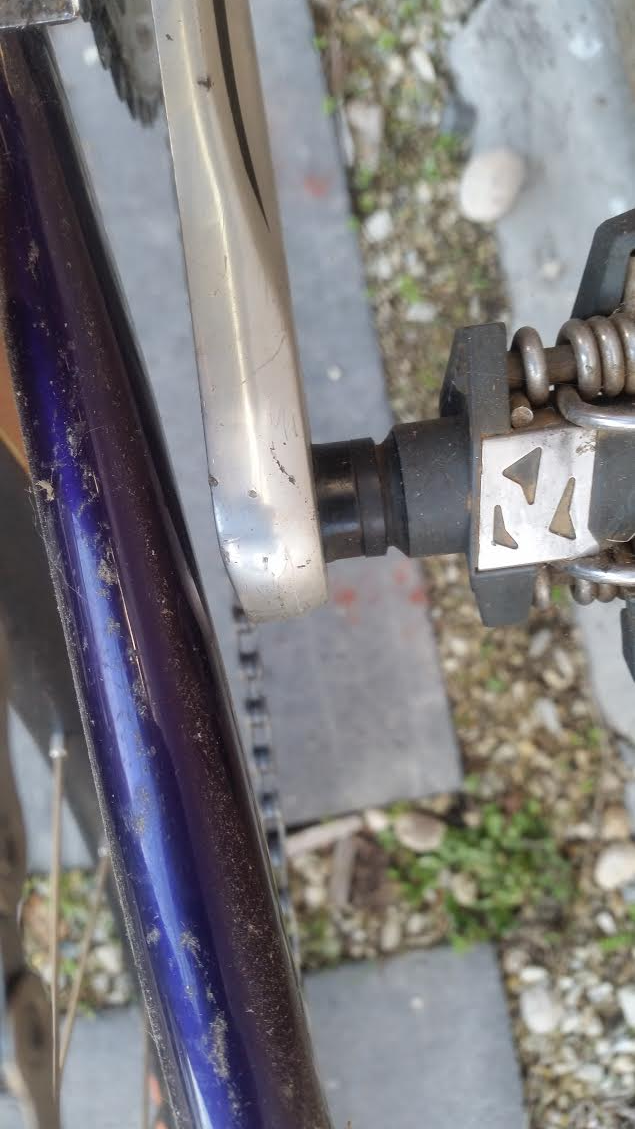

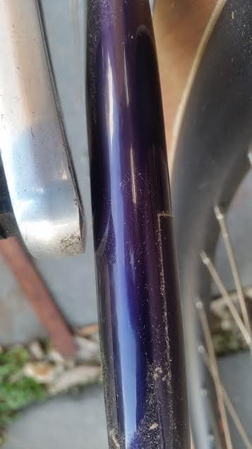

[quote=EddBread]If the CX50 have a Q-Factor of 150mm and this is the amount of clearance between the crank arms and the stays of the H/G:
How do the OX901D’s compare with a Q-Factor of 145mm?[/quote]
These are older OX901s with a DA9000 BB, and a V1 H/G, varies between 2-3mm clearance:

[quote=Blakey][quote=EddBread]If the CX50 have a Q-Factor of 150mm and this is the amount of clearance between the crank arms and the stays of the H/G:
[/quote]
That’s really close :open_mouth:

Regarding hungergatherer chat and nerdcranks:
When I built mine with the dura-ace BB and ox601d cranks, my DS crankarm hit the stay under MAX POWAH.
I put a 1mm spacer on the DS bottom bracket and there is no longer any interference.
It’s close, but it doesn’t hit.
Also, to be fair, I have 2 other bikes that have this same amount of clearance as pictured, none of them hit.
