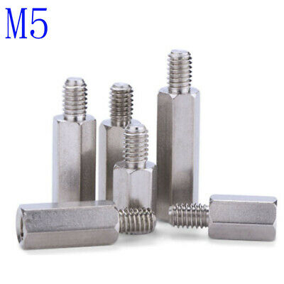

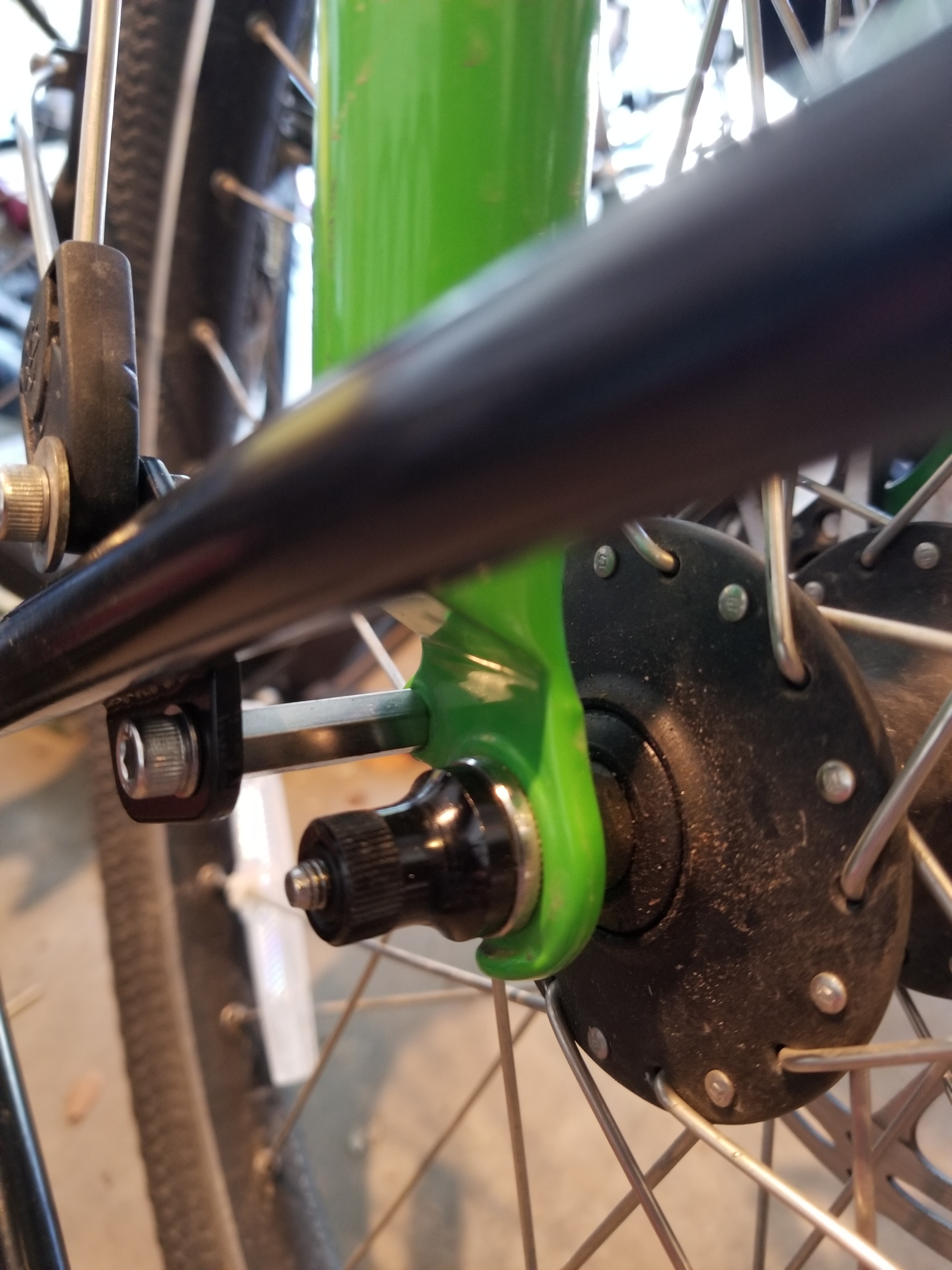

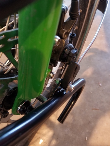

Dunno if this is the right place but I sorta found a solution to the low rider problem that might be broadly applicable. I found these things on ebay:
And in the 25mm length they hooked up my tara and fenders like this:
It’s definitely a wide stance and I suspect it’s not as strong but everything clears!
This kinda scares me compared to a single long bolt with a tube spacer, but that’s probably unfounded
No I agree, it’s not ideal. Know it all works together I may end up looking up long bolt and spacer. I’m not planning on putting much weight on it in any case.
What would make a bolt + spacer better is that you could use a stronger bolt and a larger diameter spacer for more support. But it’s pretty good as shown.
I’d trust that setup.

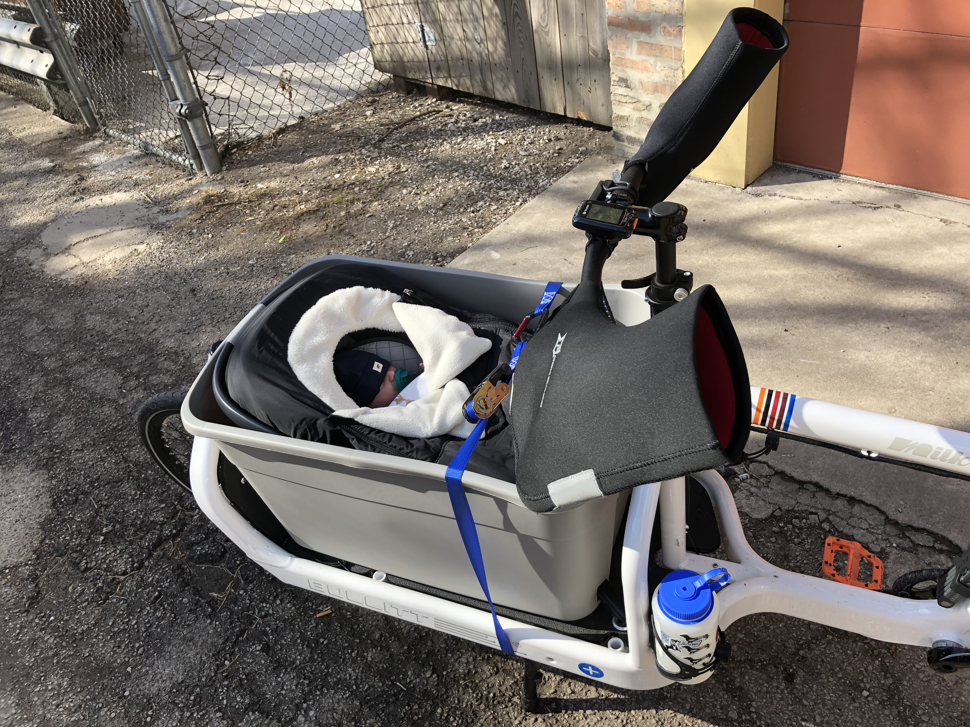

We did the thing!
Ash told me to get a safety flag if I was gonna be riding around with little Ro.
Bike Flag
