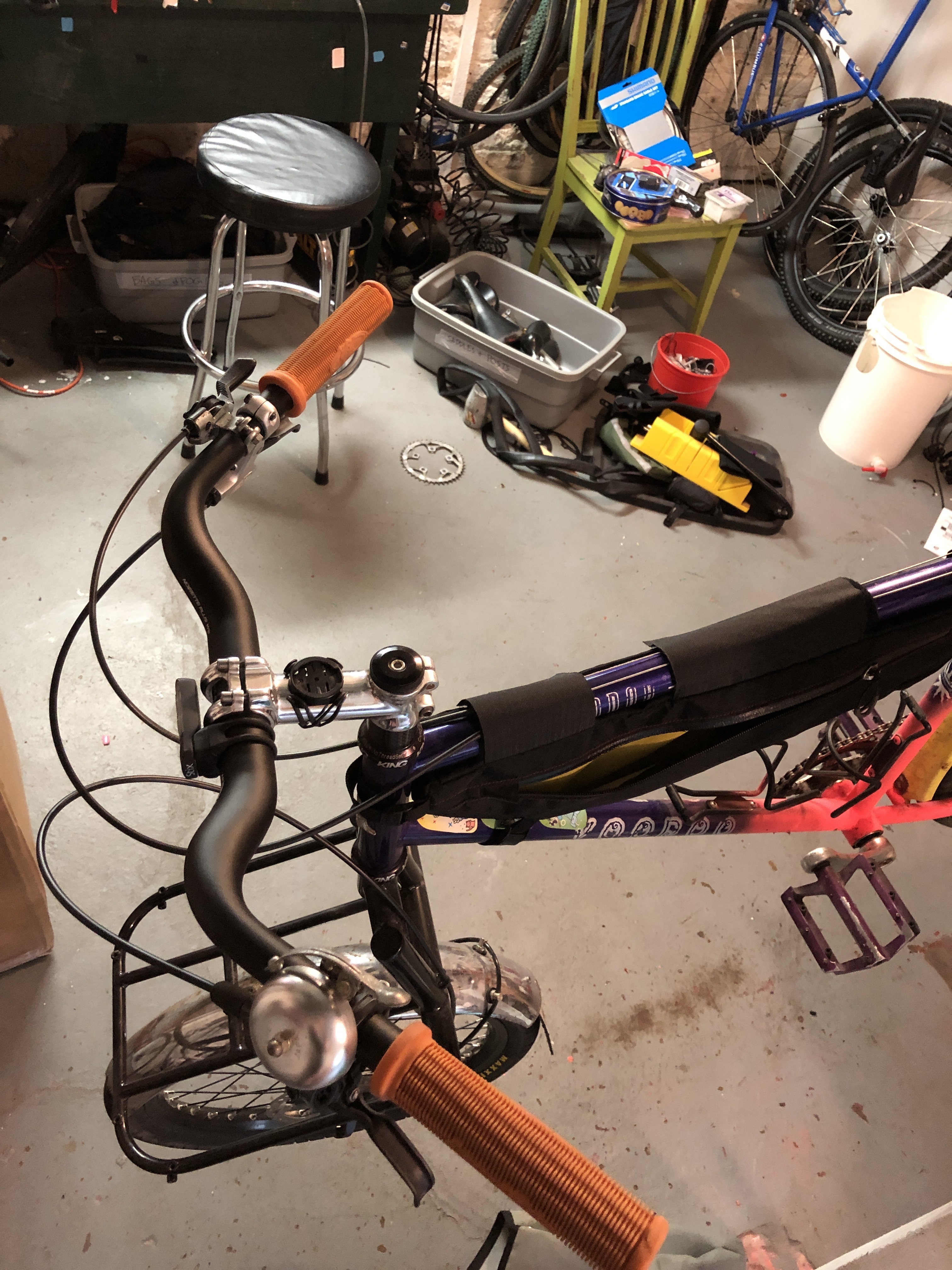

I would have put on some fun color grips, but this tape was all I had. Might get some keirin grips at some point.

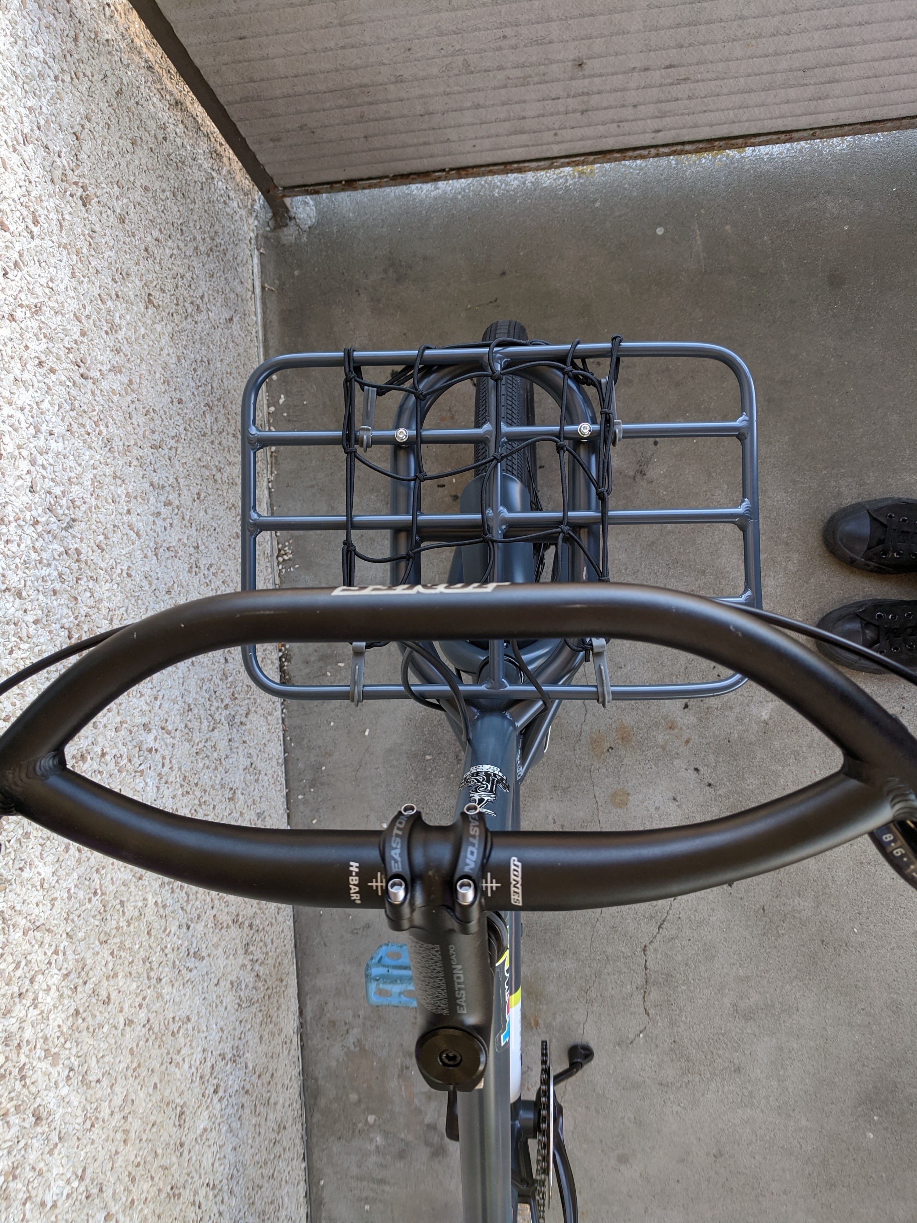

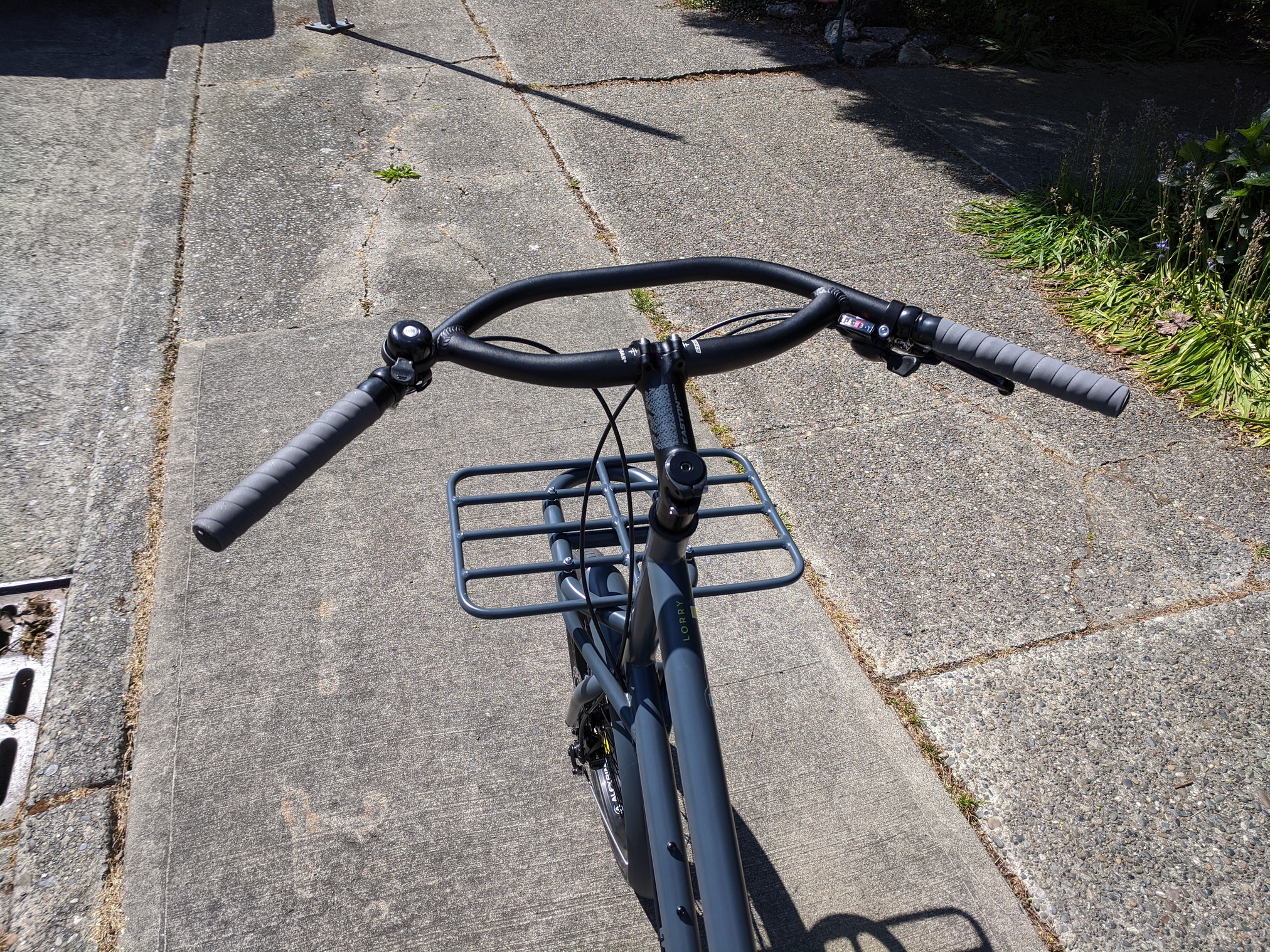

Nah that’s a Jones bar
How much does that bar overlap the platform?
This is more or less straight down
So, about a quarter of the rack. I see your point. I might look into some of those other wide, swept bars that don’t have the front bit.
I’m a big fan of the soma osprey, basically exactly a Jones bar with no loop
This is where that original Lorry with the bolt on rack would be nice, the platform was lower on that version. Maybe not as strong tho.
There’s still 36cm between the rack and the bars. I don’t intend to fully utilize the cargo capability of this bike so I’m not too worried.
