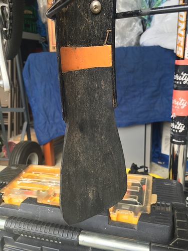

I drilled my first couple metal fenders and bolted rubber flaps on, but I tried something new on my current set.
At first I cut fenders out of a thin plastic cutting board and slipped the end into the underside of the fender, against the rolled edges. These both broke pretty easily as expected.
Then I did this:
Used a small section the cutting board material as the snap in piece and glued some thicker rubber material to that. Plastic snaps into/out of place, no drilling necessary, and looks pretty slick atmo

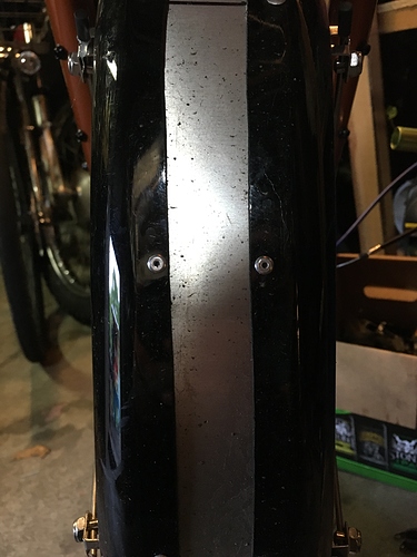

This reminds me that wife’s blackborow needs a flap because those wide tires throw a roost. I like pop rivets but if you don’t have the gun and a rivets on hand zip ties are a definite second.
closeup of the widened fenders on the blackborow. The 5052 aluminum was perfect for this application easy to bend, more ridged than the plastic. It’d be a good material to beef up a plastic fender riveting a strip down the middleWith steel Berthoud fenders, I was able to pry open the rolled edge a smidge and fit the rubber stair tread under. For aluminum, your plastic cutting board trick is really clever!
My plan was to use the single fender stay screw on the fender, then probably drill two smaller holes down lower to help hold the shape. Shoe goo might work as well. Need to buy more stair tread material first.
I’ve been able to slip vinyl stair tread into to the rolled edges on Berthoud fenders without doing anything to the fender. Front flap is attached using the same hardware as the stay, and just barely enough threads on the screws to make that happen. Tiny flap on the rear fender is just stuffed in the edges, as an experiment. It hasn’t moved at all, so far.
For plastic or aluminum fenders with a separate flexy flap, I usually just zip tie through the flap part and don’t touch the fender at all.
