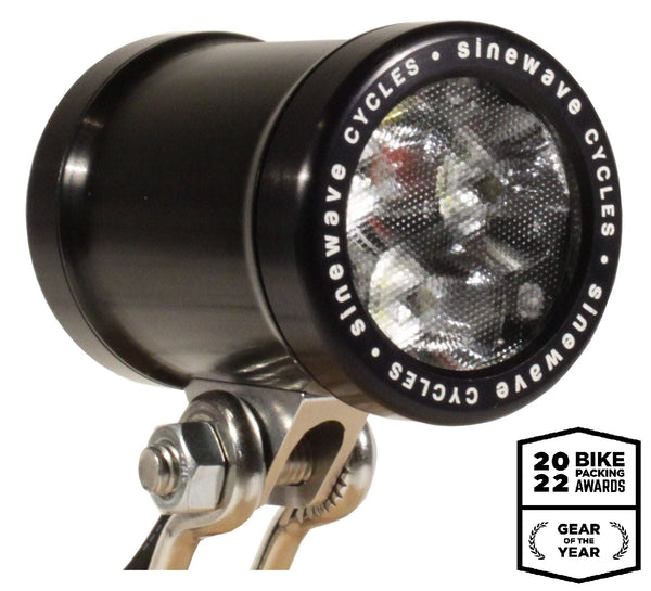

$400 dynamo light
that mostly exists to match Klampers, if you have real brakes it might not be for you
it’s claimed to be somewhat less garbage now:
powering it from a USB battery is a little cool, but seems overcomplicated with two different cables between the two — and if you’re actually going that slow for any length of time, a helmet-mounted light is way better
