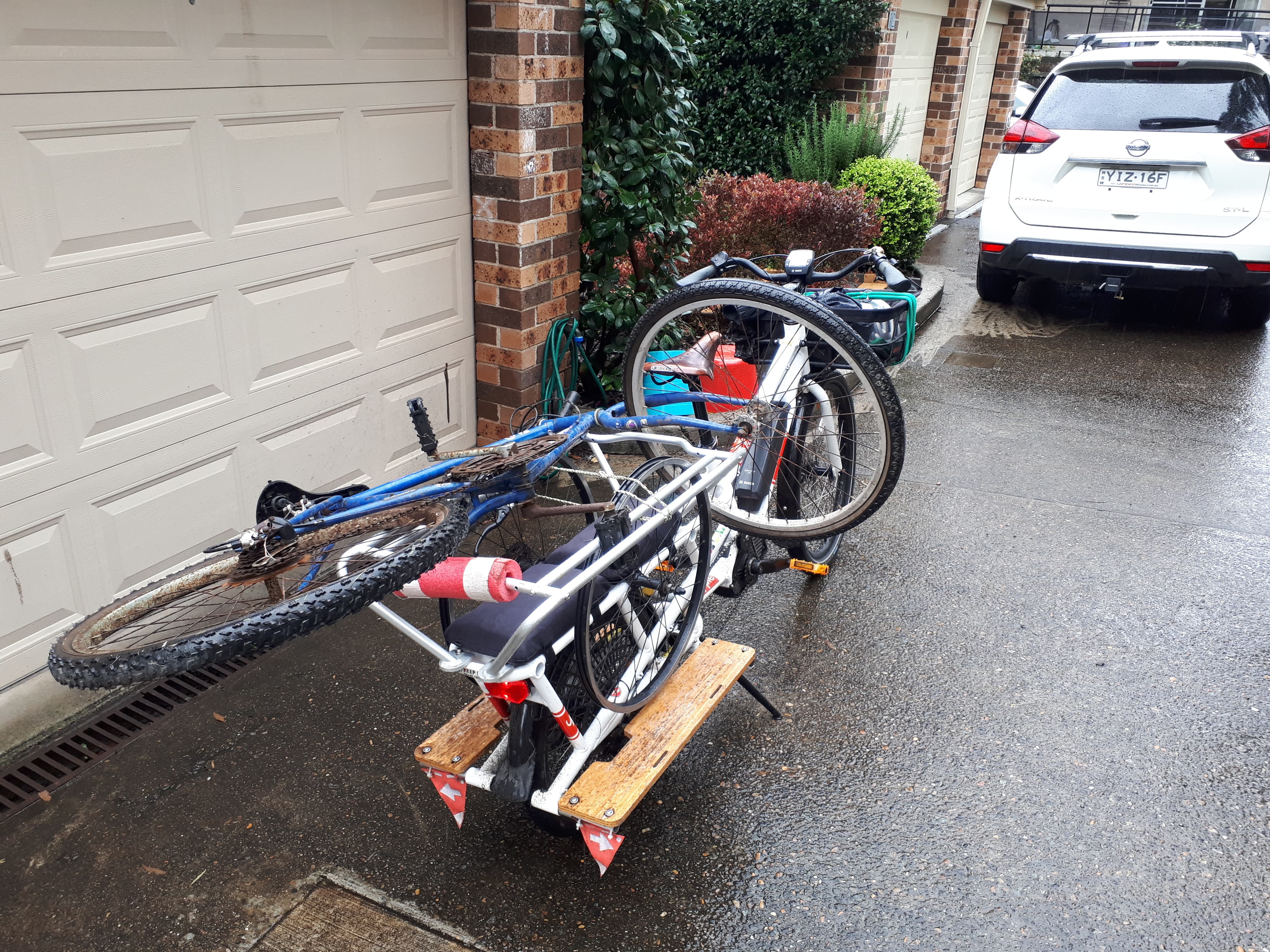

Heading back from the LBS and found a gaspipe MTB that will fit my 2-speed coaster brake wheelset. Just threw it on top of the Yuba and that was that.
